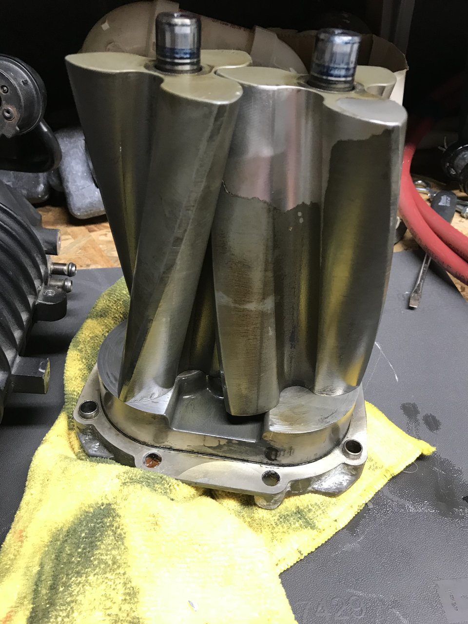

    Just installed my Supercharger 4th gen on 2004 Tacoma. It makes a clanking noise when idling and at load though to a lesser extent. Sounds like the rotors are hitting against each other. When in boost it sounds like metal to metal contact (ping??) looking at sending into Jon Bond or Highspeedlab. I already installed a new TRD nose cone, so hopefully not a full rebuild needed. I could do the do it yourself rebuild, but do need the rotors coated. Would I be good replacing the rotor pack and rear needle bearings or do I need to worry about the internal casing?

    I think you mean 2nd gen SC - black one right? Man I hope the rotors aren't impinging on each other, that would be bad news. Sounds like you have a pretty good handle on disassembling it, you could take the nose cone and front plate off and check for rotor movement/play in the bearings. I recall @1997tacomav6 had a place that would recoat the rotors correctly, it wasn't cheap though.

    When I had the rotor pack out it definitely had some play to where you could clank them together. I was foolish thinking the rear bearings would hold them apart.

    The rotors have to be timmed, that might be your issue, don't run it till it's fixed, you don't want
    metal in your engine, call Wayne at highspeedlab and he can fix or help you decide, tell him the
    500,000 trd supercharger guy recommended you, he will laugh, I have the record for miles on a TRD supercharger that he has worked on.

    Looks like I’ll be trailering it Home this weekend then appreciate the advice.

    Yea, you could loss the engine if metal chips got sucked into the engine. Personally I just bit the bullet for 1000.00 and have it rebuilt every 150,000 miles and don't have to worry about this type stuff

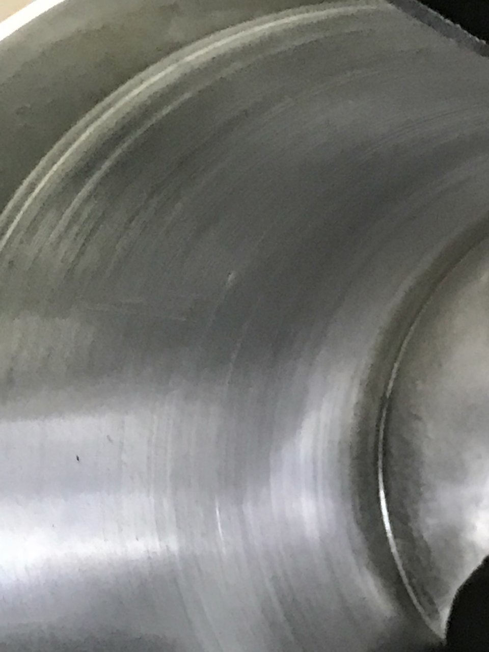

    Trailered it Home today and removed the Supercharger. Everything inside looked ok, some minor scoring inside the Supercharger. The rotor pack is a mess. Spoke with the highspeedlab folks today, very nice and asked me some questions and tried to troubleshoot before having me waste money sending it in.
    Here’s a video of the rotor pack
