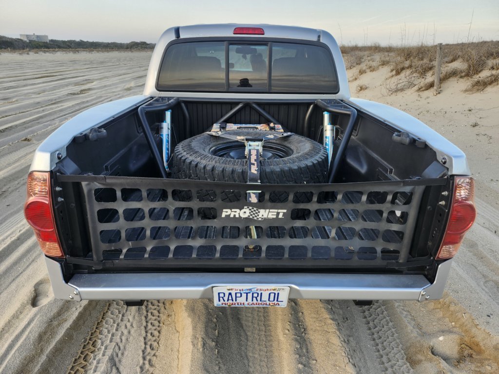

    Go procharger if you want more than 300 reliable hp.
