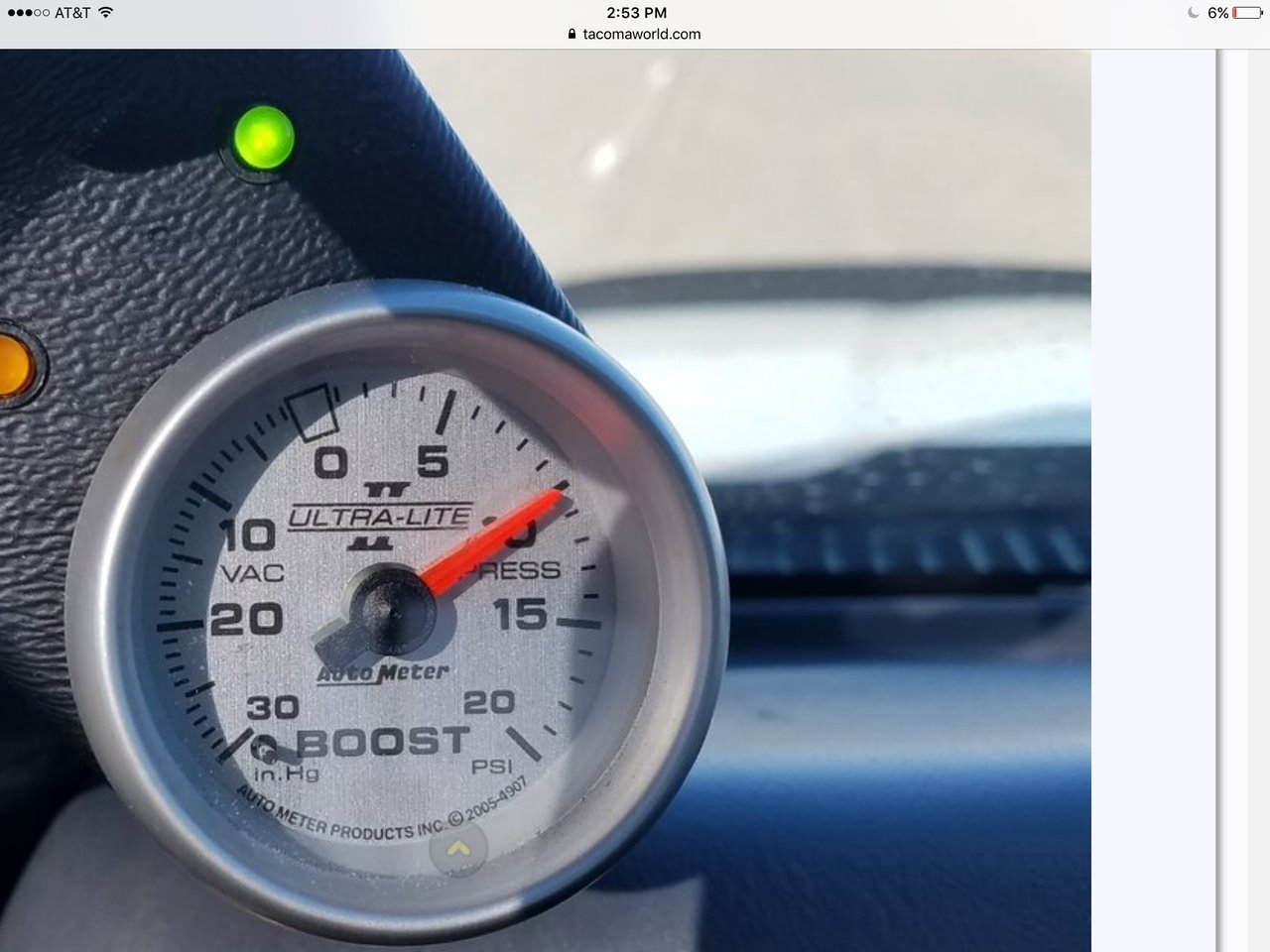

    Nozzle position and size yes. I’m boosting 6-7 pounds with no signs of pinging or concern... just acquired the truck. I own Black Canyon Performance in Wheat Ridge, so am knowledgeable about W/M systems to an extent!
