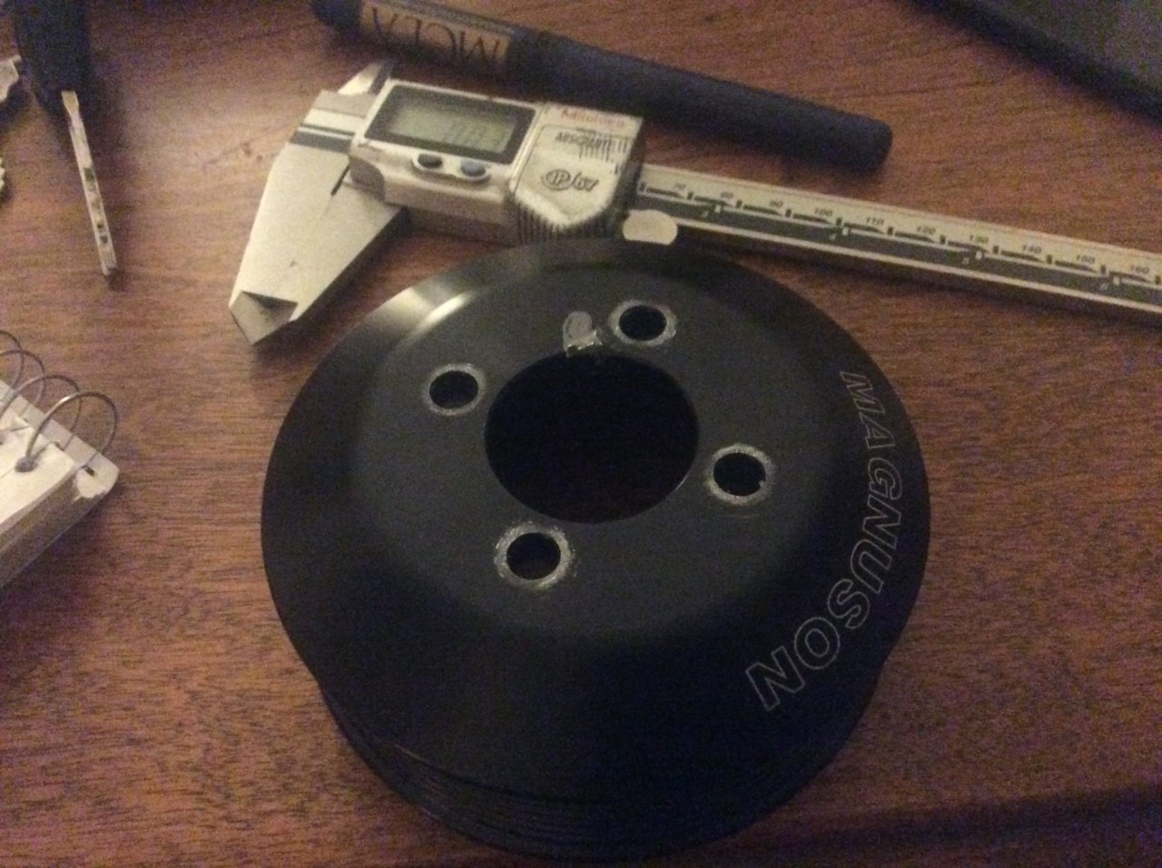

    The pulleys supplied by Magnuson are 5.5" for the crank and a whoppingly huge 3.5" for the SC. Drive ratio is about 1 - 1.57. My bet right now.... this thing is not turning fast enough to create nearly enough boost to have any fun. We'll all be pulley swap'n shortly, and Magnuson won't have to warranty anything.

    Magnuson has applied a small dab of gray paint/sealant on the stock 90mm pulley and mounting boss. Remove pulley, break the seal, NO WARRANTY FOR YOU!

    Smaller pulleys are readily available right from Magnuson. They have 7 steps below the stock 90mm, all the way down to 66mm. If my math is correct, it looks as though 72mm will be the smallest that will fit the snout without machining... unless the the smallest pulley has a thinner wall machined?.... We still need to find stock boost levels, then we can determine how much smaller the fuel system will handle... of course with fuel upgrades and tune, who knows?
