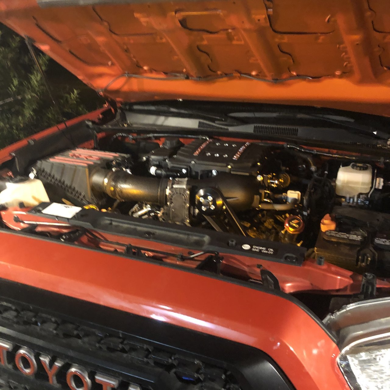

    I just finished the install process tonight. I just have to go buy some coolant tomorrow as I didn’t have enough on hand. It took me 2hrs yesterday and 5.5 hours today for full install. By the time I flash the tune and check for leaks it will be a 8.5hr project. I could have easily knocked it out in one Saturday.
    The kit is absolutely fantastic. The engineering and time that went into it is evident.
    I’ll report back when I fire it up tomorrow after work.
