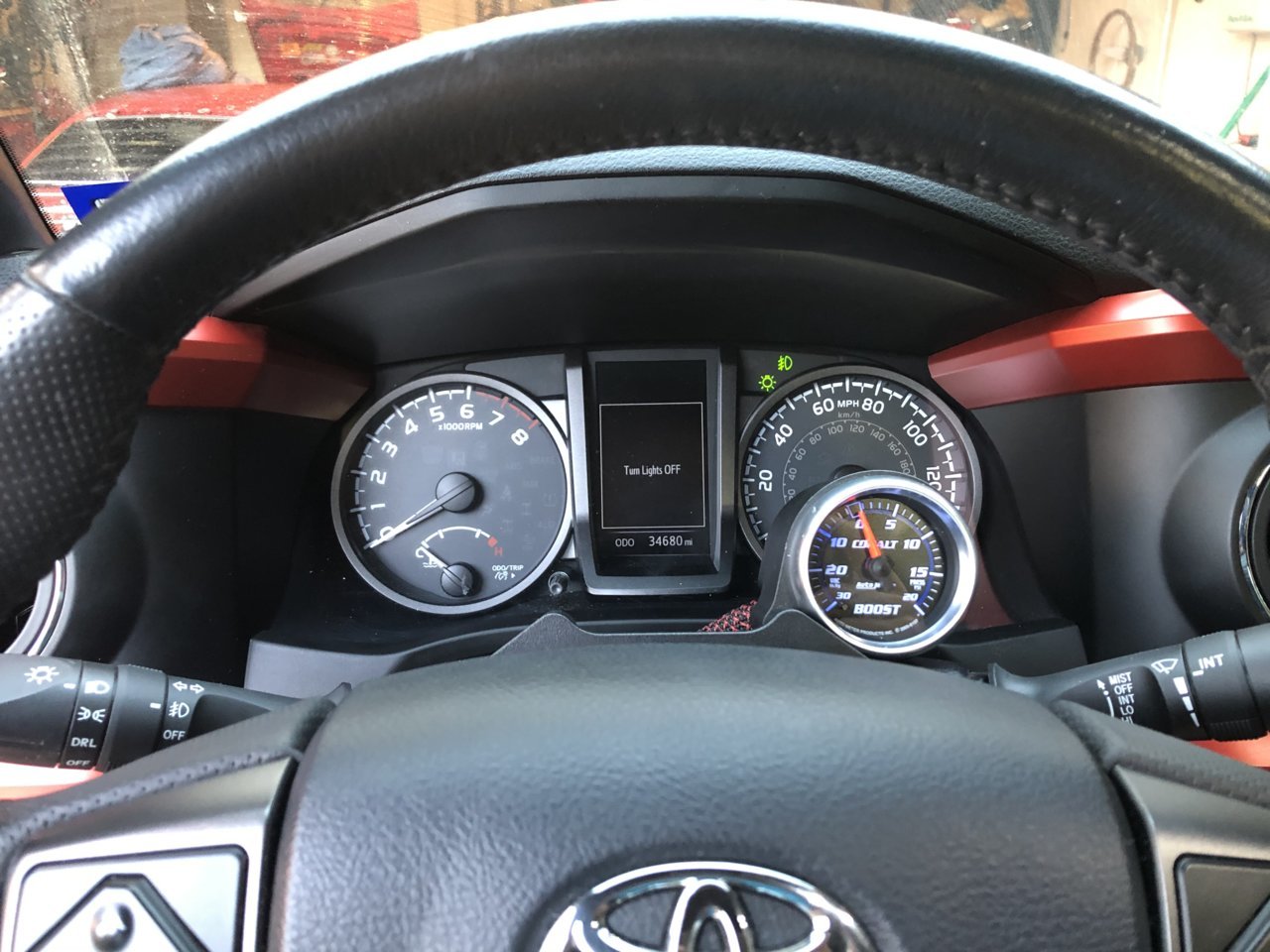

    Yes, install the boost connection before installing the manifold. I didn’t have time to install the gauge so I just capped it. I finally got around to installing my gauge tonight.

    How did the gauge mount work out?

    Actually, I haven’t used the vent mount yet. I’m planning to put my oil pressure gauge in the vent mount. I’ll post some pics once I install it. Been having some lower back issues the past couple weeks so things have been moving slowly.

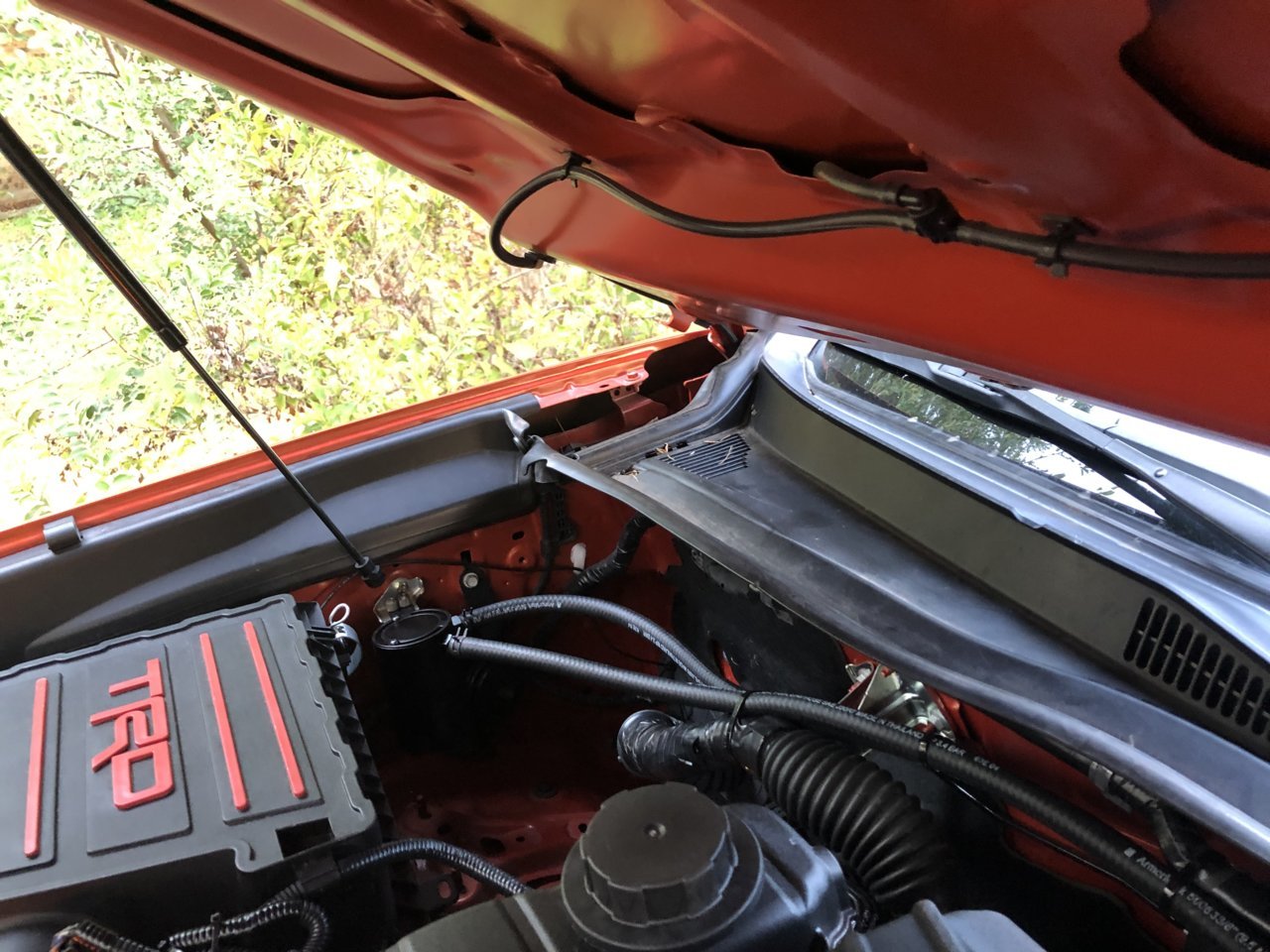

    I bent the bracket 90* and put it here.

  14. Oct 20, 2020 at 6:09 AM

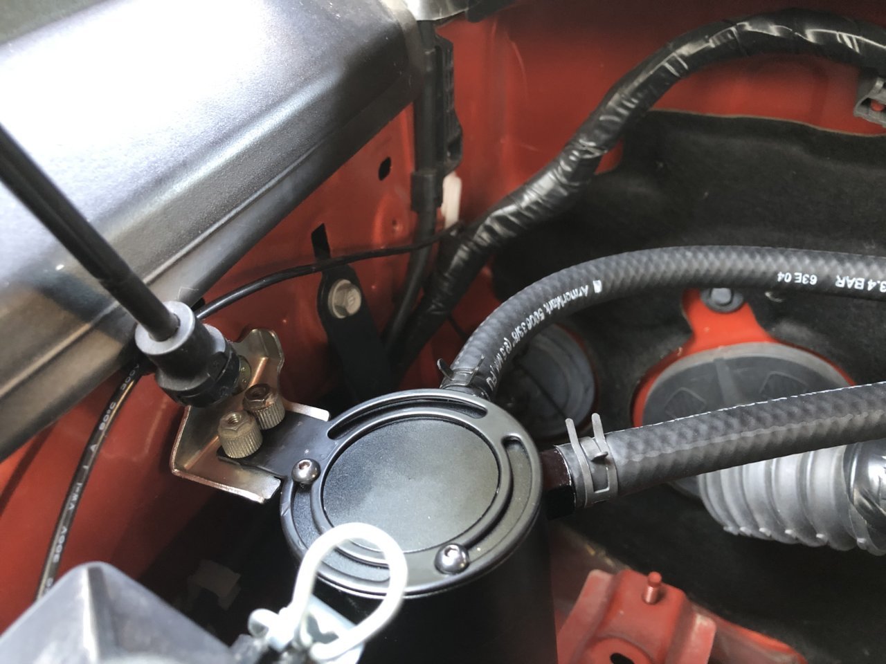

    I mounted mine (not a JLT though) here using an existing m6 bolt hole and a bracket that was removed from the engine during the SC install

    also it’s relatively simple to get the old boost plug out and install a 90° fitting to put your boost gauge on even if you don’t do it during install. You just have to remove the 3 bolts and 1 nut holding on the main wiring harness on and lift it out of the way a couple inches.
    I’m reading 7psi max and 2.5psi the instant I full throttle from idle with the brass restrictor removed.

    I like the placement of the oil separator, I have a 2nd battery in that spot so it doesn't work for me though.
    You removed the brass restrictor completely ? I opened mine up to 1/16" and it comes on much faster and at about 3/4 throttle.
    I'm only getting about 4psi of boost total though (at 6500ft ASL).
    How do you like the gauge mount ? I'm looking at Wideband O2 sensor setups, Innovate has a dual Wideband gauge but I'm having trouble finding an exhaust y pipe that tucks up and already has bungs in place for the sensors (I'm lazy and don't want to weld in my own).
