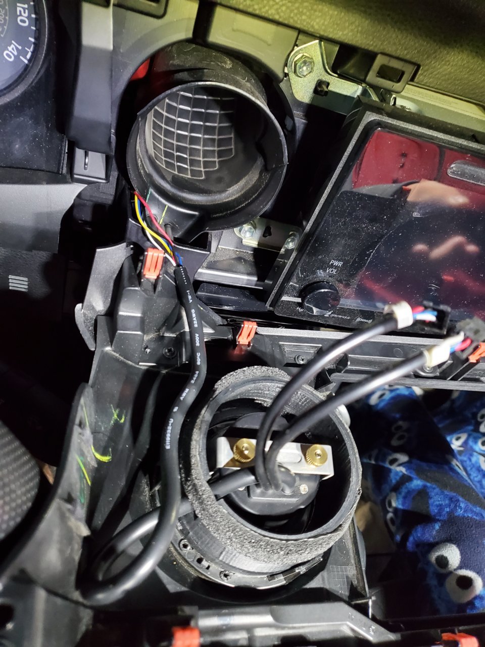

    @Bigetaco22
    @MESO has a different option he's working on, the Taco Pods

    I prefer the no nonsense design of yours. The MESO is very nice too though.
    I’m curious how do you route the boost line and wiring inside the AC duct? Do you drill a hole and use a grommet I guess?

    I have a cutout in the side to route cabling through. Then out and around the duct.

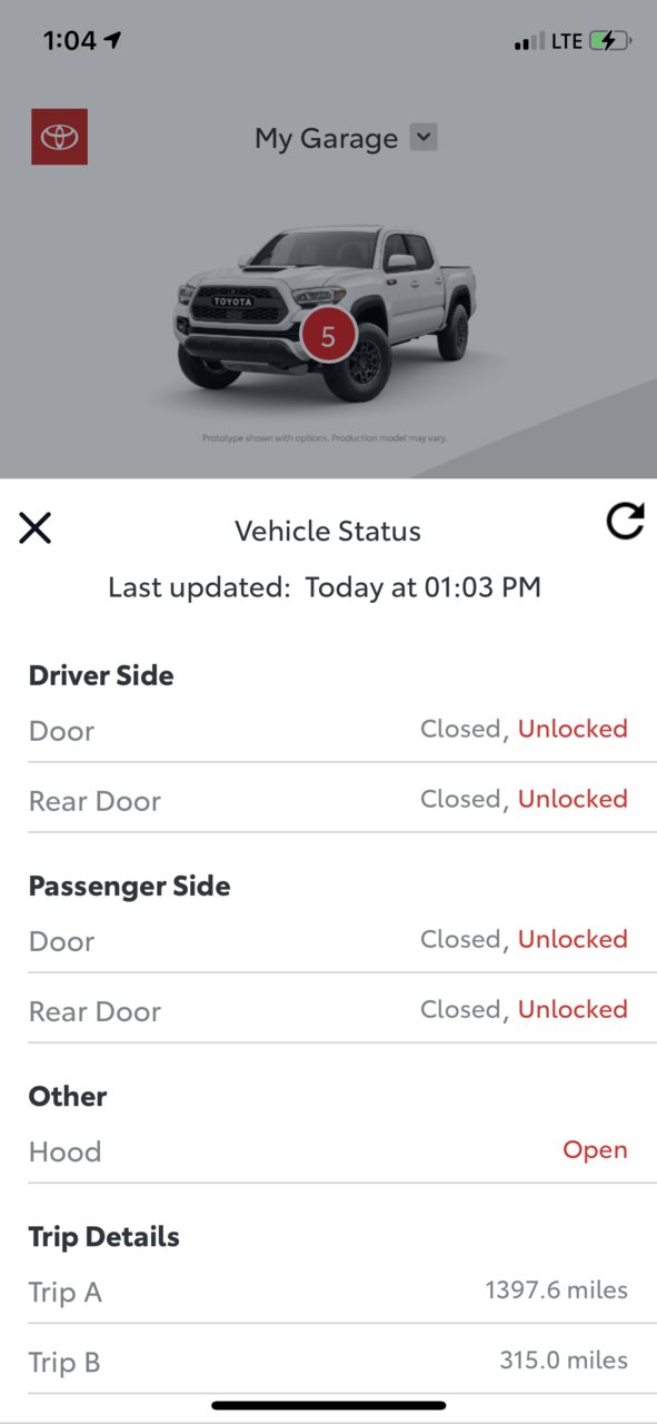

    One really nice thing about the app connected models is that you can easily check to see if a shop has begun working on your truck (as the hood is indicated to be open in the pic below). In my case, I dropped it off on Tuesday and it sat until Wednesday morning. This is perfectly reasonable because without the software from Magnuson they could have a completed vehicle sitting on a lift that can’t be started, keeping them from working on the next customer.
