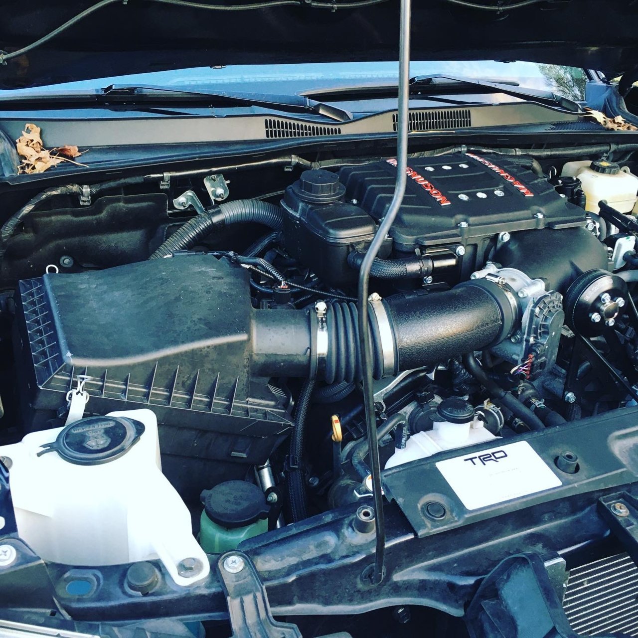

    Magnuson Supercharger TRD Bilstein 6112/5610 w/ Head Strong 3 leaf AAL URD Mark 2 Y Pipe OV Tuned (pre Magnuson install) TRD Intake TRD Exhaust TRD Skid Plate TRD Shift Knob Leer 100XR Subaru Kicker Tweeters Toyota Bed Mat Kicker CS Door Speakers Kicker H8S Hideaway Sub Toyota All Weather Floor Liners Caliraised LED Bumper Light Bar De Badged Tint Console Organizer CMC with BAMF Plates 17” SCS Ray 10’s 285/70r17 Ridge Grapplers Faux PRO Grille Hondo Radio Knobs Accumulator Delete Mod URD Short Throw Shifter JLT Oil Separator MESO Ultimate Turn Signals MESO Map Lights MESO V2 Dual Color Dome Light RC Seat Covers Stoptech Slotted Rotors Sport Pads and Stainless Brake Hoses
    Swapped out the stock airbox with the TRD one. I think it looks better.

  11. Nov 27, 2020 at 2:47 PM
    #491
    Taco_dak
    Taco_dak Active Member
    May 12, 2019
    #293089
    26
    Dakota
    2019 gray Tacoma trd
    Did you hear much of a difference?
    I think so. It is a larger top and I also removed the charcoal filter so I think it made an audible difference.

    Gotcha. Well it does looks better that's for sure. I was thinking about doing the same thing.
