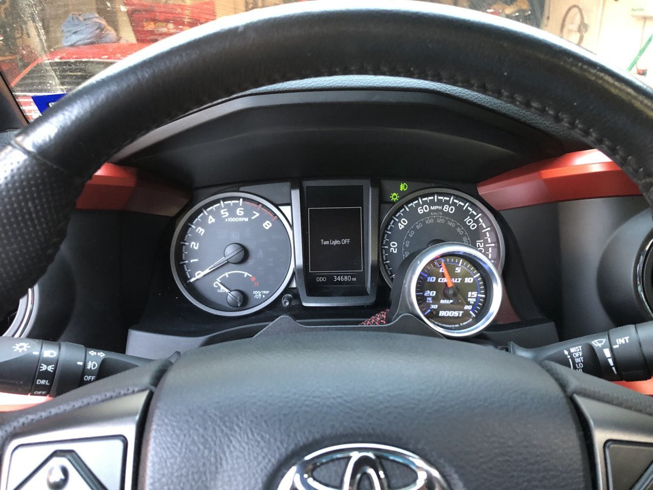

    Did you ever put a boost gauge on your truck?
  14. Mar 11, 2021 at 9:14 PM
    #554
    OpelGT
    OpelGT hOPELess Power
    May 6, 2018
    #252678
    558
    Texas
    2018 TRD OR Tacoma MT, Magnuson Supercharged

    17
    Magnuson Supercharger
    Do a install tutorial
  16. Mar 11, 2021 at 9:20 PM
    #556
    OpelGT
    May 6, 2018
    #252678
    558
    Texas
    Nah I’m good. It’s easy though. Put a 90° fitting into the port, then follow the instructions with your gauge. If you can install the supercharger, the boost gauge will be no problem.

    I'm sure you posted this already but,..... Do you have the part numbers for the 90* fitting, pod, and gauge you used?

    I don’t have it in front of me. But it is somewhere in that supercharger video review thread I made.
    gauge is a auto meter cobalt. I would recommend something else. The auto meter gauges are quite a bit longer than ANY other gauges. It will work though.

    How badly doesn't it block your view of the speedo? Is it about as much as it looks in the pic or better?
