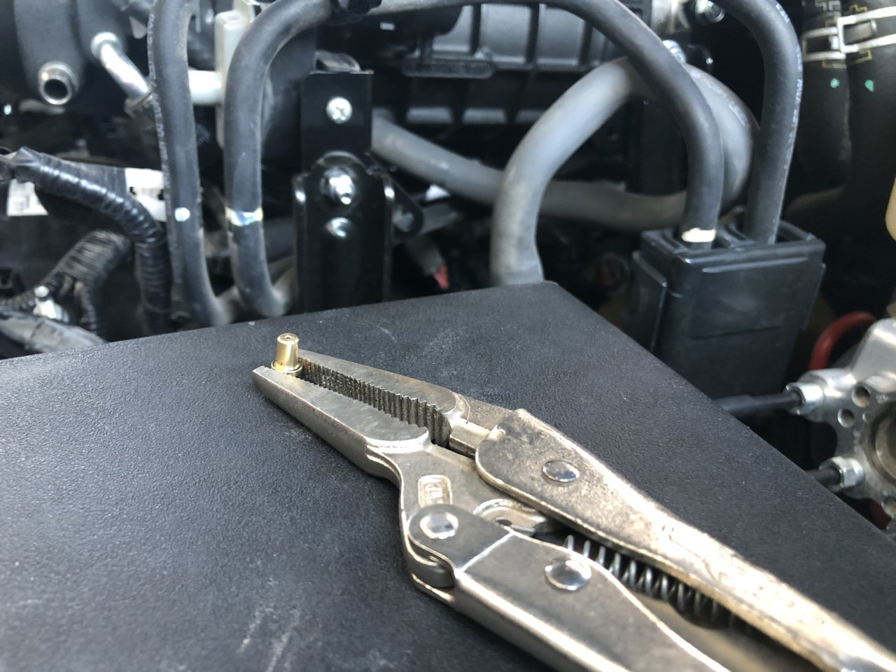

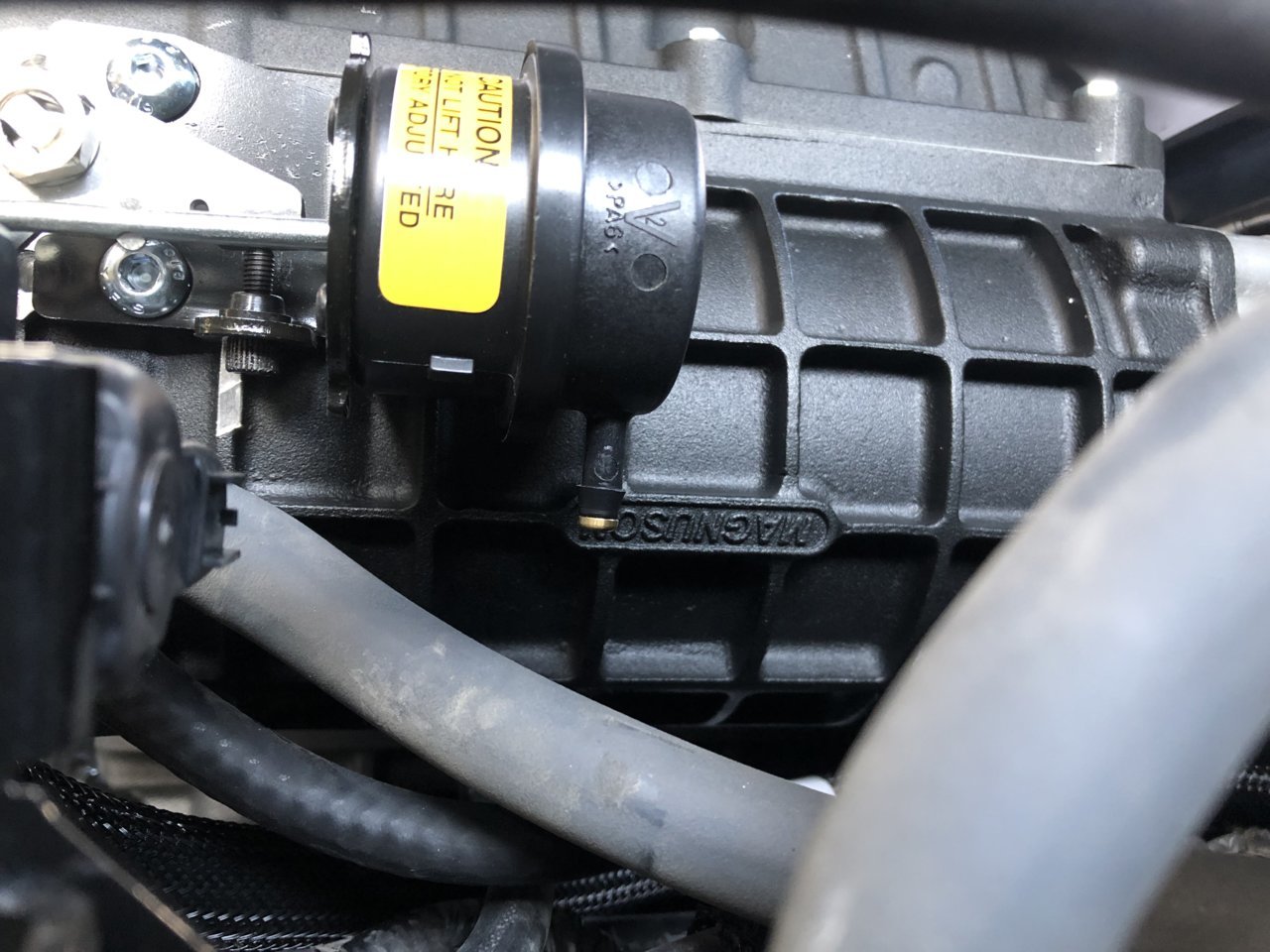

    How do you remove the restrictor?

    Formidable and Bascoma like this.

    With the restrictor pill/jet off, 1st and 2nd gear has a kick when it accelerates. Anyone else feel this? It's quite annoying and I want to put the jet back in.
