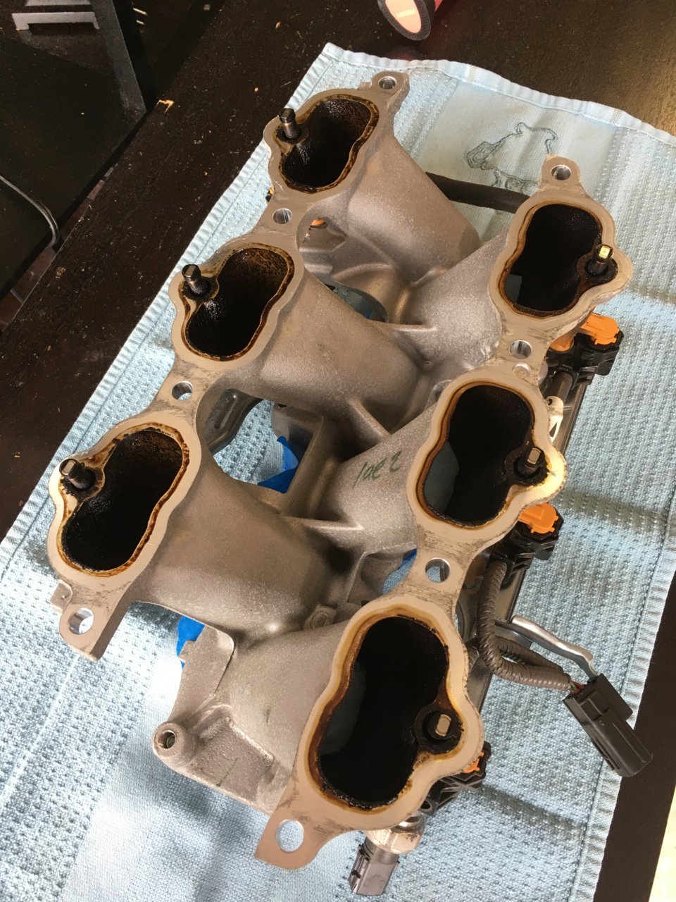

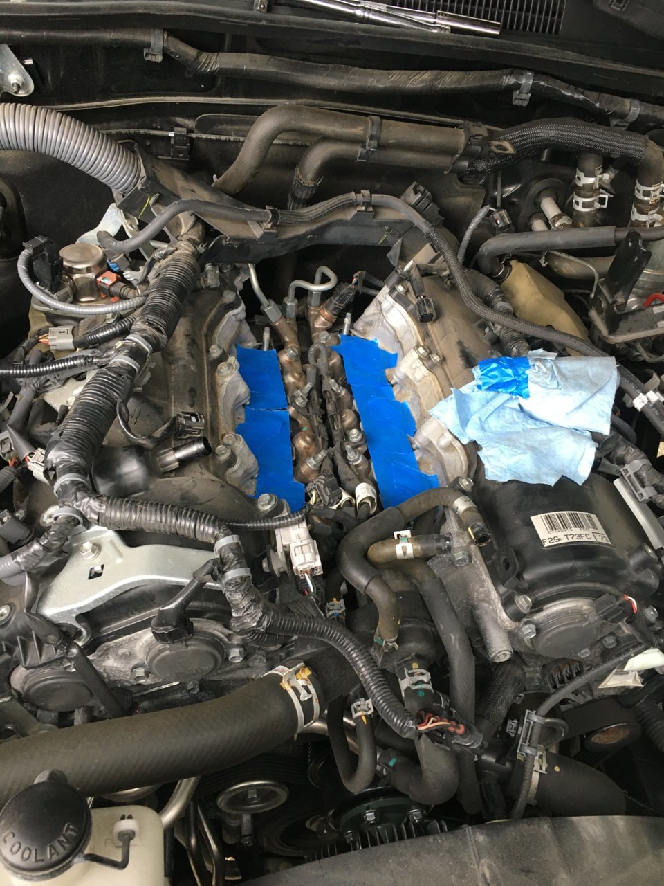

    Got my upper and lower intake manifolds off. Replaced the spark plugs while I’m at it. These intake runners are very full of sludge! Maybe I need a catch can.... or something.

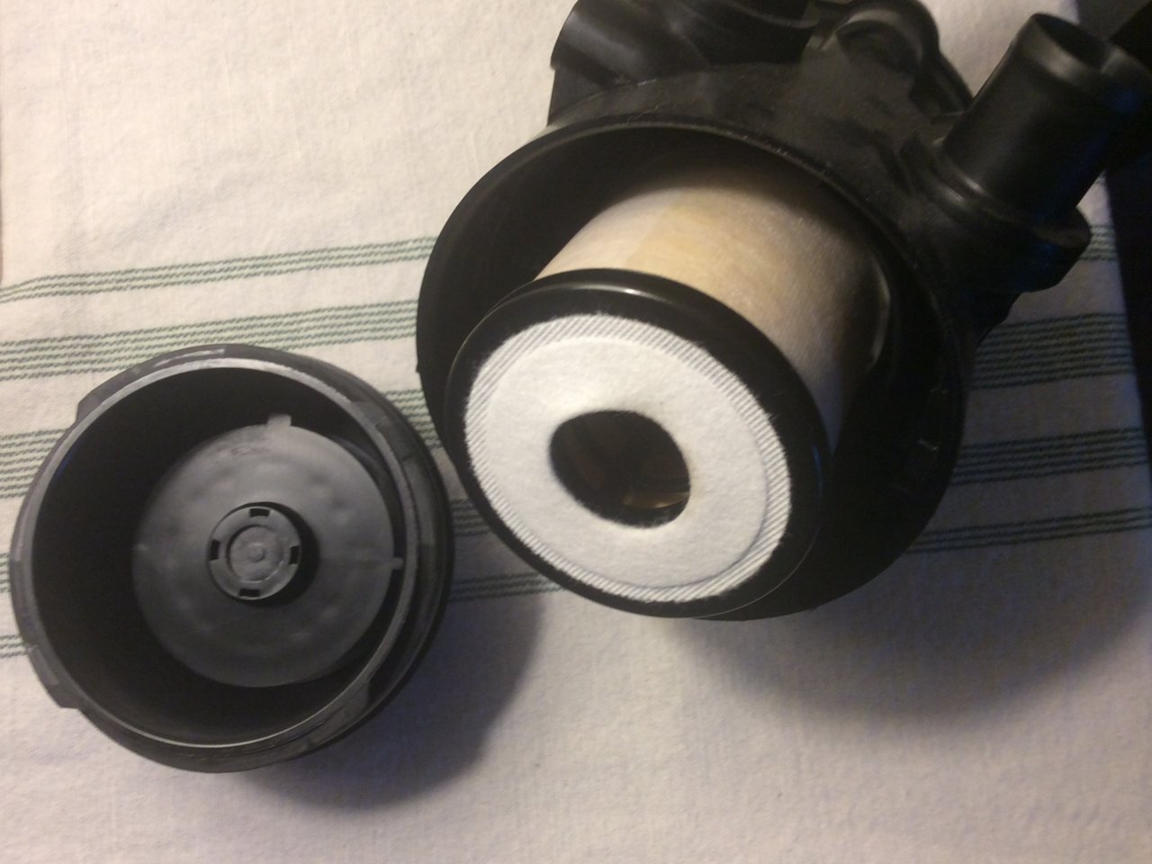

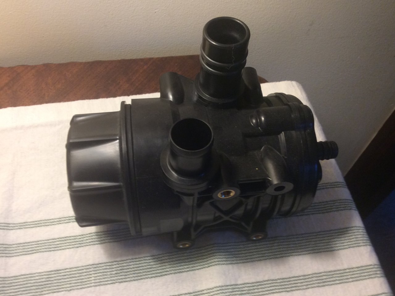

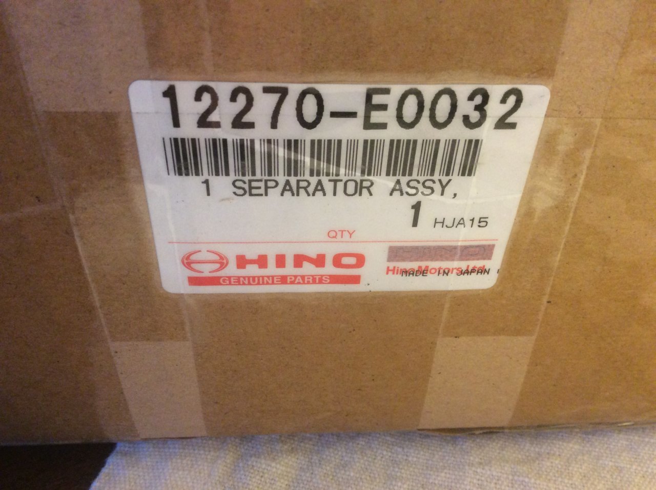

    I'm using the oil separator that the Japanese diesel trucks have... Hino, Isuzu. I'll grab a pic.

    Mine were the same way. Lots of black stuff. I got a catch can for added peace of mine going forward. Especially with higher crank case pressures.

    Stock plugs or a deg cooler?

    Just gotta ask , can you change the plugs without removing the blower ???

    These are the add in units that the OEMs were using. They can be connected to a catch reservoir or drained directly back to the oil pan. I have a couple Hino 12270-E0032... about $100 + the ride from Japan. Hino USA is over $200. Isuzu has the best deal on their unit, part 8-97324682-1 was around $50 - $60 last I looked. The filter is a little smaller.
