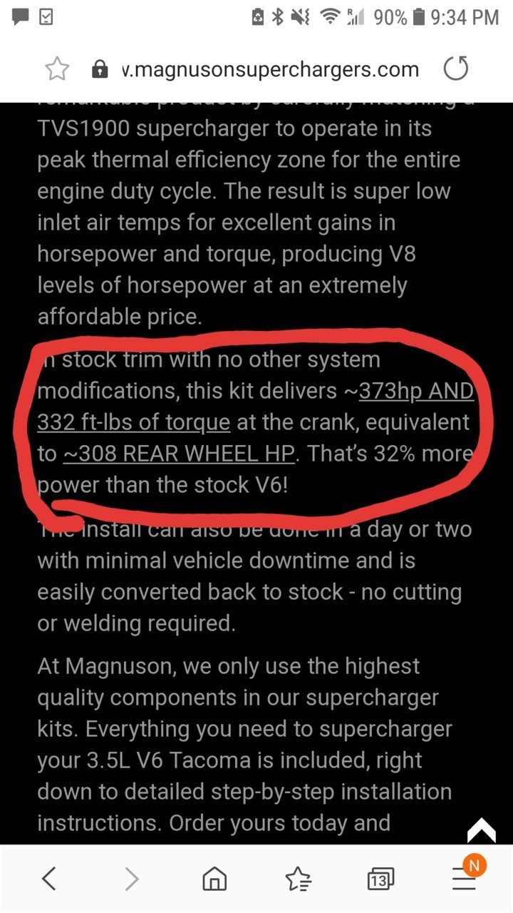

    Did you Dyno it? If so, I'd like to see the numbers.
    When the TRD blower came out from Magnuson for the 2nd gens the "mod" was rated at the crank assuming the 70HP the blower was supposed to add to the OE engine, which gave it 305 HP / 335 TQ. The OE 2nd gen Tacomas came with something around 188 - 192 ACTUAL HP which is a far cry from the advertised 235 HP it came with OE in the 4.0 engine. Add 70 to 235 and there's your supposed "mod HP rating."
    I would be incredibly surprised if they actually dyno'ed it post supercharger install to come up with those figures instead of just slapping numbers on top of already known engine base HP ratings of 270HP. That would assume a 166.6HP (give or take a few ponies) HP gain after factoring in your 18% drivetrain losses to the rear wheels. That's too much to give a blower right out of the box especially when we are talking from Magnuson and also implies MORE THAN a 30% HP gain right out of the box that they are advertising.

    Oops. Hang on, they are advertising 32% power increase. I was off by 2%. So the final rear wheel HP they are seeing out of this thing is 308.

    Working the numbers backwards from their claims, they are assuming a 16% drivetrain loss. So that’s 95 hp OE rated. I’m still on the fence on actually spending ~$6k on either a SC or TT setup. That’s a lot of moolah for only 100hp. But, if that amount of money changes the performance in a material way, it may be worth it.
    If the taco can now tow a 4.5k loaded travel trailer and the experience is significantly better, the equation then becomes $6k vs trade (at whatever cost) vs no trailer for me. I have a backup tow vehicle, but I’d prefer the taco for hard work.
    I’m holding out hope that we get to see some real dyno numbers so we can see what the torque curves look like down low. I don’t want to have to be at 4500 rpm before I see real gains. I’m sure it’s lower than that, but how much?

    18 is the more plausible proven number on these trucks and since the 3rd gen group shares the same frame setup almost identical to the 2nd gen is say that number is a little more likely.. however, unless you guys have a different tranny than the A750E/F that 2nd gen guys which you probably do, your tranny may be ever so slightly more efficient than ours.
