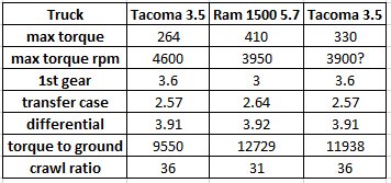

    I got questions. I am interested in this but not for a few years down the road. I came from a 5.7L Tundra and I currently have a 2017 TRD OR DCLB that has dodged every recall, never had shifting issues, I have had no mechanical/functional issues with anything on this truck. Best Toyota I've had for the last 53k miles. My AWD 2.4L Matrix had some minor stuff over 99k miles, and my Tundra had all the door lock actuators replaced, and some other minor things in under 30k miles. But this Tacoma has needed nothing and hasn't had any TW plagues. I was rather satisfied with how the truck runs compared to the Tundra given the obvious differences. I want a supercharger for this truck.
    The performance of this engine isn't that bad. Nothing gets low end torque except diesels because of the EPA regulations. They need these engines to sip fuel at low rpm and still give you the power up top. Look at the these engines and peak torque rpm. Considering this is a small displacement non-boosted engine its not really an outlier at all. Would we all like it better? YES.
    Max torque on the 3.5 compared to the 4.0 is 200 rpm different.
    Max torque on the 3.5 is less than 1000 rpm from anything non-diesel being built right now. Some V8's even are similar rpm like the 5.0 hits max torque 100 rpm less.
    Max torque on the 3.5 is only 600 rpm higher than the only big block push-rod gas V8 (Ford 7.3) being built right now. 600 rpm.
    Our 3.5/4.0 Tacoma's have more HP than the 1990 454.
    There are other factors obviously, but basic gear ratio run down stock 3.5 Tacoma isn't much different applied torque than a 5.7L HEMI Ram 1500. I have the heaviest stock configuration of a Taco and my truck is still 1000+ lbs lighter. A Maggie on a stock 3.5 Tacoma should make these trucks run like a small block half ton on a diet and if they can get the peak torque under 4000 rpm the torque will be at max lower than every V8 being built right now except the Tundra (like they did with the 4.0's).
    I'm not disagreeing. Who doesn't like low end torque. I'm just saying looking around the room, the performance of the 3.5 isn't much different than the 4.0 or other truck engines as far as torque curves and whatnot. Its gonna come down to gear ratios and the trans tuning (like what has been said already in this thread).
    So I'm here with everyone else waiting for a legit dyno chart and youtube video. :popcorn:
    **There are flaws in this. Basic gathering info to put in a chart. I'm not a drivetrain/tuning/engine expert, but neither are most of the people in this forum. This is not to pick a fight with anybody, just general discussion about how the Maggie charger could/should aid the 3.5L trucks.

    A properly sized turbo or S/C should keep peak torque at the exact RPM as stock. However, it should raise the entire torque curve to match the stock N/A motor shape. The only thing that should shift a torque curve (to higher or lower RPM) is a change in cam's, intake manifold, etc. Forced induction should increase power everywhere (EDIT - For a DD, not a dyno queen)

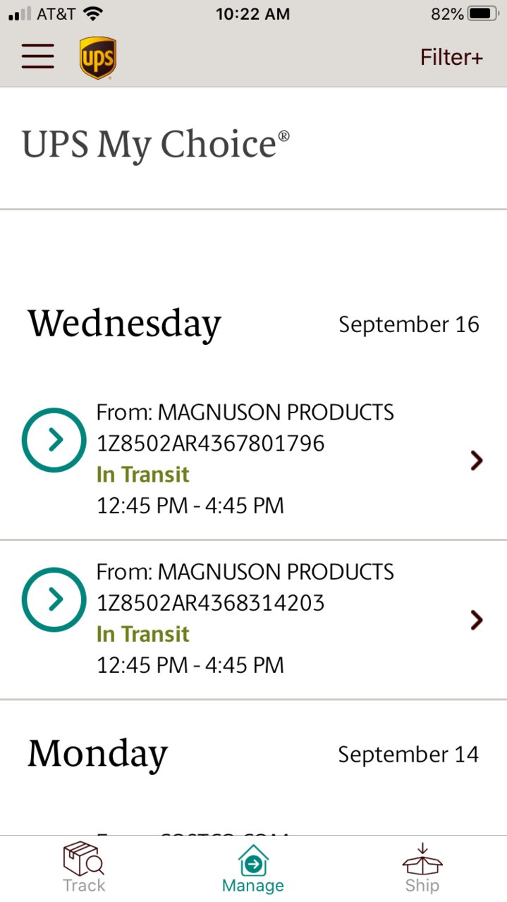

    Wednesday can’t come soon enough!

    UPS has shipping/delivery issues. Pretty sure your special package will arrive at my house! Congrats! Keep us posted iwith lots of pics. Like others I am waiting for CARB. You lucky person you!
