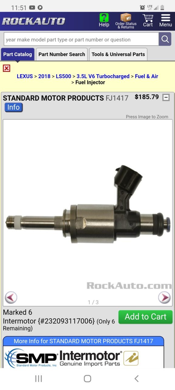

    Hmm I wonder if other models would fit.. after looking around I found the ECOboost's Direct injectors look very similar..

    i would think so.

    Being from DW, they will have a injector operational values as well. For the tuning aspect.

    They cheaper?

    Yeah about 900 for a set from what I can find. Not sure what the Flow rates are on the Lexus ones, so can’t really compare.

    Is there a reason the extra fuel can't come from bigger port injectors instead up upgrading the DI ones?

    Mat from OV tune already tried that with his twin turbo system. He found that no matter what he did with the tuning he could not prevent unequal fueling in the various cylinders. He then tried upgrading the direct injectors and found that he could precisely fuel each cylinder. I would much rather change the port injectors since I can swap out all 6 faster than I can change my spark plugs. Unfortunately, the only way to upgrade the fuel system is by upgrading the direct injectors on the 3rd gen trucks. Hope this helps.
