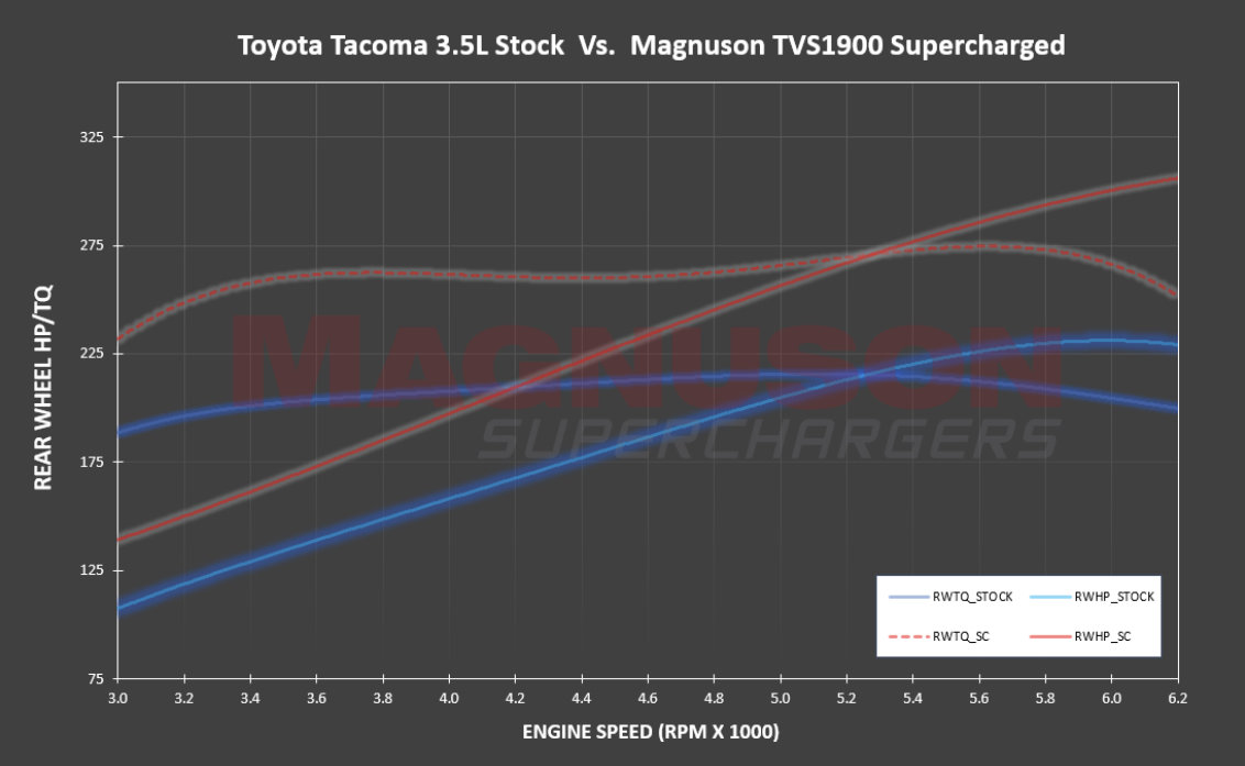

    I got the email too today from them saying ready for ordering, which also included the above posted dyno chart.
    Wasn’t blown away, especially since the 2nd gen SC made notable more torque and was
    supposed to be a much older style/less efficient SC design. Also the big HP gains are very much mainly in the higher 4500-6000rpm range.
    I will give it that the torque, well not nearly the 50% gain Magnuson posted on their website for many months (why all of a sudden a huge drop in gains?), is linear but the graph starts at 3k rpm and it looks like it drops notably prior to that.
    The similar TVS1900 kit for old JK 12-18 Jeep produce much more power then our Tacos.
    I really hope that their will be other ways of improving the power output safely and reliably for the trucks, like a smaller pulley, fueling etc. Because right now Magnuson seems like they came up short, especially since they advertised 50%+ gains they posted for months on their site just to change it to 30% and their posted dynos seem to me like it’s even less than that.
    This was a worst case scenario for me, if the dyno numbers were great, it was an easy no question about it purchase for me, if they were super bad, it was an easy no go, but now they are just “meh” and I feel more confused then ever :/

    What dyno chart are you referring to? The one drawn in crayon?

    Sorry it may have been on a different page, here it is, it was in the email Magnuson sent today.

    I'm not bashing.
    The "dyno chart" posted was so smoothed and cropped it was basically useless.
    Edit.... This one:
    Mat posted actual dyno graphs. The fact that they were low res is besides the point. They may have been difficult to read, but at least they were real data.

    That's the one I assumed you meant, thanks. To me, it looks like the marketing team got a hold of a preliminary dyno chart.

    No problem. I really hope your right, cause compared to other dynos running the TVS1900, it’s disappointing.
    I really like Magnuson and hope that they will surprise us all with new tunes which produces much better numbers, cause the TVS1900 should easily beat out the 2nd SC in both HP and TQ, and right now it’s not.

    Their hardware is capable, no doubt there. What is holding them back now is their calibration and fueling. I hope they have a very good plan in place to solve both.

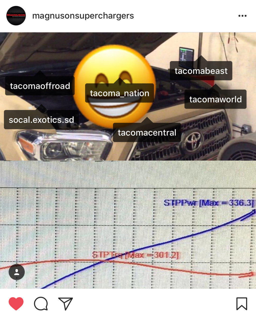

    The only official dyno of any type I've seen from Magnuson is this teaser from a few years ago, which shows the engine making almost 300ft/lbs of torque at 3,000 rpm's. Though we don't know if it's at the hub or wheel, or if it's std or sae numbers these numbers are in line with what a lotus exige/tvs1900 can do with its 3.5l v6. These compressors make 500+ whp on LS motors they're going to have no problem making good power on the Tacoma, only thing holding it back as ovtune pointed out is getting enough fuel, which currently seems to be quite expensive. Eventually Di injectors will be cheaper and people will have 500hp Tacoma's running e85 and doing lots of doughnuts to non-licenced music....literally doughnuts for days.

    Assuming that was legit, it makes me wonder how they achieved this without being able to tune the stock ECM on stock components. Complete ECM replacement? I don't doubt the results, but like you I question the conditions.
