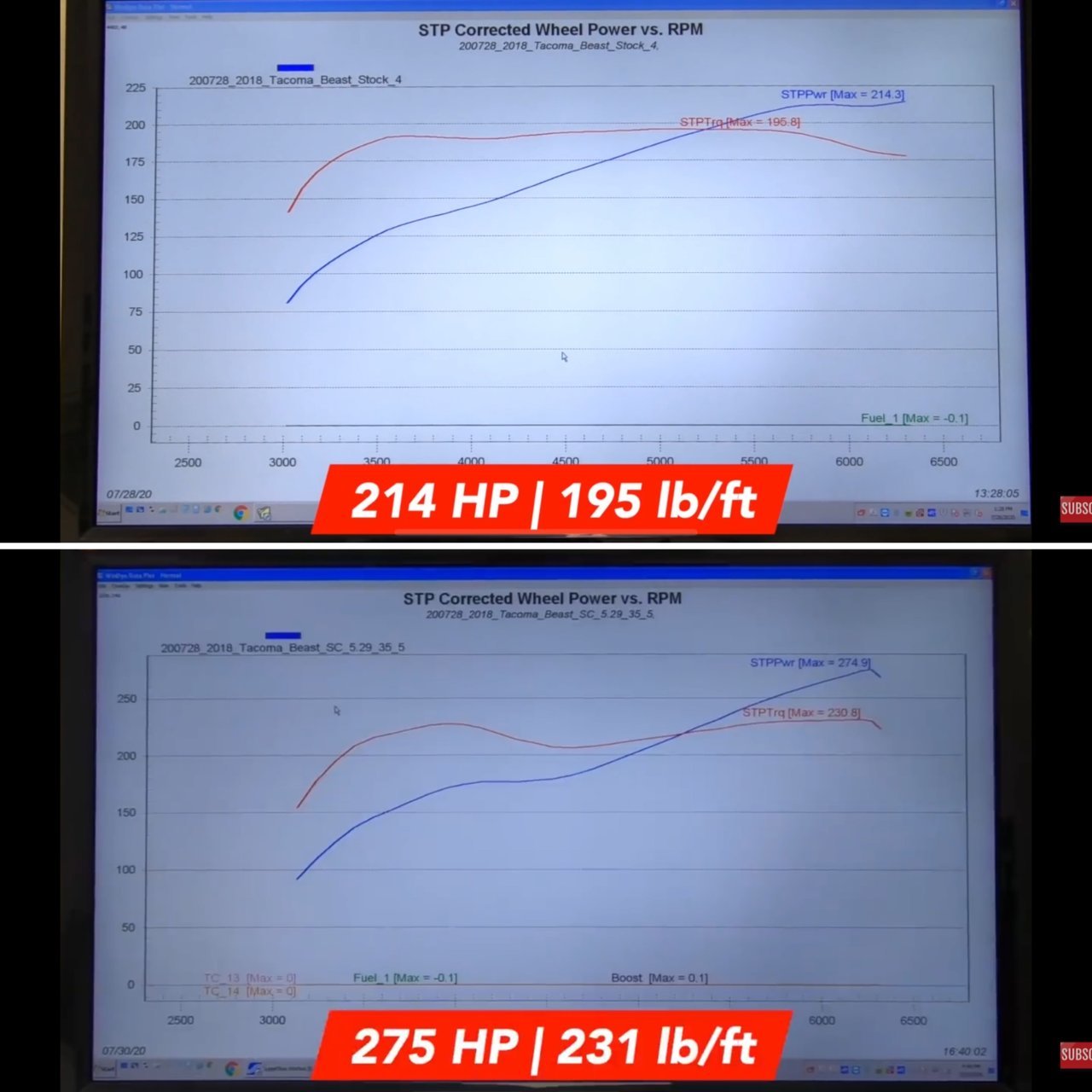

    iirc, the beginning of the video showed a Mustang Dyno. To give benefit of the doubt where power is concerned, I have heard over the years that this type of dyno does tend to read a little lower than average. This type of dyno doesn't measure at the hub however, I've had a car of my own on one before.
    If you measure at the hub, then tire size doesn't matter, because you're not measuring at the wheel.
    The baseline they dyno'd at prior to installing the supercharger gave them 214whp, and the dude sitting in the driver seat said that stock Tacomas were getting about 225-230 or so iirc. Somewhere around there.
    Post install with the SC had him up at 274.9whp and if I'm not mistaken, 230wtq.

    so uh 20 hp and 15 tq at 3000 rpm?
    I hope no one is buying this for low end power..
