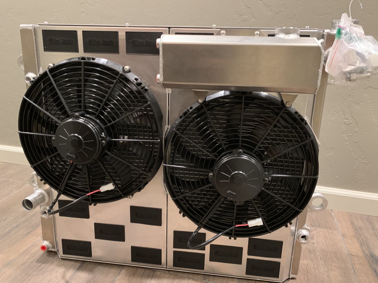

    Already done a few times. If you look at flex-a-lite they have a universal dual with aluminum shroud that is almost perfect for the 2nd gens. If you want I'll dig up the P/N I did a lot of searching for this it's on my list. The flex-a-lite is pricey though at 1g+ iirc so if you could bring that price down some that would be slick.

    i think with controller 2 spal fans and a new overflow it would be around 600ish

    i was the engineer who fixed the c7 corvette track cooling issues for chevy performance. cooling and power is what i do

    If it could be slim enough to push the rad and stuff back a few inches I'd be even more interested that is a lot better than what I was looking at. I'm on board if you want a 2nd gen to play with let me know I'll be glad to volunteer.

    Best. Which controller would you use? I am trying to remember a name. Cool master, cool pro...it is eluding me.

    i dont know yet. depends on cost and what i want the kit to run. i would love to go to a PWM setup and a lingenfelter control unit so i can have it soft start and command the speed on the fan.

    Here it is. >>> "I’m pairing this with my Autocool guy NB-100 pulse width modulation controller and Bussman RTMR relay box, for power distribution. I’ve drawn out a wiring schematic, and it’s actually turning out to be quite a bit more complex than a simple set of relays. I’ve been uping my wiring game with use of tech flex and MetriPack connectors. Should look good and provide silent, factory like control of the fans.
    I’ll report back in a couple of weeks once I get in."

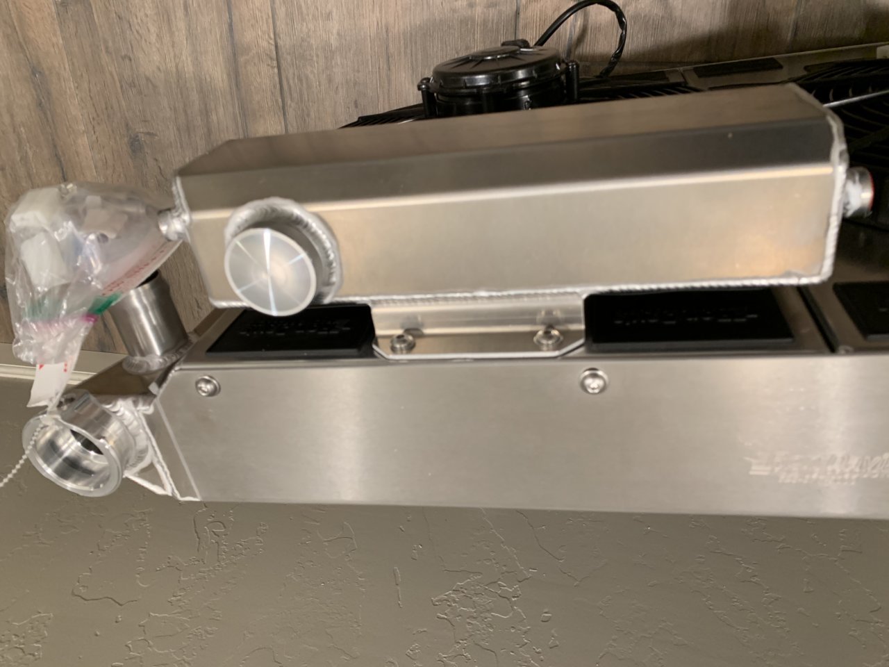

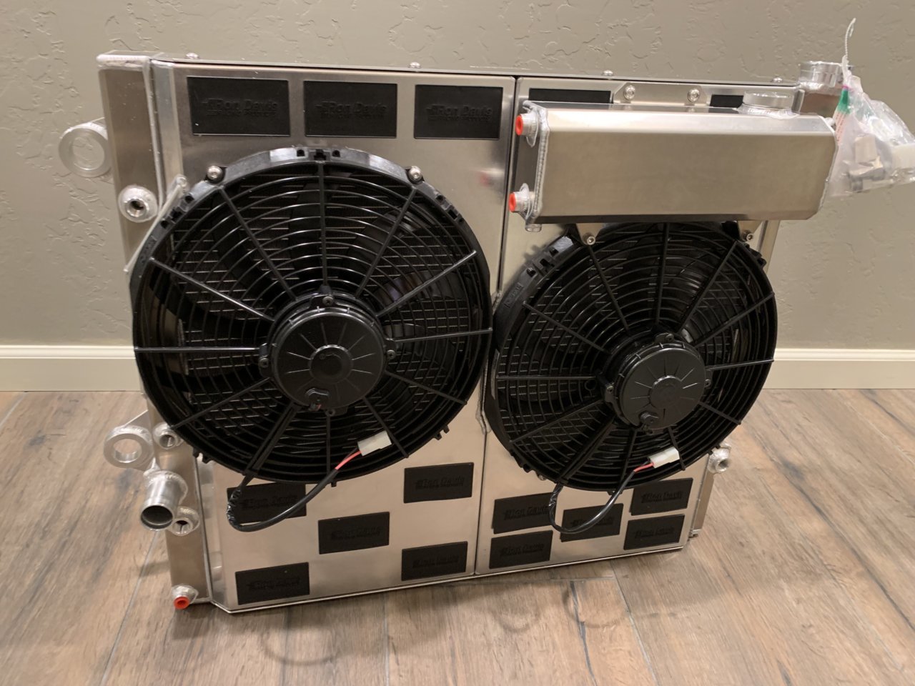

    that is overkill for these trucks. a no shroud dual fan setup would be fine. shrouds actually stop flow on the highway. if it can work fine now with a 20in clutch fan twin 14in fans kitty corner from each other should work perfect. put it on a thermal probe command unit and a relay for driver override and it should be more then ample.
