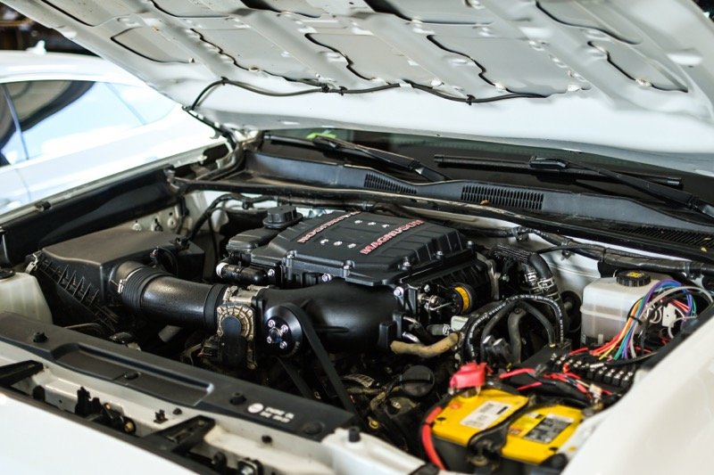

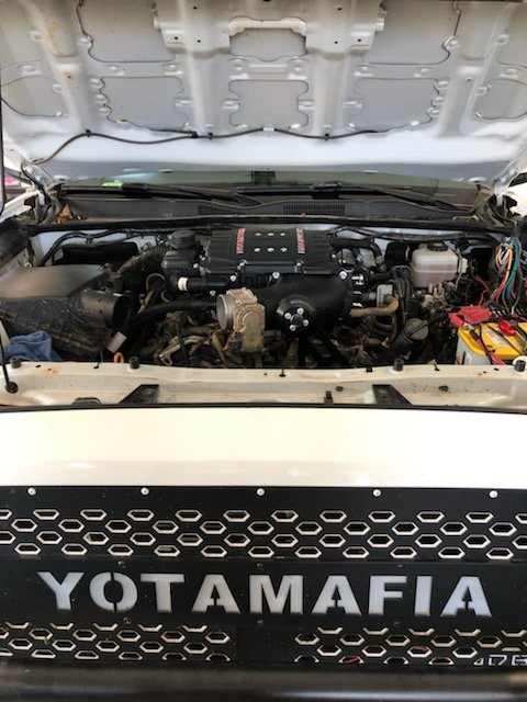

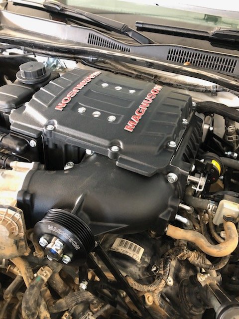

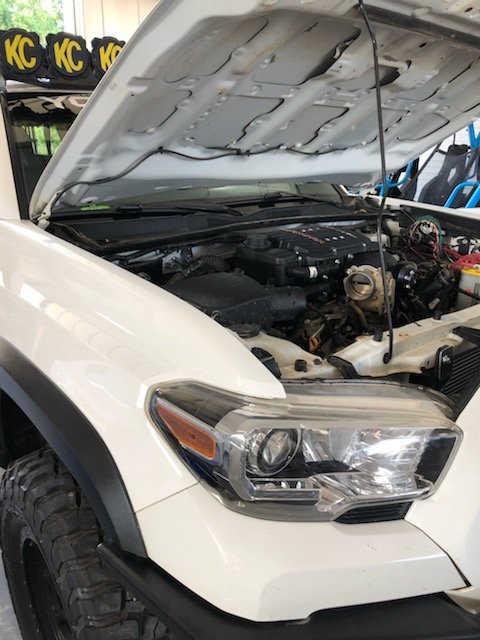

    Ok back on topic. Tuning came thru late last night here are some pictures of it all finished

    NEW INFO*****
    the magnuson tune does compensate for your truck's Transmission, 2 vs 4 wheel drive, Tire size, Gear ratio, cold air intake and exhaust. these are all parameters they ask for when sending for the tune with magnuson.
    it even corrects the speedo for the tire size and gear ratio.
