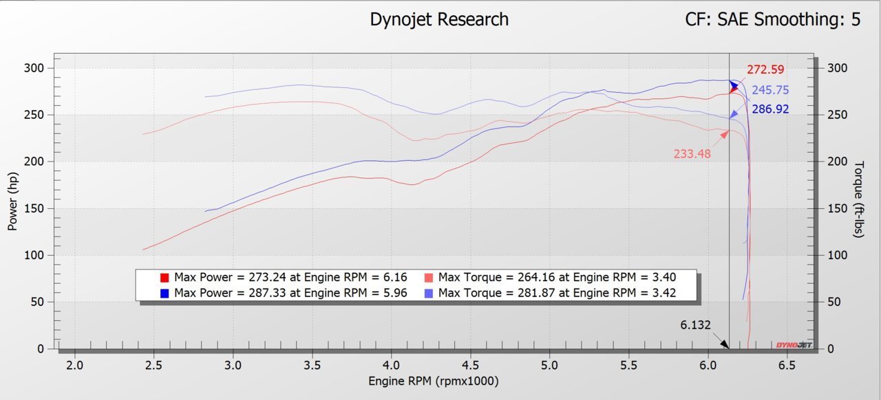

    Install the 87mm pulley. Also consider a URD Spec U exhaust with equal length Y pipe. Both of these increase area under the curve and make a noticeable difference in power. They also help to fill in the torque dip at 3700-4300 RPM on the stock Magnuson tune. See dyno below. Same dyno. Same day. Same ambient temp. Just swapped exhaust and pulley while strapped down. Keep in mind stock NA motor with OV tune 2.0 dyno’d 212 WHP. Prob barely 200 WHP without the tune. So these trucks are basically anemic from the get go. The supercharger turns it into a normal truck to drive around town. Supercharged 0-60 is in the 6-7 sec range. Big whoop.
    Absolutely. Pick up a $200 laptop, download VF tuner and get the original file sent. After doing a bunch of test tunes and bricking the ECU multiple times… shit happens. One fail in particular was unrecoverable via the VF tuner step by step recovery procedure. Right before calling the tow truck, flashed the original Magnuson file and the truck was back on the road. Point being, just get the original file and keep a cheap laptop in the truck at all times.
