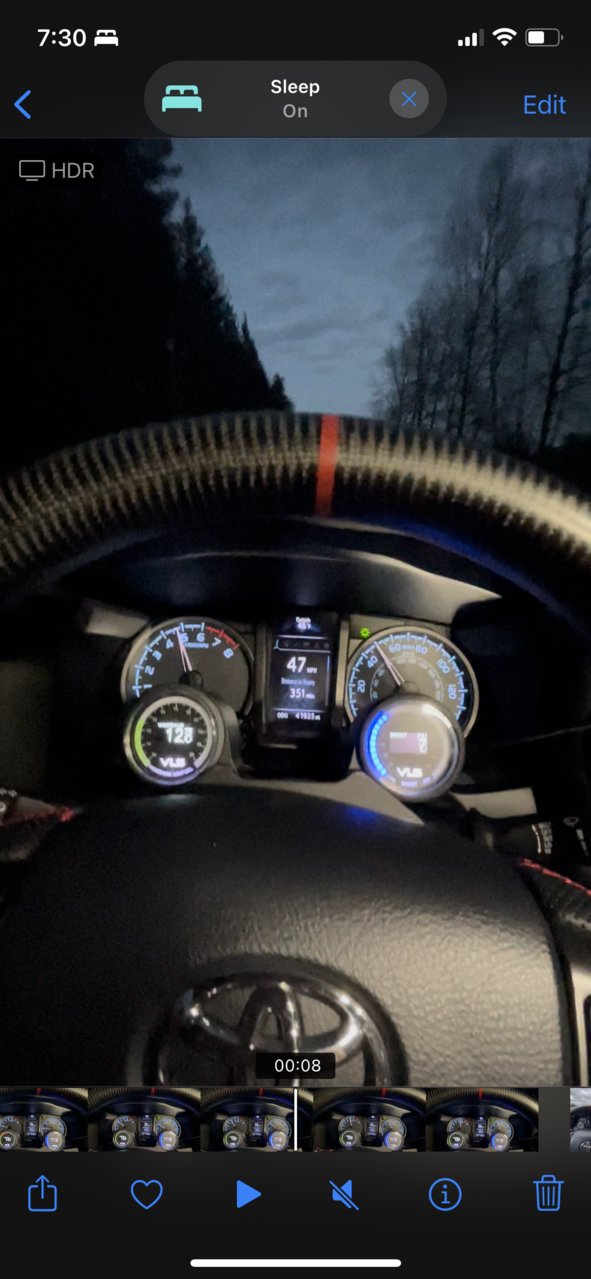

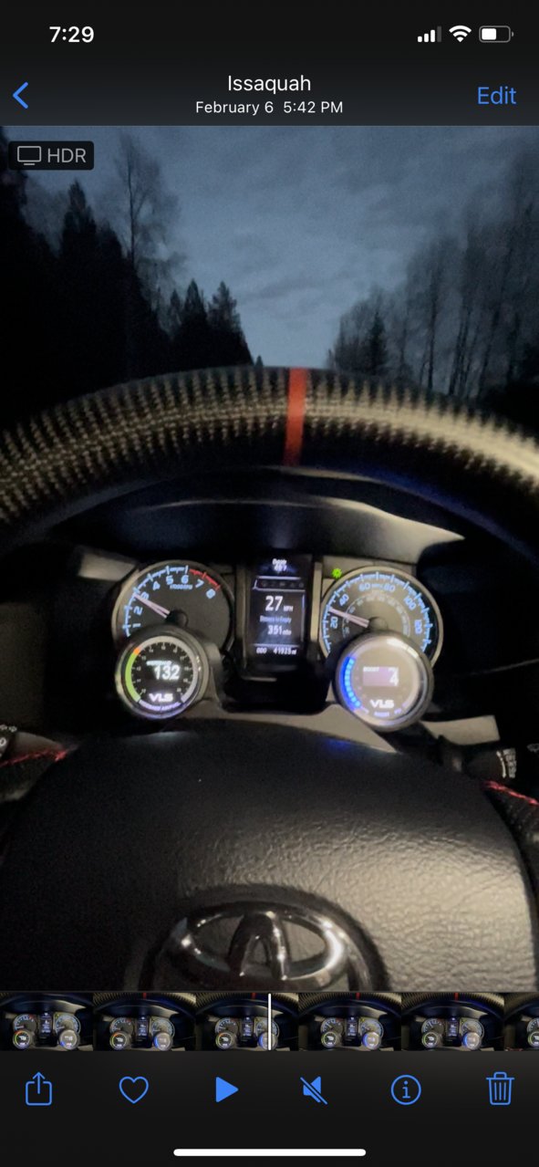

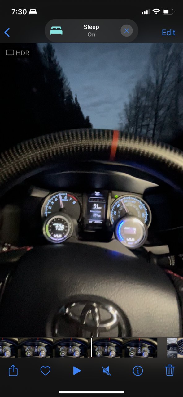

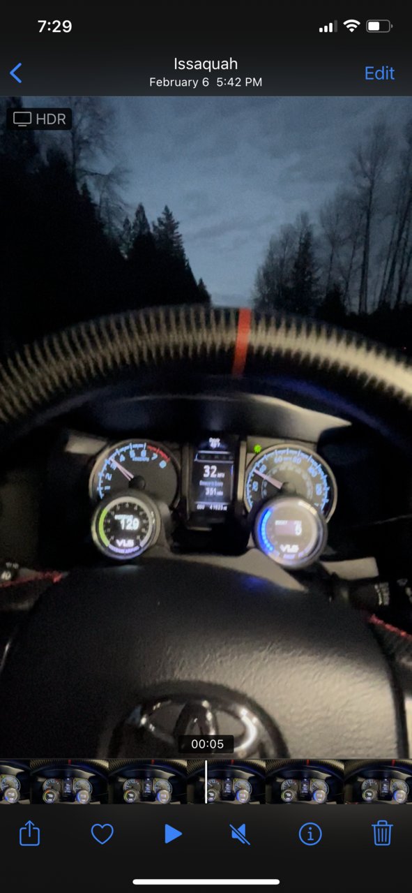

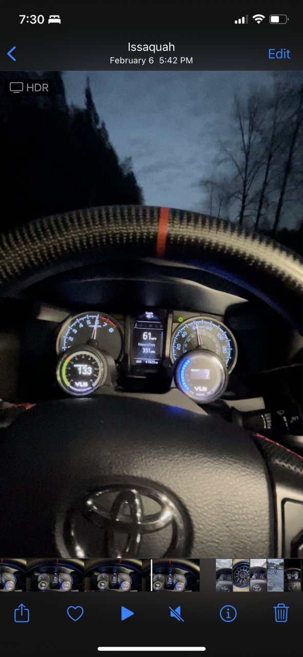

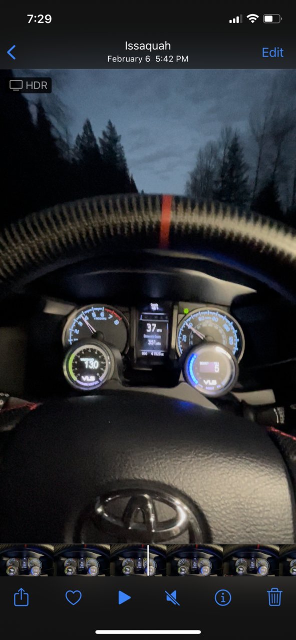

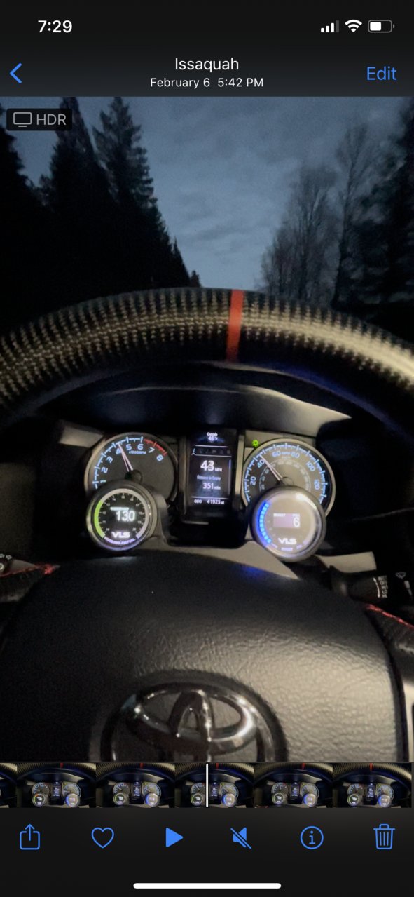

    Bro… you gotta trust me on this one. Will show you screen shots of the AFR gauge. I have a manual trans so I can go max throttle in any gear and any rpm. Magnuson tune never accounted for the restrictor to be removed… Period. Ever wonder why it makes such a big difference in throttle response. Its like installing a smaller pulley. I literally threw mine away after I installed the supercharger. Had to dig through the garbage when I found the AFR discrepancy. Now AFR’s are consistently 11.9-12’s in the same RPM range even with the 87mm pulley.
    It’s ultimately up to you guys to do whatever you want with your trucks. But after running a bunch of tests on the street and dyno my restrictor is back in place. Unmodified.

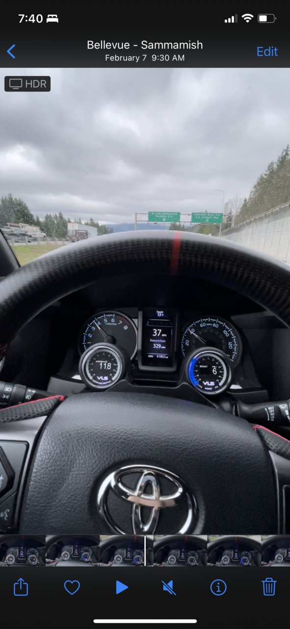

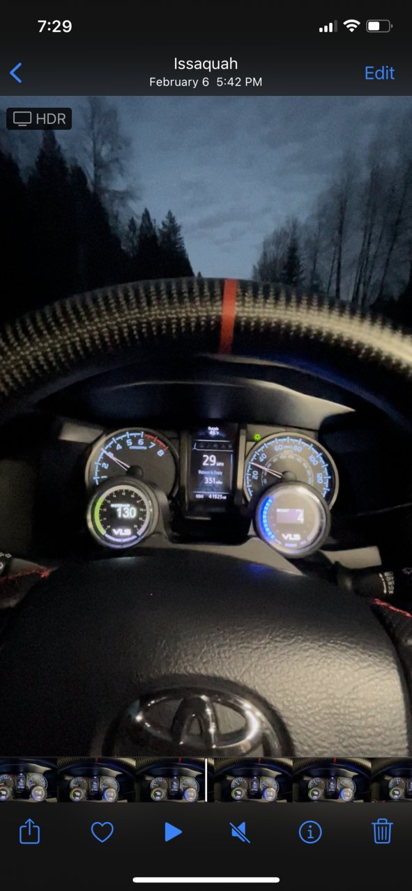

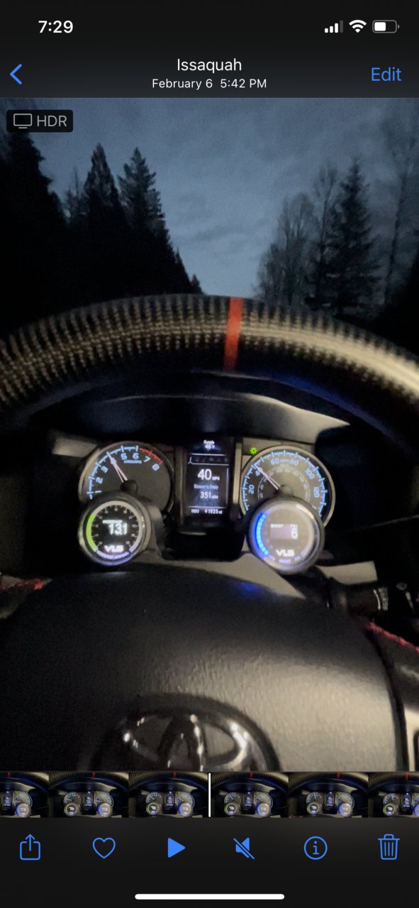

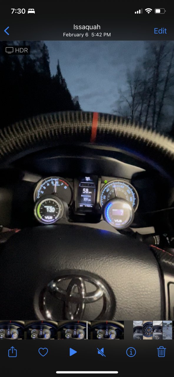

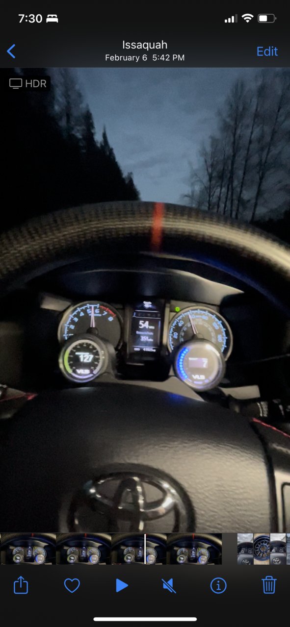

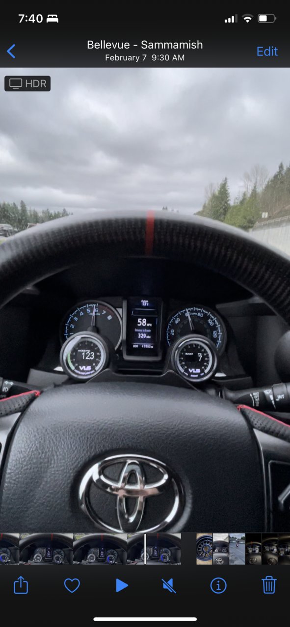

    @OpelGT Here we go. Screen shots. Restrictor out. 90mm stock pulley. Magnuson tune. It runs lean in more than the stated range. Note the 13.3 right before 6k redline.

    I think you're both right. The physics of the function of the bypass supports the fact that there shouldn't be any effect once closed, but based on what we've observed while testing, I'm also led to believe something else is going on.
    This is either compounded by or due to the fact that I've documented on both NA and FI applications, the passenger side bank runs leaner than the driver side.
    There's multiple ways to go about accounting for this, and each warrants its own line of testing before deciding if it works in multiple scenarios and climates or not, and if you want to use it. For example, I recently successfully made the ECU target richer than 11.9AFR across both banks as low as 27-2800 rpm in 72F weather. Perfect! Anyone who was irresponsible would say sweet, we're done here. But then it ran way too rich in 15F weather and was choking out the system. Not perfect.
    So I'm still evaluating other similar options that work across multiple climates and don't send your fuel economy into the single digits.

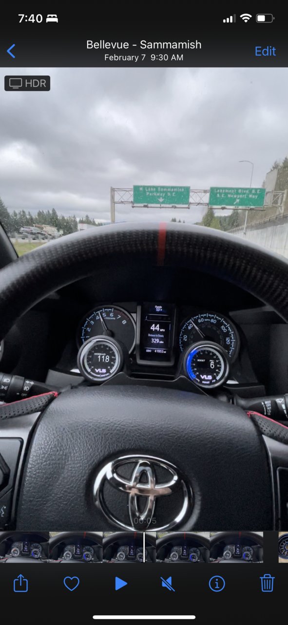

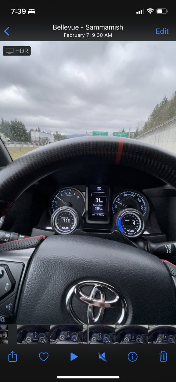

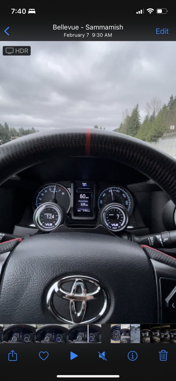

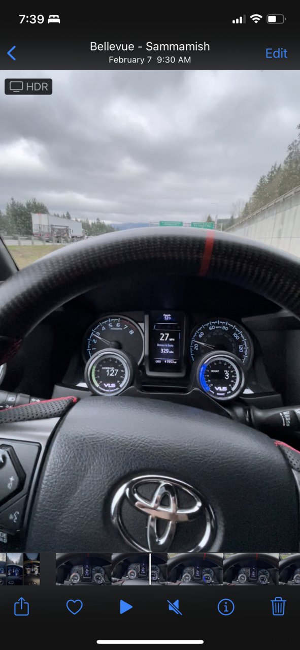

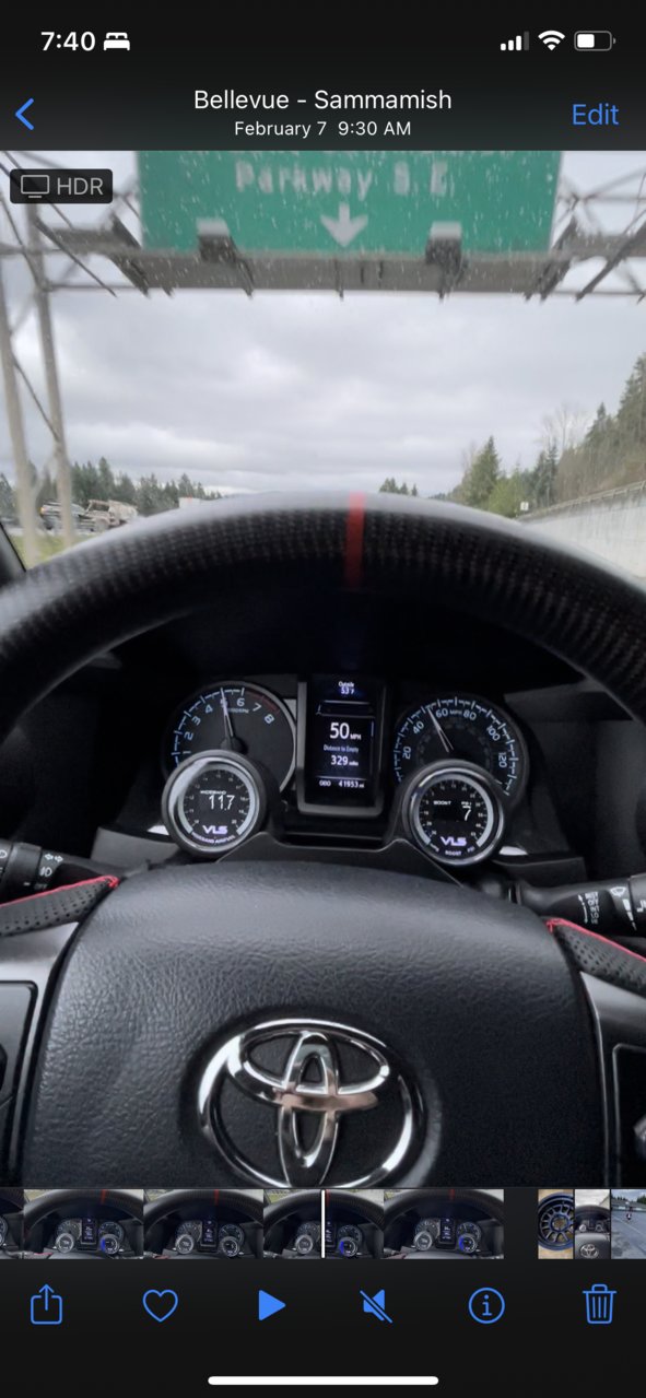

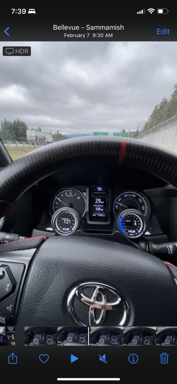

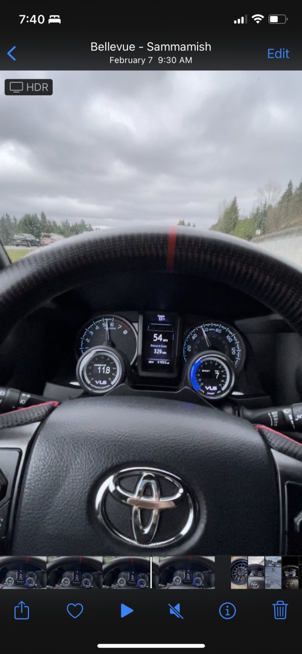

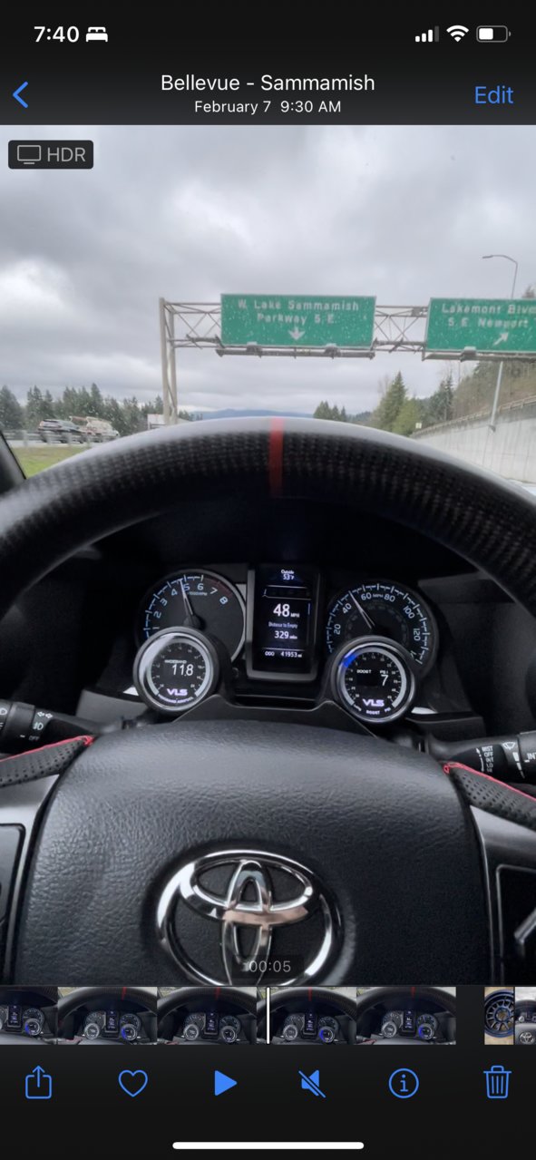

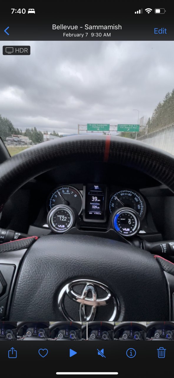

    @OpelGT The very next morning Feb 7th. Screen shots. 90mm pulley stock tune. Restrictor back in per @mZiggy ’s solid recommendation. He thought it may be messing with AFR and sure enough...
    Less power but clearly safer AFR on the stock Magnuson tune.

    For those of you like me that chucked your restrictor or modified it you can purchase one brand new for $11 + shipping from superchargersonline. Email David. Let him know you need the brass bypass valve restrictor fitting for the Magnuson TVS1900.
    david@superchargersonline.com
    Again, I would not remove or modify this piece of equipment if you are on the stock tune regardless of which pulley. The discrepancy will only worsen with the smaller pulleys.
