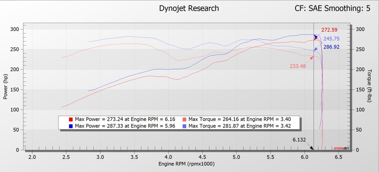

    I'll be installing my 87mm pulley next weekend, but I don't expect too much. You can see in this post Magnuson Supercharger Yotawerx Tune Dyno Thread @Formidable only gained 14hp and 17ft/lb of torque.

    Yep, it’s not a lot but 14hp is about a 5% increase. Considering it was an $8k purchase for ~30% increase, it seems like a few hundred bucks for a pulley is money well spent.

    Hmm… The peak power and torque delta is one thing but the area under the curve increase is substantial and should be a noticeable difference. Fills in the gaping hole in power in the 3700-4700 RPM range to some degree. You should feel this on the butt dyno. Do you have a dyno shop nearby that can confirm? Or a draggy? If not I would pick one up. Cheap but very accurate multi-satellite performance logger. If no boost gauge or dyno, 0-60 pulls, 1/8, 1/4 mile runs will tell the story.
    If throttle response is what you’re after the @mZiggy Yotawerx tune won’t disappoint. Literally turns the throttle response into a V8 down low.
