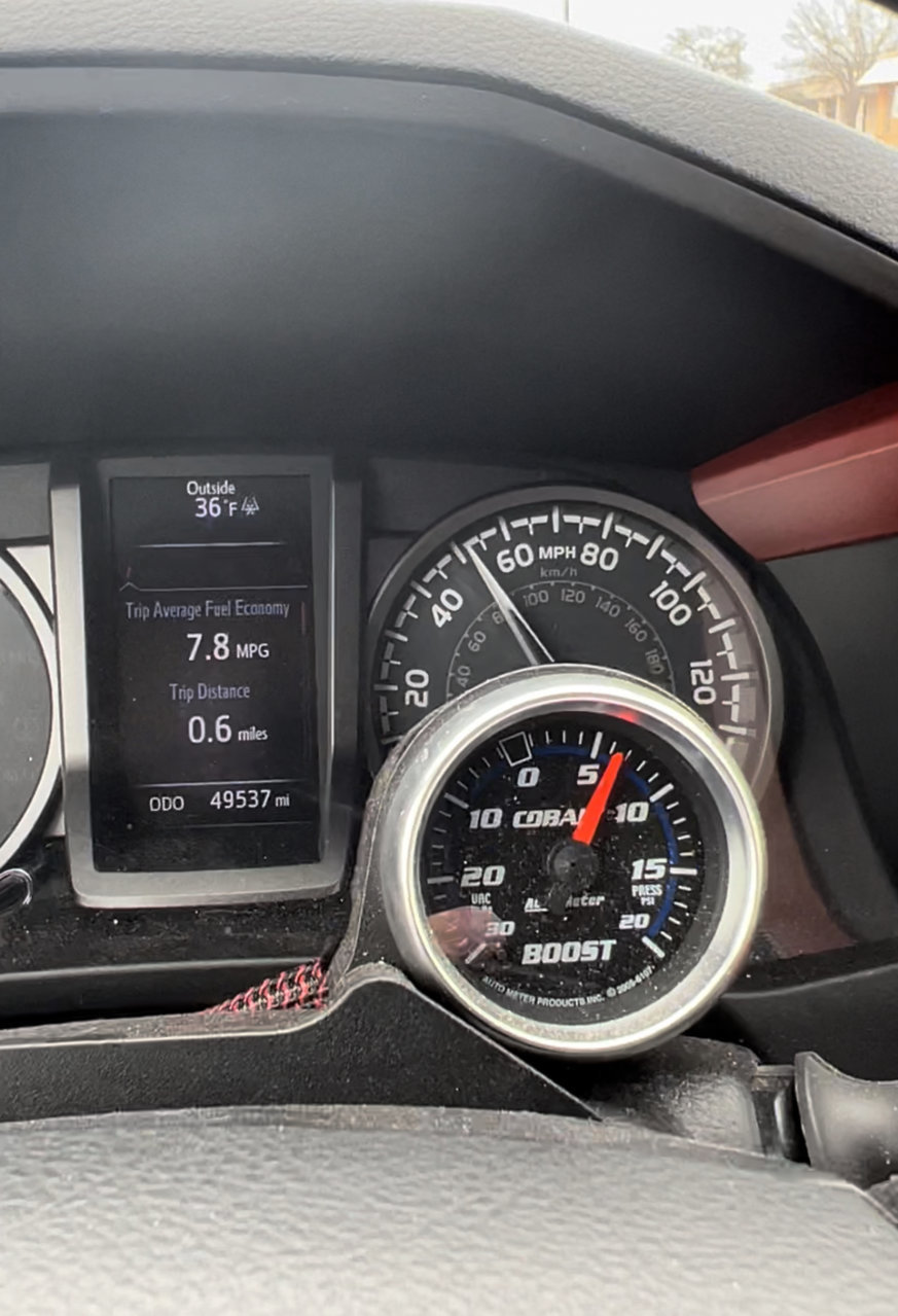

    Yup. 38 deg exactly? 3-5 psi MAX. At 39 degrees? 8-9 psi. That’s a big fucking difference. Many hours of work with @mZiggy including eliminating the CETL table entirely to figure this shit out. Meaning zero cold start protection. NOPE! Thanks Toyota! Lol

    We tried everything. Including trac off. Partial and all the way off holding the button. Doesn’t work. ECU still limits torque and boost.
    In 30’s ambient with nothing in the bed we can break the rear end loose whenever we want. Even without the supercharger. Still fun… but there is a definite decrement in power that occurs at 38 deg exactly.

    I just tested. I can still get my full 7 psi at redline with the snowflake on and my engine below operating temp.
    This weekend I’ll give it a test at an even colder temp with a fully loaded trailer, but I’m 100% I’ve always been able to get at least 7psi in 2nd gear.

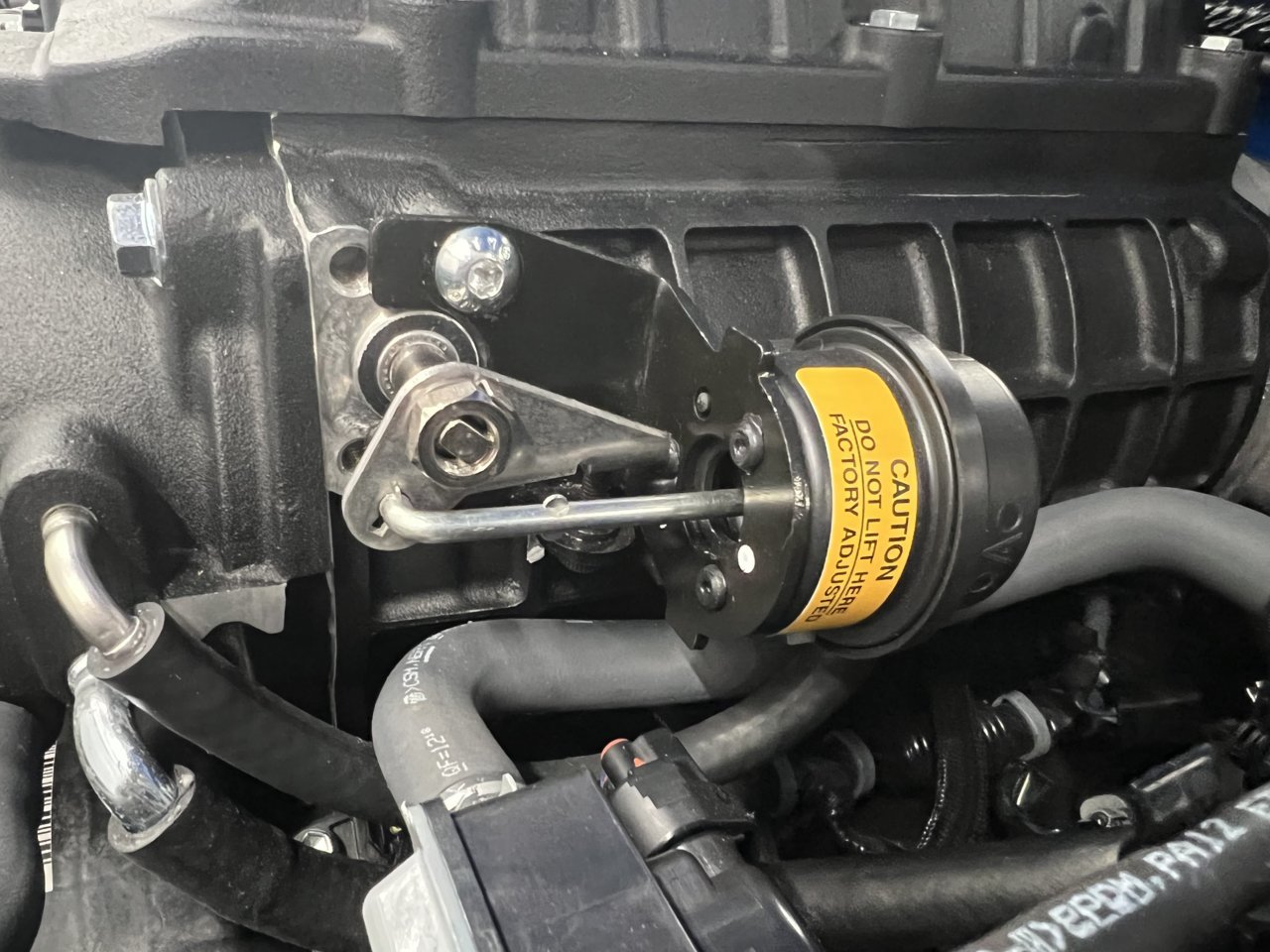

    I was re-installing my restrictor and I didn't want to take the chance of dropping the little part while fumbling with cold fingers in a 20° garage so I removed the two button head cap screws so I could turn the solenoid (or whatever it's called) over . Does anyone know how critical the adjustment is on this? The two holes in the bracket are slotted so there's a LOT of adjustment.

    Probably not very important as long as the actuator arm is fairly straight.

    What does this thing do anyway?

    At cruise\low\no load conditions it allows your intake air to bypass the supercharger. Once you open the throttle a certain amount it shuts the bypass valve and routes the air through the blower to create boost.
