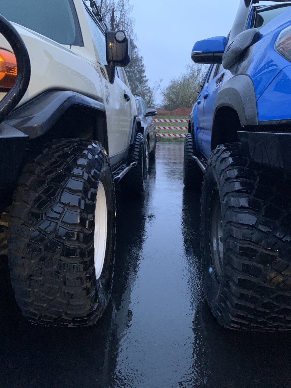

    beautiful setup. What lift and tire size do you have?

    Thank you. I am running ICON 58735 up front with SPC’s and OME Dakar Springs in the rear with ICON 57805’s. I am running KO2 315 70/17 (changing today) KM3 315 70/17.

    was the lift enough or did you have to do the body mount mod?

    BMC A MUST! Gusseted spindles too.
