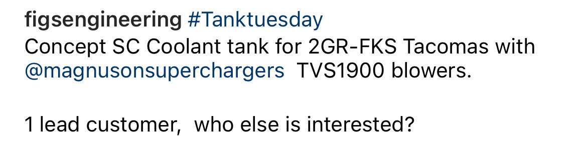

    It might be better to let people know the text of that post, since they can help make it happen by expressing interest.

    It’s aluminum and different. I’m sure someone will buy it lol
