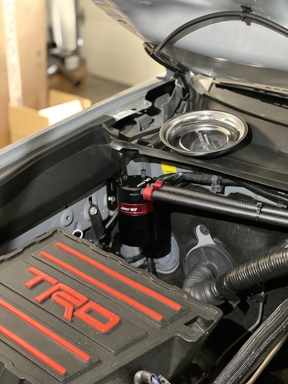

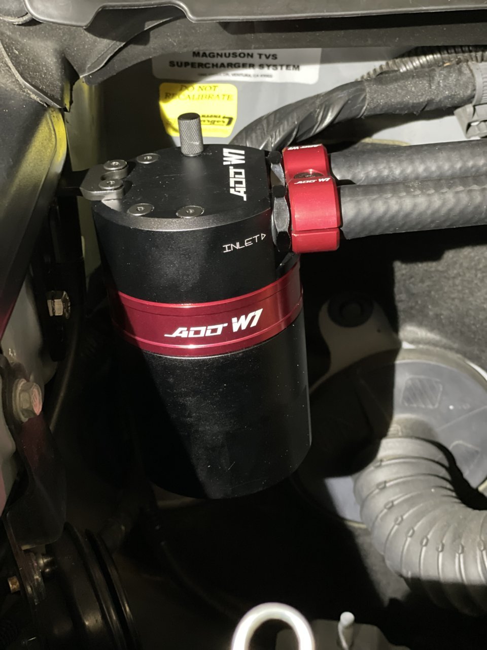

    Did anyone else have a lot of oil in their lower intake? Not sure if this is normal or not. I am guessing it is coming from the crankcase vent back into the intake. If so I already have a catch can that I am installing with the SC.

    yep this is normal and it will still look like that with a catch can.

    Totally normal. And the very reason I now have a catch can on my truck. The ADD W1 can comes in a variety of anodized colors, anodized hose clamps, AND a dipstick to check the oil level. Can also get the can in carbon fiber if you’re feeling fancy pants.
    Before you ask me for a link… Here it is:
    https://www.addw1.com/collections/a...baffled-oil-catch-can-v3-sample-configuration
