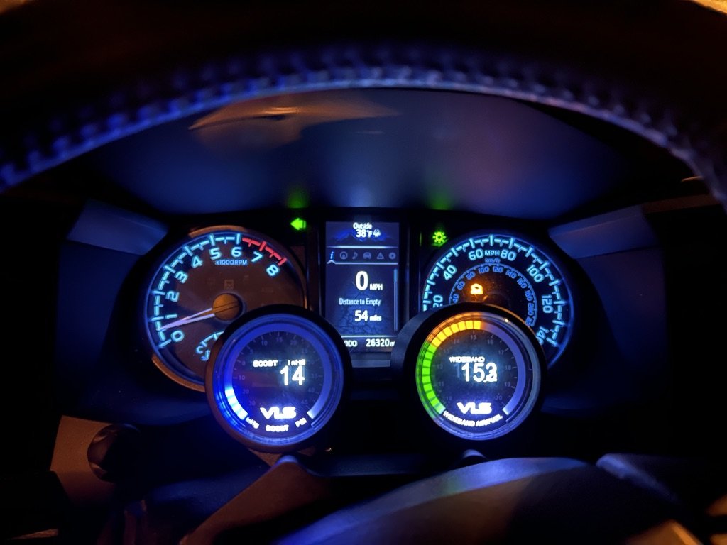

    Anyone have suggestions on what boost gauge they like? I believe I read that I can use T connectors to get psi. Please correct me if I'm wrong.

    LRock
    Hello.. where are you guys tapping for the boost gauge vacuum line? Asking for a friend thanks in adv.

    There’s a threaded port on the supercharger.

    More specifically the threaded port is on the back of the lower intake provided by Magnuson. You may want to use an 90 degree elbow and have it point toward the driver side of the truck. The install instructions specifically call out where this port is at (Page 52 step 191).

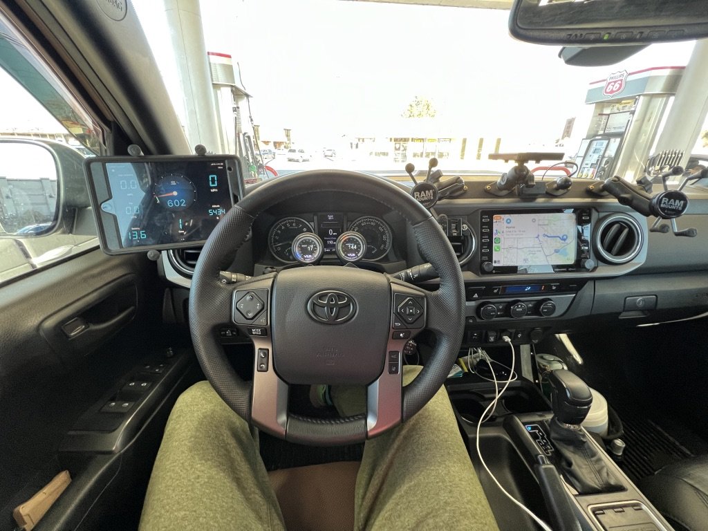

    From a few pages back in this thread, I went with another user's suggestion:
    https://www.amazon.com/gp/product/B0744QBRKT?ie=UTF8
    https://www.amazon.com/Revel-1TR1AA001R-Gauge-30inHg-45PSI-Digital/dp/B0744QSXFL/
    https://urdusa.com/flexpod-gauge-mount-2016-tacoma/
    I am very happy with this setup.
