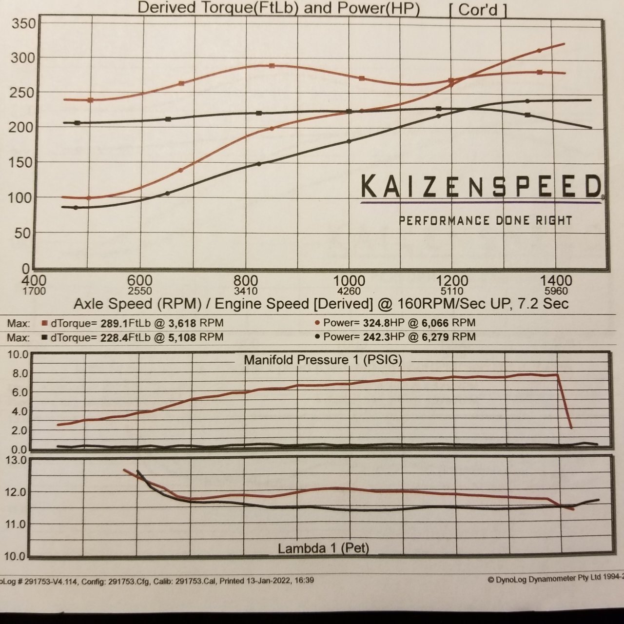

    Hey, glad I fount this thread! I have a '16 TRD OR 6MT with the Maggie on top and I freaking love it.

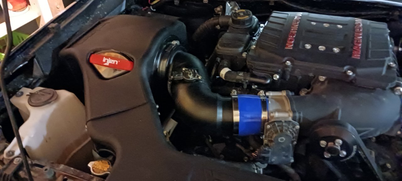

    What I didn't like was that no aftermarket intakes would work with it.
    So I made an adapter to connect the Injen Evolution intake to the magnuson kit! If anyone would be interested in buying one, please go to this google form and answer yes!
    https://forms.gle/tesDxAaj8ZWoAmDw9

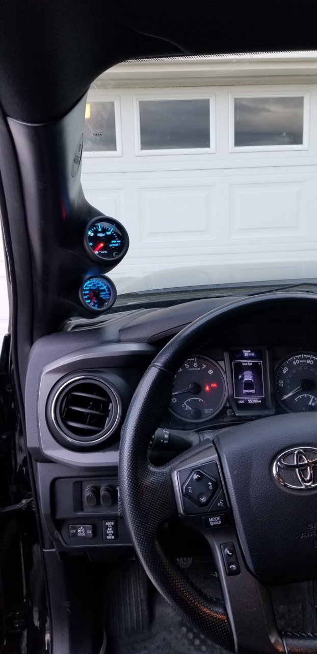

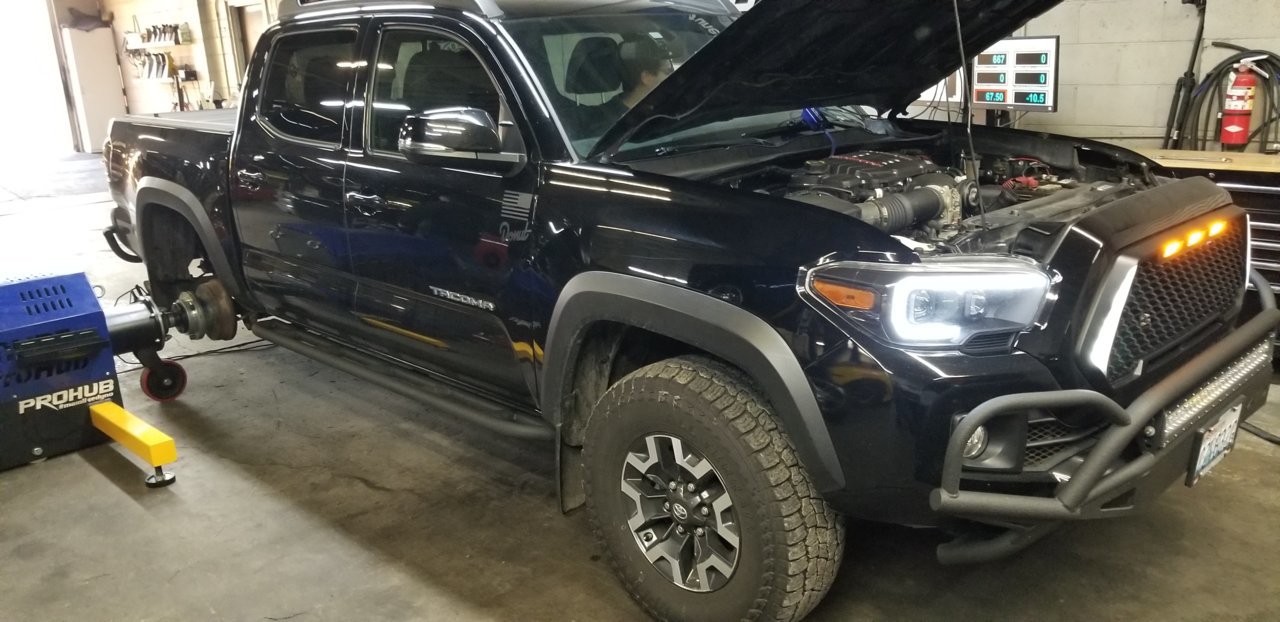

    Here are some pics of my gauge pod from Ortiz Custom Pods (facebook) and my Dyno runs! The Adapter can be seen in the last one. Note: Dyno run was done with the STOCK air system. Black line is before the magnuson and red is after.
    20211213_091627[1].jpg 20220113_160523[1].jpg 20220113_170759[1].jpg 20220407_200821[2].jpg

    would love to see numbers with/without the aftermarket intake.
    reymataco and auskip07 like this.

    I have an appointment to do that, but the dyno is booked all the way through mid-may.

    Very nice! I just placed an order with Ortiz customs to get a single 52mm gauge pod on the pillar. How long was the lead time for you?

    I sent my stock one in and had it back in just under 2 weeks I think.

    That’s actually really fast considering. I wasn’t offered a swap service. I think they’re providing a new pillar panel.

    It's not really a swap, they just modify your stock one.
    If you don't provide one, I think they just source it from a dealer.

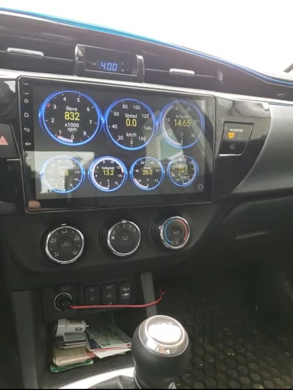

    i use bafx scanner with torque pro app in my corolla. run it in my android radio.

    factory sensors have been wide band since 2001
    o313[QUOTED] likes this.

    They still can't see richer than 0.814 lambda.
    There's controls available for their voltage settings. With the correct values, it's theoretically possible to expand that range that the sensors pick up but... Basically would require a lot of effort spent on trial and error and lots of time testing between an already installed aftermarket wideband vs stock to see if those values could be discovered for future use without a wideband.
