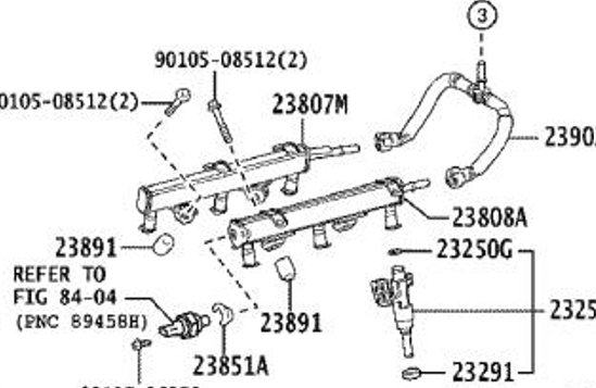

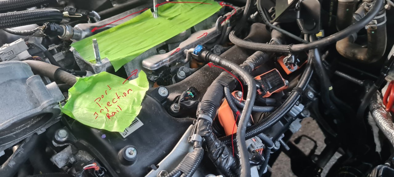

    This is a great solution for the Direct Injection rail, but I don't believe it's the DI going lean. I could be wrong of course, but with the individual rails both being fed from "roughly" the same point, you would see lean conditions on both forward cylinders. In this case I believe mZiggy mentioned the lean condition is on the passenger forward cylinder, which points towards the Port Injection rail.
    If you look at the picture below, you can see how the Port Injection rail is fed from the driver forward cylinder (Number 2) and loops around the back to end at the forward passenger cylinder (Number 1). So after feeding 5 other injectors, the number 1 injector is getting the absolute least flow/pressure.
    My goal is to either validate utilizing the lexus rails since they are dual rails fed from the center rear (see picture below), find an aftermarket rail that fits (not likely but maybe something fits similar engine), or get something fabricated.
    Here is the lexus port injection rail. It does not appear as if it will fit, but lexus is Toyota and this is pretty much the same engine, so I'm hoping for the best. Also it would require the pressure sensor to be relocated to the driver rail.

    Totally agree that this is a concern, but the loss in pressure after 2 injectors shouldn't be as bad as the port injection's 5 injectors with low pressure.
    Honestly, it completely depends on what the fueling is doing. For example, if Mat was putting all the emphasis on direct injection, then the problem would exacerbate. Personally I don't think overusing the direct injection is the answer since the high pressure pump is limited and there is no easy answer to correct it. His latest discussion about compensating with Port injection is a little smarter since we are using a 340lph pump and could essentially run the whole fuel system up to 500-600 hp.
    I agree with you that it's probably going to help, but realistically we have to remember we have 2 fuel injection systems. As long as we have a big enough pump, we can always compensate one with the other. So when you hit a ceiling with one side, back it off a bit and starting filling the holes with the other.
    Keep in mind some cars use only Port injection...some cars use only Direct injection....and some, like ours, use both. We have the best of both worlds and we need to use that to our advantage. Granted that's easier said than done.
