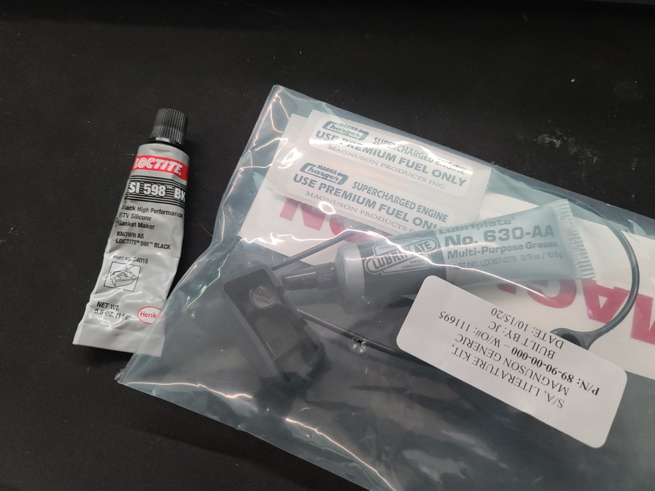

    Some of you are asking about a change in directions so I'm just posting here for reference.
    • On my kit, it came with Loctite 598 to seal the upper/lower manifolds.
    • It also came with Lubriplate No. 630-AA for pulleys.
    • Oil resistant silicone was recommended in step 92 when installing the pulley bolt.

    why would they ask you to put lubriplate on the pulleys. On mine it was for the hoses and orings

    My instructions call for the lubriplate to be used on the oem radiator to water pump hose and on the o-rings located on the CAC. Oil resistant silicone (specifically does not say RTV) is called for on the crank pulley bolt - do a search and tell me what you find that comes up "oil resistant silicone" that does not include the word "RTV." WTF !? I don't find it. Or is all silicone "oil resistant" ?? Of all the several hundred steps this is the only point of question. Why would you use RTV on the crank pulley bolt other than up at the flange on the bolt - I'd think the threads and tight tolerance would bind up in a heart beat - (Flange use was suggested by OpelGT - and seems like a sensible approach).

    They are talking about ultra-black for oil resistant silicone. I don’t know what they are on about saying non rtv silicone. There’s literally no other type of silicon sealant. Maybe they mean silicone grease like superlube idk.
    It’s just not a clear step for sure. I used none on mine and I’ve had no leaks. The stock one didn’t have any on it. I’ve never used it on a crank bolt on any car I’ve ever built a motor for.
    Its most likely for possible seeping through the keyway on the crankshaft because of a bad timing cover seal. Never seen that happen before (except on fords) but it is possible. I’m not worried. If it leaks it’s not hard to take off and fix.
    There is no oil in the crankshaft so putting it on the threads would do nothing but mess up the torque specs and cause it squeeze out and seal the flange anyway.

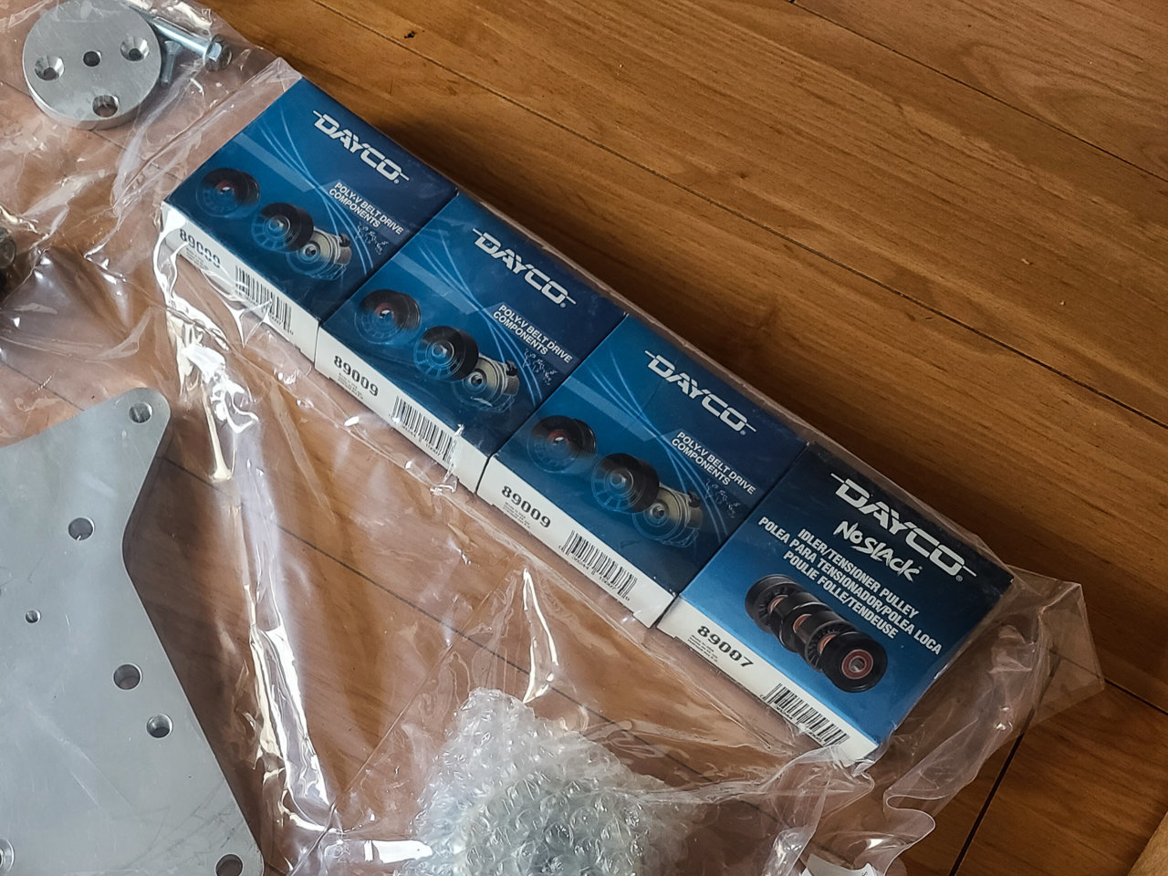

    Q2: Can I get a list of part numbers for the pulleys and drive belt.
    A2: 90mm supercharger drive pulley PN 57-03-06-090-BL QTY 1
    Supercharger belt PN 79-06-08-091(gates K060891) QTY 1
    Idler PN 56-50-47-001 QTY 1
    Idler PN 56-50-53-004 QTY 3
    Tensioner assembly PN 56-50-53-017 QTY1

    Do you have a photo of the part numbers of your plastic dayco pulleys. The part numbers magnuson have are in house numbers. It would be useful to have the actual dayco part no. I threw away my old boxes unfortunately

    So yesterday I sent a clarification request to Magnuson Support about installation process step 92 (Installation of the Crank Pulley Bolt). I questioned their recommendation for the use of "oil-resistant silicone" and the fact that unless you include the word "RTV" there is no such thing. Here is their response: "We mean RTV, we put it around the flange of the bolt/washer. I will get the instructions updated."
    I also received Tune Version 7 - so it looks like Version 8 will have the 4-5K rpm flat spot fixed along with some other improvements = all as noted by others in prior posts.

    Yes sir! Thankful for for all the megapixels on my camera.
    89009 - Belt drive
    89007 - Idler/tensioner pulley
