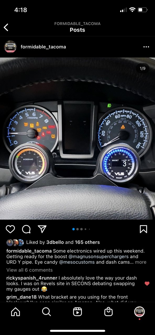

    Where did everyone tap into 12v+, Gnd, 12v+ ign only, and 12v+ headlights; for powering gauges? Not that it matters, but I am installing VLS Gauges sim to @reymataco, I think the color goes nice with the rest of the cluster, and I like that they have no buttons on the face, as I am attempting to install behind the cluster lens, we will see :fingerscrossed:

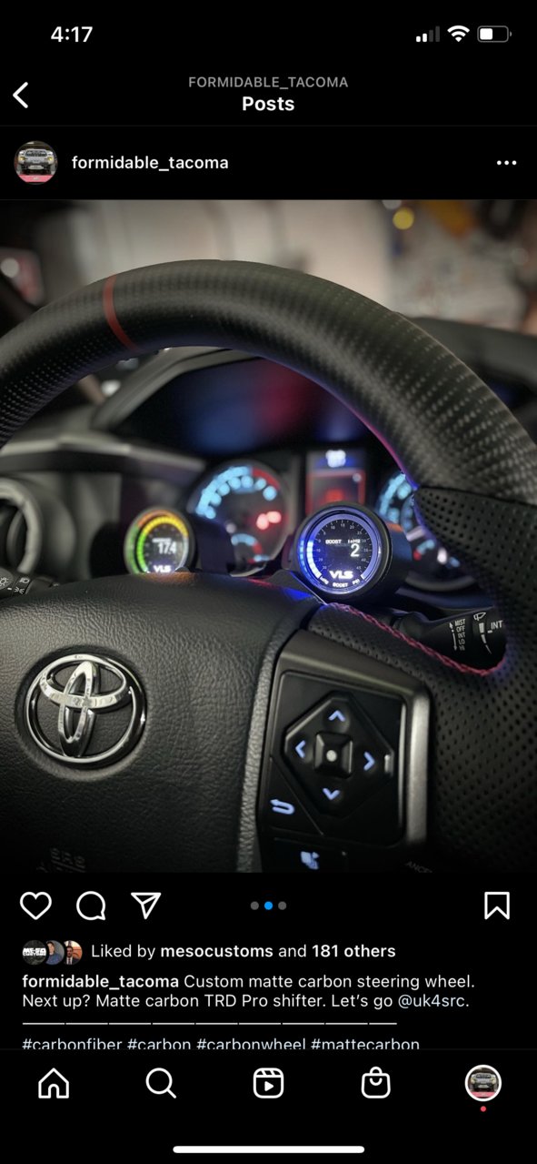

    Formidable
    Formidable Well-Known Member
    Jun 25, 2015
    #158158
    554
    2017 TRD PRO 6MT
    The Revel OLED VLS gauges are great. Matches the OEM cluster well and very easy to see in all lighting. Start up sequence vid is on my Instagram for those interested.

    Pinchaser
    Pinchaser Flipper Crazy
    Sep 6, 2020
    #339938
    428
    Alan
    2020 Tacoma ECU 04B82 AT
    @Formidable so you wired as directed, and the headlight circuit tells these gauges to dim? Meaning they do not dim with the instrument control, but you are happy with it.
    Interested to know where you tapped into the headlight circuit?

    Formidable
    Jun 25, 2015
    #158158
    554
    2017 TRD PRO 6MT
    I had them professionally installed by a stereo shop while I had other electronics wired up. I assume ignition. They do not dim.
