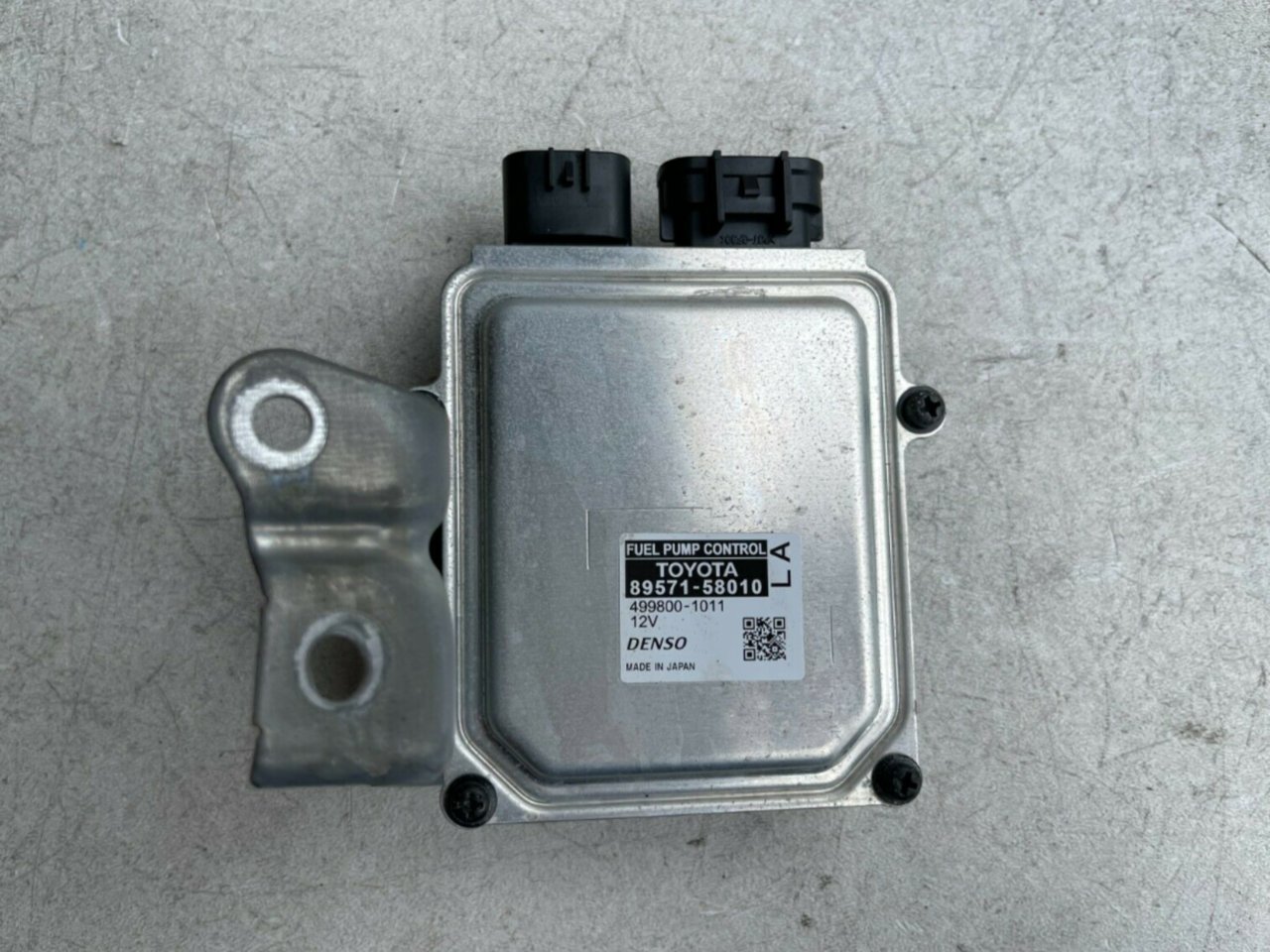

    The V35 comes with the 89571-58010 FPC. It also comes in some 2GRFKS cars... it would be funny if it plugged in and away we go with PWM... but I'm not holding my breath.

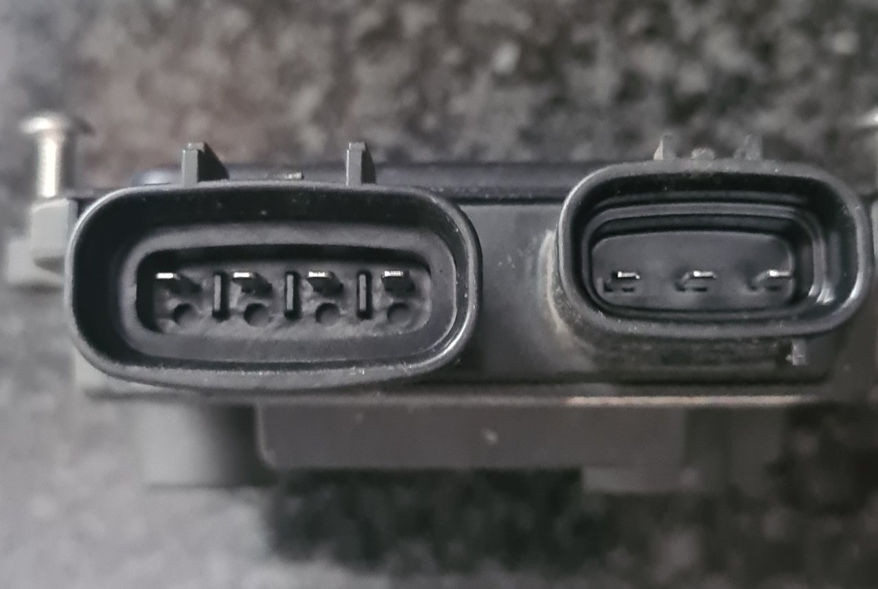

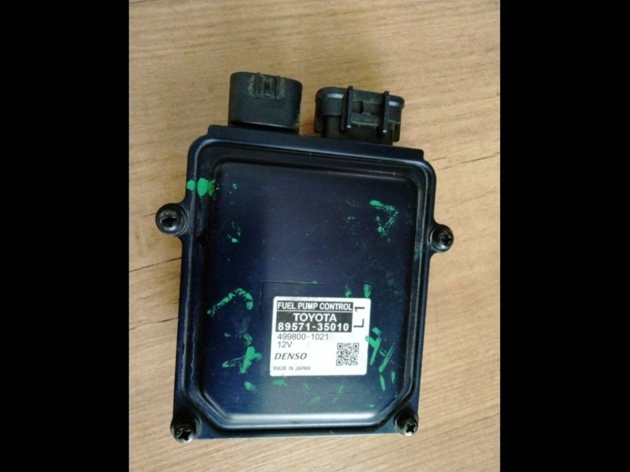

    Connectors look the same at least. I wonder what the pins look like. I would guess that the v35's has less than ours.
    You never know though, it might just be that simple. If all of the fueling logic is in the FPC and not the ECU than it might work. Likely the FPC is getting info from the ecu about current fuel pressure and demanded fuel pressure then the FPC uses it's own logic to command the pump.

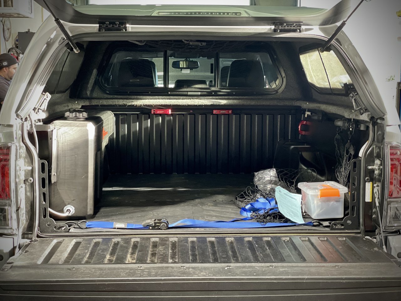

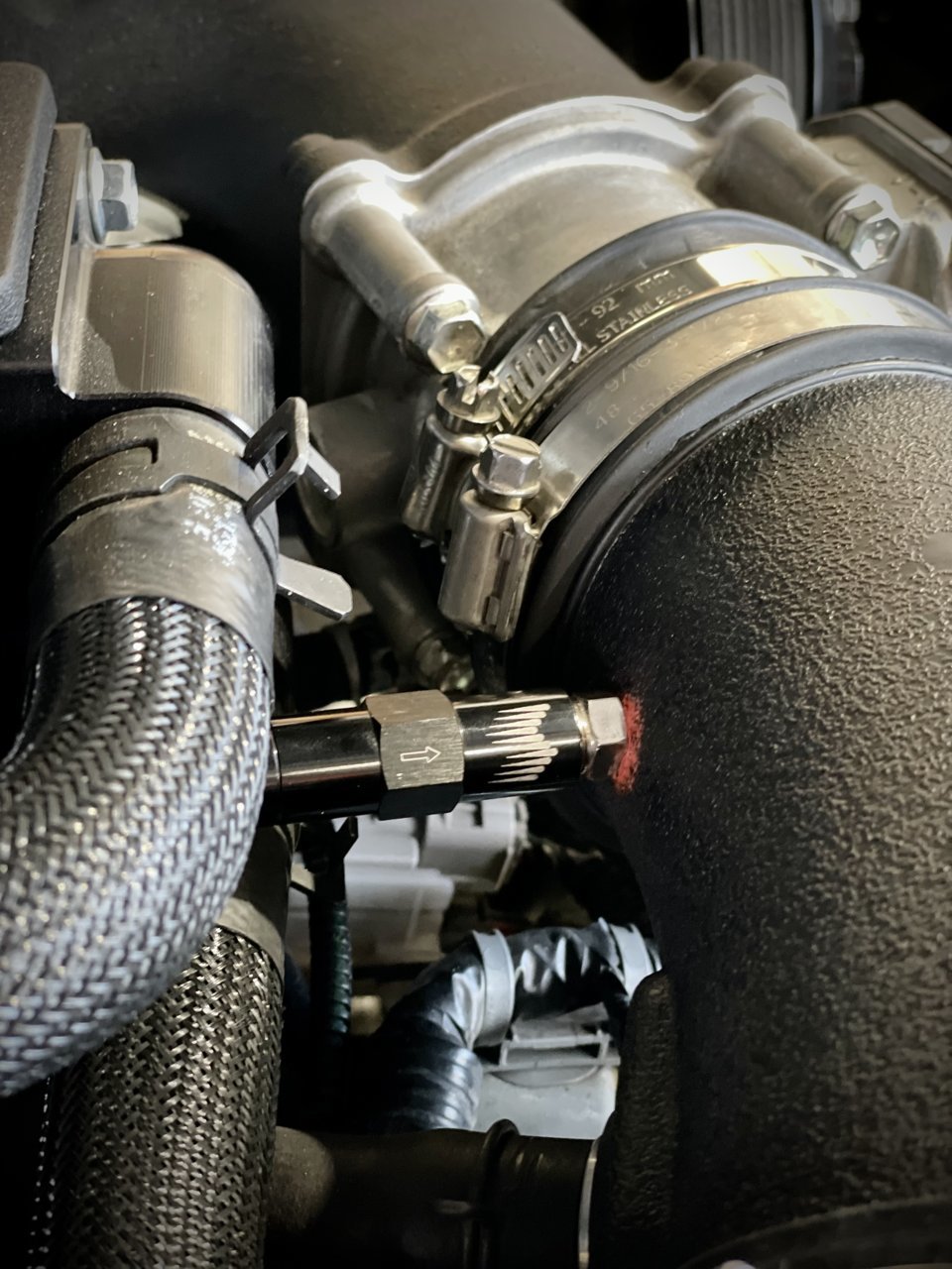

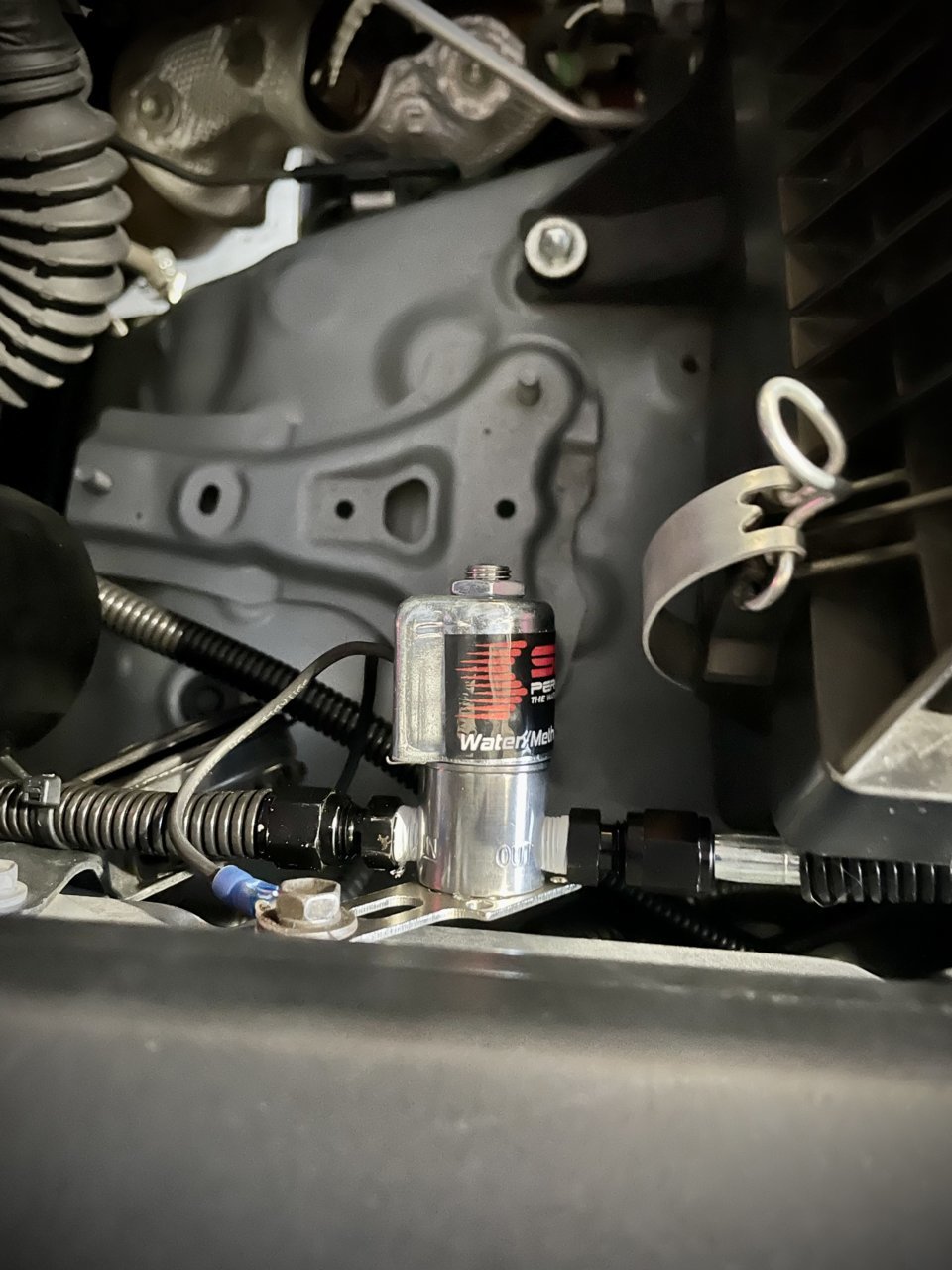

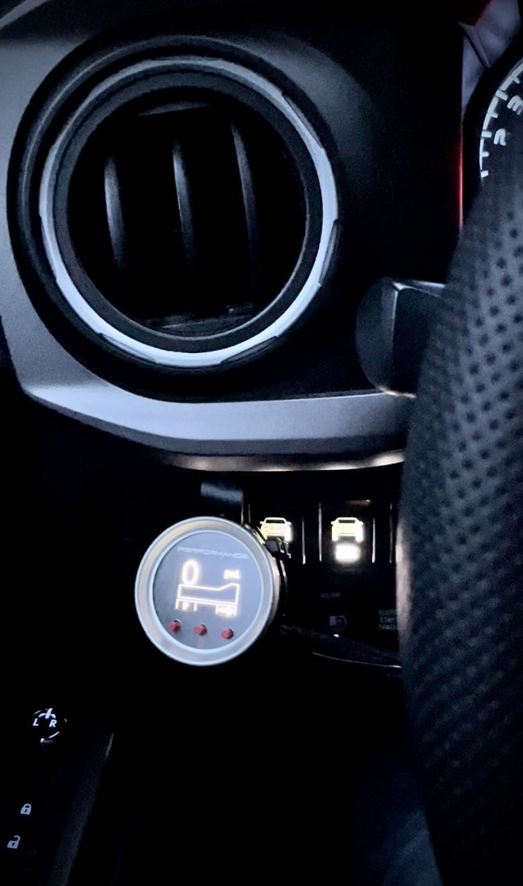

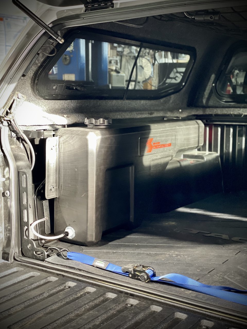

    Snow performance boost controlled water/methanol 2.5 proline kit with 9 gallon rear reservoir and vacuum protection solenoid installed at Intecracing in Kent, WA. Having some issues with the gauge controller.
    You certainly don’t need the 9 gallon reservoir. I might downsize later. I just hate refilling fuel tanks more than I already do lol… Also can prob mount the tank on the passenger side to balance the weight better since fuel tank is on the driver side. But then it blocks the electrical outlet plug. Once we get this gauge controller ironed out will see what we can do with advancing timing and boost with the 84mm pulley.

    @Formidable Where are you injecting, is that pre-throttle-body?
  17. May 16, 2022 at 10:42 AM
    #2497
    Formidable
    Formidable Well-Known Member
    Jun 25, 2015
    #158158
    554
    2017 TRD PRO 6MT
    Pre throttle body intake pipe.

    AnotherUser256
    AnotherUser256 Well-Known Member
    Feb 23, 2018
    #245351
    167
    Magnuson TVS1900 Supercharger with 87mm pulley, Catted OVTune dumptubes, Doug Thorley 2.5in y-pipe, custom mufflers, 76mm Tundra throttle body, 5.29 Yukon gears, JamesT custom fuel rails, Yotawerx 87mm tune, Eibach Pro Truck Stage 2 suspension. And some other stuff.
    Awesome. I look forward to the outcome of this.
    I am guessing you aren't too worried about the meth going through the SC? I understand that Magnuson doesn't recommend it though I have seen multiple forums where people are already doing it without issue.

    I can understand Magnuson's reservations, if the water is not completely vapor before entering the SC, water droplets definitely can do damage. My dad had an amphibian airplane with a pusher prop, and water spray put noticeable wear on the prop blades.
    In perspective, we are shortening the lifespan of our engines by the increased performance of adding boost, (largely considered increased wear) and that is deemed acceptable. Adding performance by water injection may decrease the lifespan of the SC (and the engine a little more again), but again, it might be worth it.
    Water injection may result in higher boost from the same pulley. Just thinking that the spray will cool the intake charge, before feeding the compressor, and a denser air charge entering should result in greater pressure output. Though pre-compressor also has less heat available for atomizing. Interested in seeing how this plays out!

    Formidable
    Jun 25, 2015
    #158158
    554
    2017 TRD PRO 6MT
    Magnuson doesn’t recommend it. However, in chatting with several tuners, apparently water/methanol injection when used with roots style positive displacement blowers is fine. Does nothing to the rotors and seals and may even prolong the life of the supercharger due to significant heat reduction. Granted you’re not pushing the spin limits of the supercharger. On turbos or centrifugal superchargers, should be done post turbo. If you inject preturbo, that has been demonstrated to corrode aluminum fins, degrade oil over time and is not recommended.
