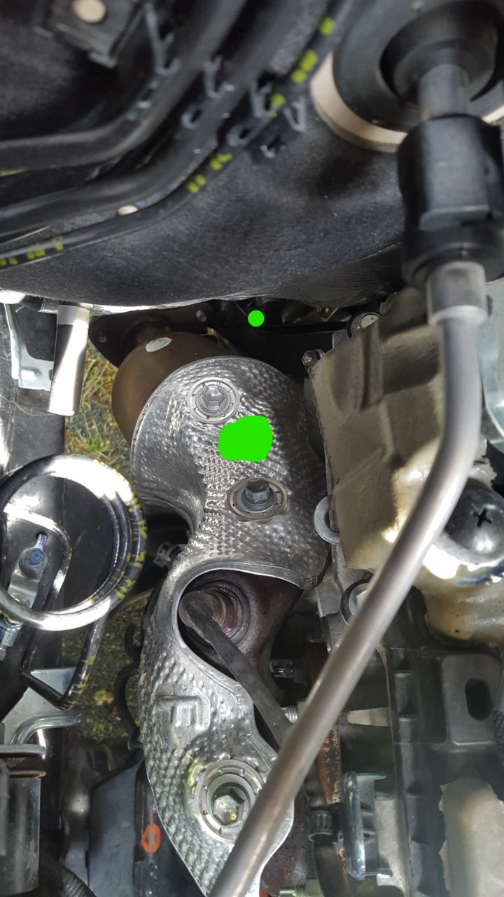

    For the guys that installed and air/fuel gauge where did you install the bosch sensor? I have a revel VLS guage and it says to install upstream of the cat. The cat is part of the exhaust manifold and does not look like there’s room to install. Pictures would be awesome. Thanks

    I installed a new Y-pipe with an extra bung.

    It must be installed pre-cat, for the readings to be meaningful. I installed it on the passenger side, between the existing Toyota one and the top of the cat. Appears I do not have a picture, but i marked this one where it is welded in, just cut a circle in the shielding for it and put the shielding back on after.
