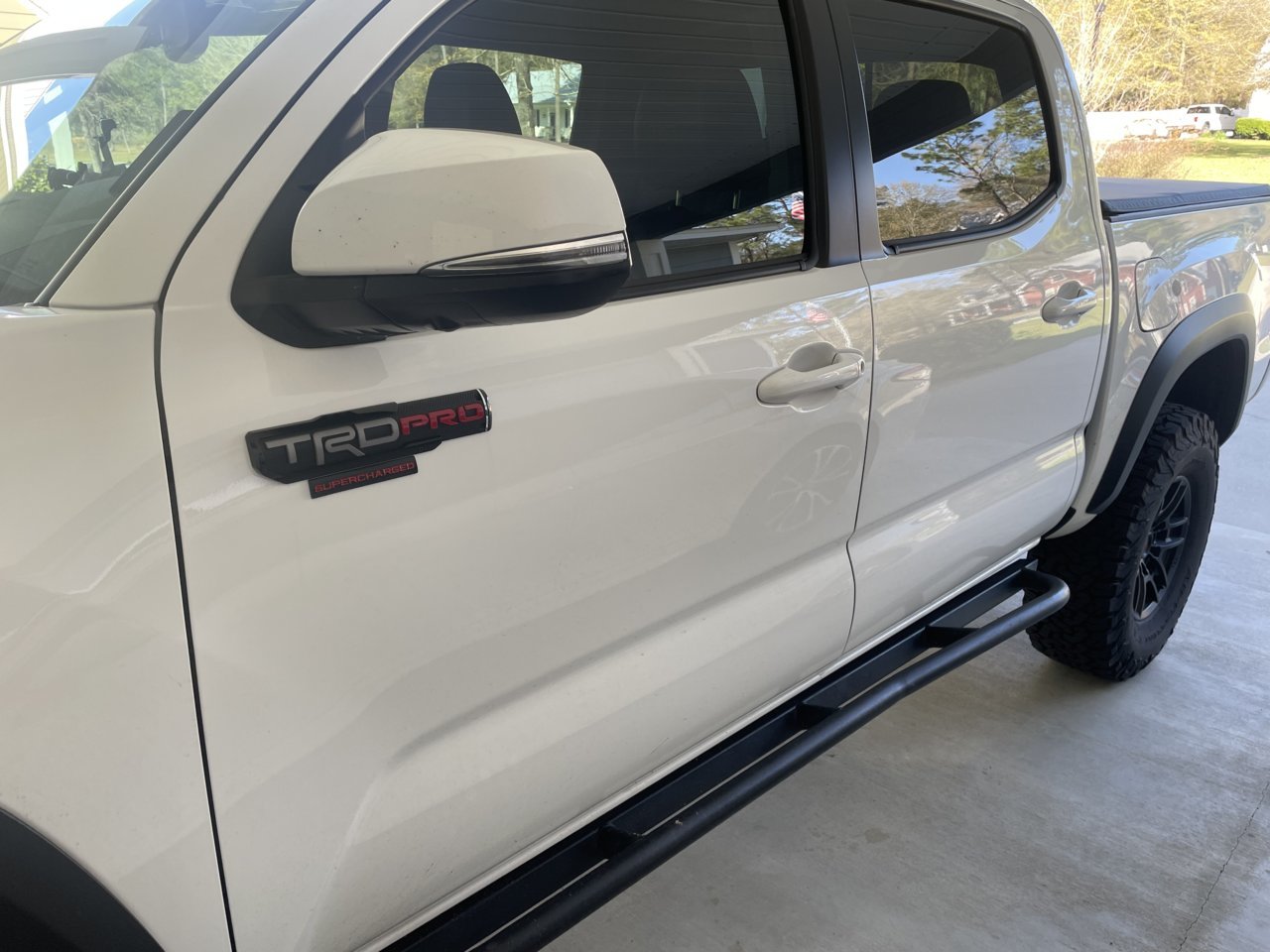

    I had these on my truck for about an hour, made it look too busy in my opinion. Got them on Amazon.
