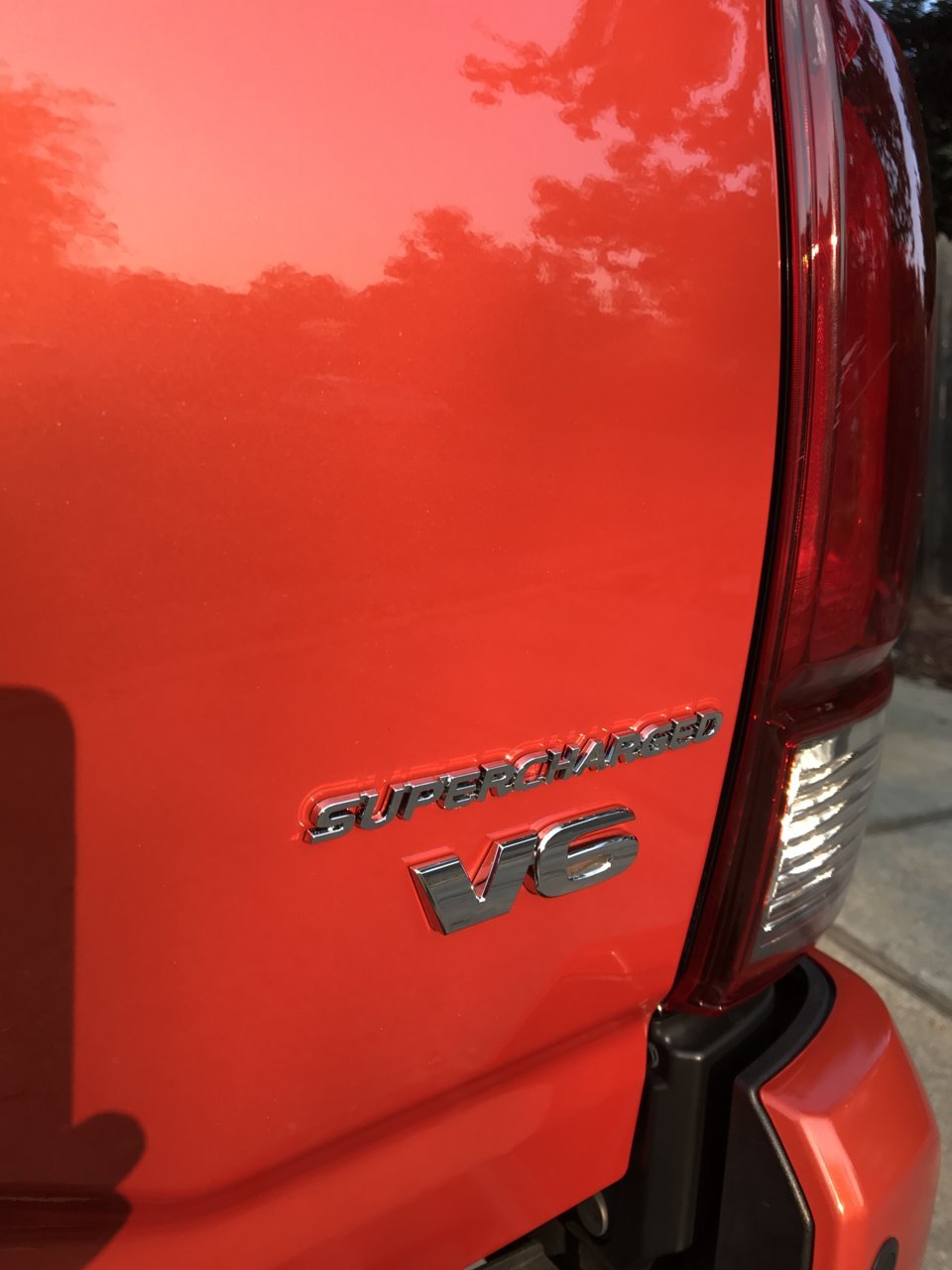

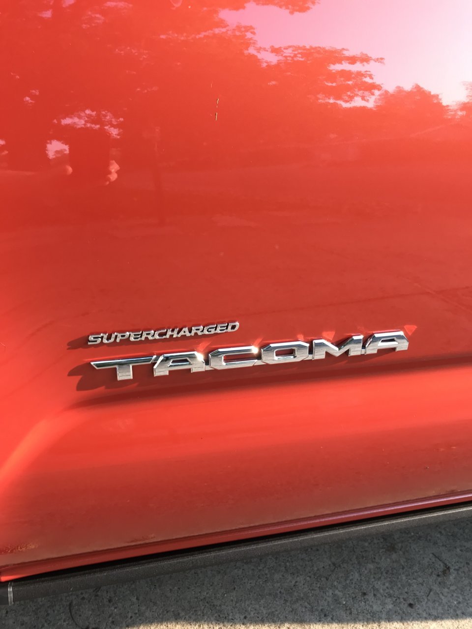

    I use these emblems.
    792A2112-17B0-4C81-A147-B22593145867.jpg 181FBCAE-88F8-46F9-9CFC-816775FF391E.jpg

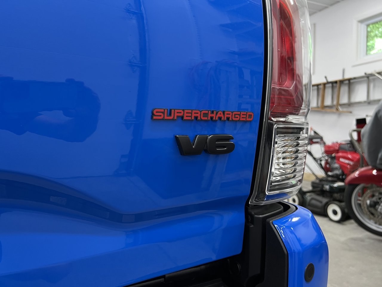

    I like those also. Although I’d need black to match my blacked out emblems and I’m not sure they’d look as nice as your chrome.
    I came across these last night. They appear to be American made too.
    https://emblempros.com/inc/sdetail/66033
    And I thought my truck was DONE after just flashing the Stryker tune. LOL

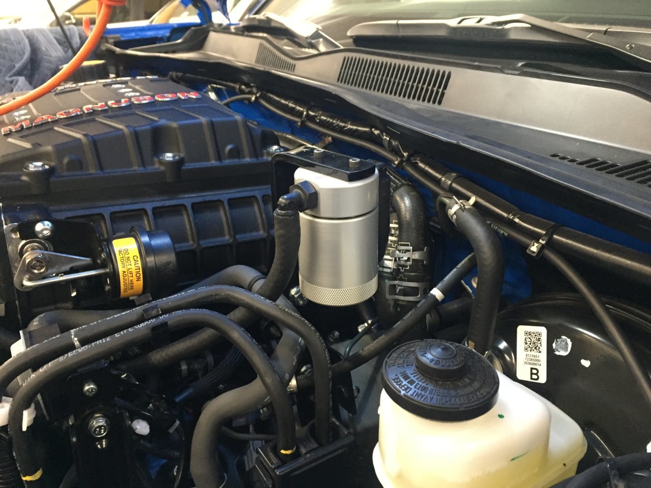

    That is the catch can I have. You will need to modify the bracket a little with a SC setup. The original mount point is removed during the SC install (If I remember correctly). I have had good luck with that catch can. It definitely catches some oil, Probably only need to clean it out every 3 months though I still clean it out once a month. I opened up the SC a month ago to do some other work and there was no oil residue anywhere so after 5K miles so I would guess it is working pretty good.

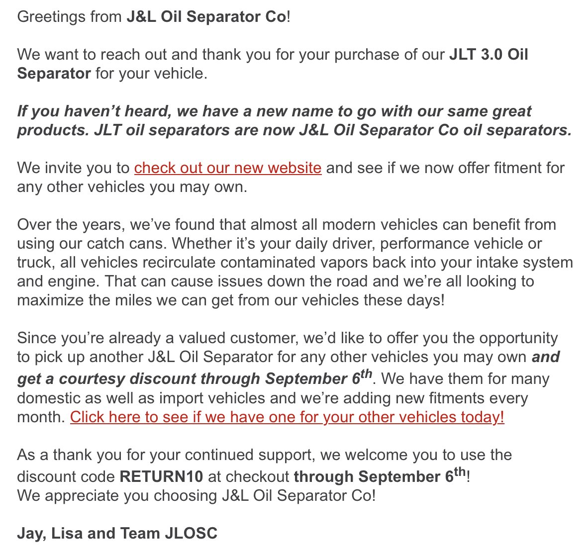

    same company, just changed their name. I got an email about it a couple days ago

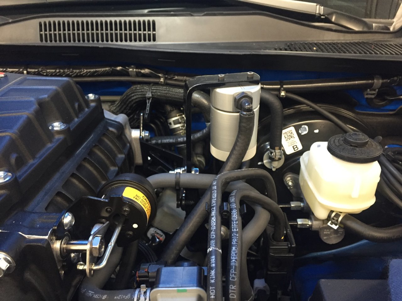

    I went to the hardware and picked up a length of 1/4” x 1” aluminum flat stock.
    Easy to bend and still pretty rigid. This allowed me to get the catch can up higher to make it easier to empty.
    940BFBBC-2C34-43B2-81FA-3FED4625CECB.jpg B4B00754-D1EE-408B-A75F-33A532D52C39.jpg
