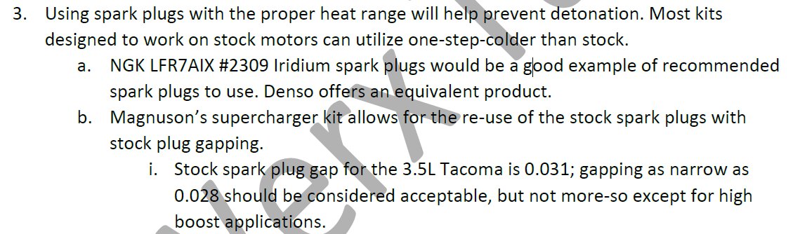

    Random Misfire ---- Colder Plugs?
    Occasionally getting a random misfire that is putting the truck in limp mode. I pull over and turn the truck off and back on, it then runs and drives fine. Its not specific to a cylinder, i have pulled all the plugs and everything looks fine. I know on older model tacos I would run a colder spark plug on supercharged trucks. Has anyone done that on these 3rd gens?
    Cheers

    I'd recommend one step colder plugs regardless of having issues or not.
    I ran them on my Twin Turbo set up for my 3rd gen when I had it.

    Do you know a part number for a one step colder plug for these 3.5's
    thanks

    Give me a few mins so I can get to my laptop and reference the ones I had/what I recommended in my tune guide supplement. They were NGKs
  7. Sep 26, 2022 at 11:19 AM
    #2727
    mZiggy
    mZiggy Honey badger
    Apr 8, 2017
    #215707
    4,709
    Marc
    2020 MGM Tundra SR5; 2020 4R TRD Pro; 2008 4R SR5 v8
    here's what I have in the document that I provide to all YotaWerx Stryker tune customers:
    0.030 is a solid middle-ground gapping that I frequently recommend to people who ask

    Right on! I really appreciate it!
    Thank you!
