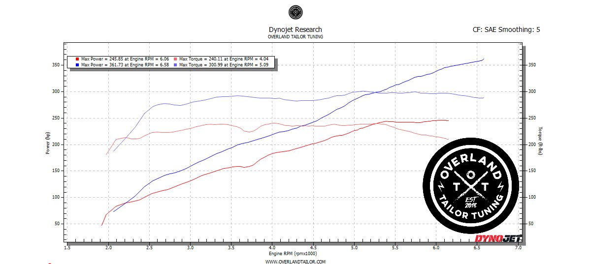

    OTT is releasing calibration support for the 2016+ 3.5L Magnuson Supercharger kits.
    Smooth and predictable output and refined shift scheduling make this a dream to drive and a blast to rip on. Building on our past experience tuning boosted Toyota's we are finally able to offer our work for the 3.5L boosted crowd. Years of development of the 1GR-FE and 3UR-FE/FBE engines have left us hungry to explore the 2GR-FKS potential with forced induction. So hungry we purchased a 2022 Tacoma TRD O/R as a development vehicle with the intention of putting this kit on and developing the standard kit on a 100% stock truck (as we have dyno'd below) to offering additional pulley support and other modifications to improve the breathing ability of this motor. As we develop the platform further you can expect 87mm and 84mm pulley support and fueling solutions to tackle the added fueling demands the additional airflow will require.
    For now, we're pleased to present the results of our "stock" supercharged calibration:
    Versus the same truck bone stock:
    *All runs performed on 91 Octane fuel from a Tier 2 gas station. Truck is 100% stock aside from the Magnuson kit installed as supplied.
    Our S/C calibration is $400 for anyone (should be everyone since the kit comes with a VFT Kit) able to load their own flashes. We can, if needed provide remote assistance. Please email info@overlandtailor.com for more information on that service or for general inquiries.

    Those numbers are really good, at the risk of sounding like a douchebag...a little too good. Is this truck manual or auto? What gear are the pulls done in? If auto are you using gear lock? Yotawerx makes 55 less HP than your dyno shows, with the same brand dyno and he's just about at the limits of the fueling system, I couldn't imagine another 55hp on the stock fueling system...

    For the record, we ended up not being at the limits, we found more fueling available and are using it for the smaller pulleys.

    I welcome the question(s).
    I cannot at all comment on how/why our competitor got the numbers they did. They closely guard their IP just as we do.
    I can say this isn't our first rodeo with forced induction on the Toyota platforms, or in general. I've personally been tuning forced induction vehicles since 2000. We're well aware of what it takes to make a GR series motor work under pressure. We've tuned about every combination of forced induction known to man on the 1GR on stock motors to 4.4L stroked and cammed motors with pullies of all sizes. We've tuned Class 7 trucks with custom turbos, Xrunners that push the boundaries of every mechanical limit. We've done 500whp Tundras and more. I feel confident that we have more forced induction Toyota 3rd party tuning experience in the industry than anyone.
    Our 2022 truck is an Auto and all pulls (NA and SC) were performed gear locked in 3rd gear. Our runs are SAE corrected per industry standard. Fuel utilized is 91 octane (tier 2) from the Maverick Gas station near the dyno facility.

    I hope you don't take my response the wrong way. I have virtually zero tuning experience, only a slight understanding of all the time and effort put into it. Just wondering what makes your tune stand out from the rest, that's all. Any reason why you used 3rd gear instead of 4th? Just genuinely curious.

    All 100% valid and worthwhile questions. No offense taken!
    The wheelspeed in 4th would have been FAR EXCESSIVE and dangerous actually. The tires are not rated for that speed. We're talking 150+mph maybe? I'd have to do the math..

    I do most of my driving between idle and 4500 rpm. Big number are just that - but I don't drive or need to drive at 6500 plus to make usable horsepower. Impressive but not what I use my truck for. Nice job though. I will stay the course with @mZiggy and the YotaWerx Stryker Tune. Maybe Magnuson will wake up and figure out they poked the pooch on their Tune - not likely but that is the CARB world we live in.
