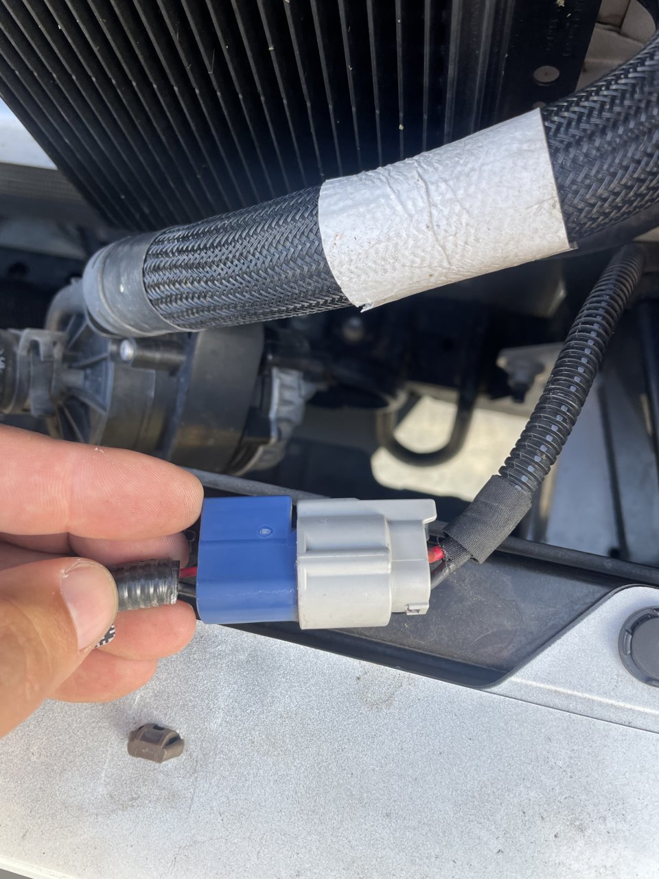

    Just a heads up I’ve had my SECOND coolant pump failure as of this morning. I don’t post much here, but I do read a lot. Make sure you’re keeping an eye on intake temps, or check the flow every once in a while.

    Same here. Installed the second warranty pump yesterday and the system still doesn’t work.
    Digging into the electrical side now to see if there is an issue with the harness.
    Magnuson is telling me to keep vacuum bleeding the pump/system as it’s sensitive to air.

    I went outside and grabbed my harness and the pump came on. So, it’s definitely in the wiring. Going to dig into it more this afternoon.

    My issue is the harness. I ran some spare wires I had in the garage from the battery terminals straight to the pins on the pump and it fired right up.
    Trying to get a new harness sent out to me.

    Mine is also the harness. It’s the plug that plugged directly into the original pump. The new pump they sent had a different connector, and they supplied a pigtail adapter, but that original connection is what is bad. I cut that original connector out, and spliced the “new” connector directly the the harness and all seems good. Just deleted it all together.
