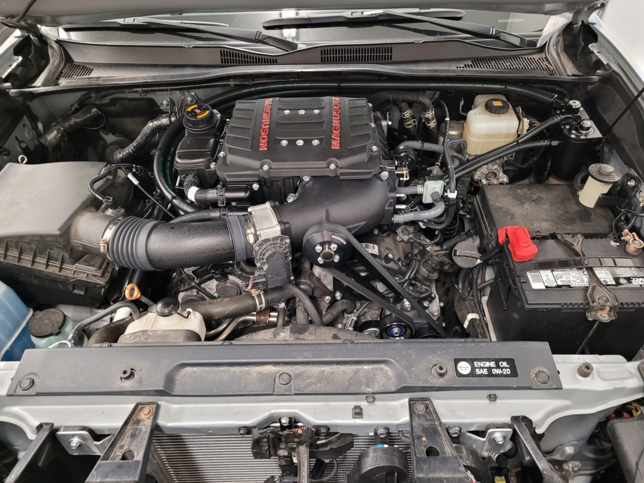

    Finally getting around to posting after my Magnuson install. A buddy and I did it in my garage in about 12 hours. The directions are solid and everything went pretty well - the only minor hiccup was needing to run out and get a Dewalt XR Impact Gun in order to get the pulley bolt out, as my air impact didn't have the torque for the job.
    I did have a check engine light after doing all the leak check runs. Turns out the IAT sensor had failed. Magnuson was great with the warranty request and sent me a new IAT harness and sensor - was a quick replacement and that took care of the problem.
    I decided to go with OTT for the aftermarket tune. It only takes a small amount of driving the truck with the Magnuson calibration to feel it's severely lacking and that the S/C is capable of so much more.
    The OTT tune has been fantastic. John from OTT was great to work with and even sent me 3 tunes, so I can load a more aggressive tune or keep it a little more mild. I ultimately went with the middle of the road one which has been perfect. Great low end torque, superb and smooth power deliver from the S/C and greatly improved throttle response. I used to feel like it was painful to rev the truck above 3k rpm - now it feels like it wants nothing else. John also had me take some logs after first loading the tune and he verified everything looked good - was nice to have that piece of mind.
    Like many have said with any of the aftermarket tunes - it is truly a whole new truck. My truck is a MT and with this tune and S/C its far easier to take off in second gear as the improved low end torque gets the truck moving much quicker and then suddenly the S/C kicks in and off you go! I would often skip a gear when accelerating when normally aspirated - now I find myself skipping two or even going from second gear to sixth because I'm already doing 60+. It's a hoot!
    I don't need to downshift on hills nearly as often. Even at speeds of 45mph in fifth gear going uphill, I'd sometimes have to go down to 4th or accelerate a few mph above 45 to maintain speed up the hill - not anymore. RPM is pretty lower at that gear and speed and the tune and S/C have greatly improved that.
    My fuel mileage has been surprisingly good. I did an hour+ drive not too long ago on 55mph roads and got over 20mpg (stock suspension and wheels). That MPG seemed pretty much on par with the same trip normally aspirated. My commute to work is 9 miles and is a mix of city/highway. I'd say I get similar fuel mileage compared to before the S/C and tune - it might suffer a mpg or two only because it's just too much fun to rev the truck up.
    It took me awhile to commit to the S/C, I had budgeted for it and debated for a couple years whether it'd be worth the cost. I'm very glad I decided to pull the trigger. What really helped push me over the edge and finally purchase it was the aftermarket tuning and what the future will bring with smaller pulleys and fuel upgrades.
    I'm definitely looking forward to pulling my Geo Pro camper with the truck this spring.
    - Jeremy
