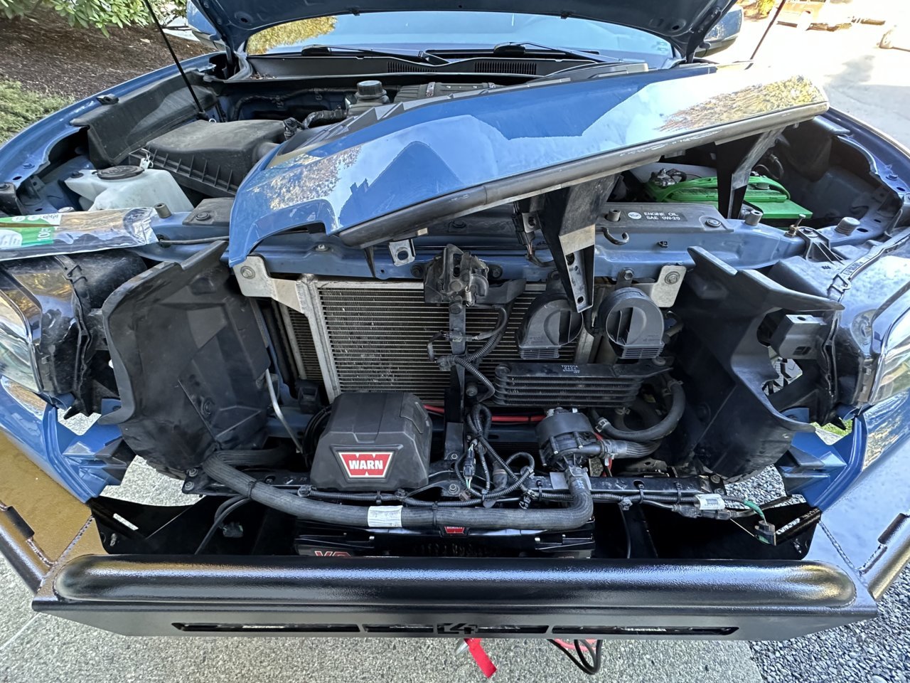

    I have the C4 hybrid bumper with a winch. Just need to move the coolant pump a few inches to the right and extend the hose. No other issues.

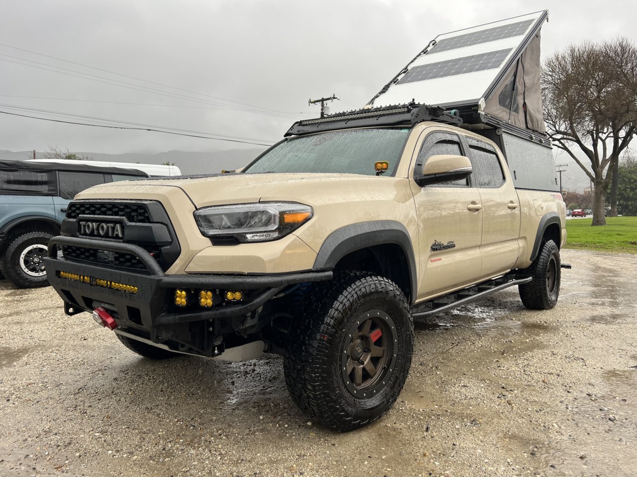

    I am, it’s fine, i have 20k miles so far so good. 64569F43-7E9C-4625-8279-569E179BDA90.jpg

    Figured I’d add a pic of my relocated water pump from doing my bumper/winch install. Was able to bend the bracket and move the mount onto the lower trans cooler bolt. No cutting needed and the pump clears everything around it. E1ADEF71-64E0-487E-B711-30C92910246B.jpg

    That’s exactly how mine was done by Toyota of Oxnard.

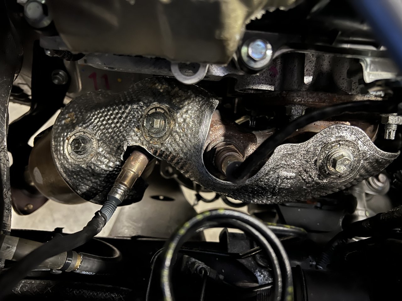

    I'm getting ready to add an O2 bung. Are the 3rd gen exhaust manifolds cast steel or stainless tube? Any tips to help with a clean install?

    I did the same as @Kruuuzn except mine is more vertical,above and between the bolts for the heat shield, as seen in his picture. Is stamped formed sheet-metal, not even tube, but welded easy enough.
