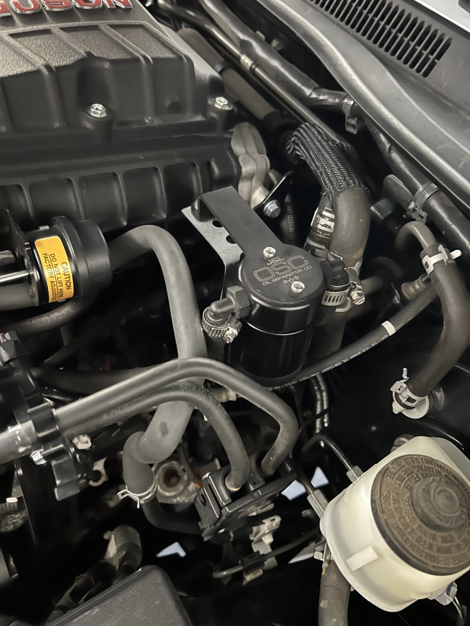

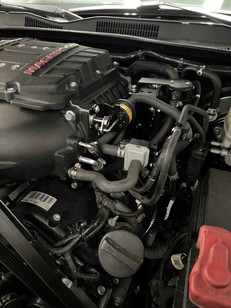

    Looking for any thoughts on an issue I've had the last few months. After driving, I get the smell of fresh oil after the car is parked in the garage / doors closed. Like, if I come back in the garage after a few hours, it's very distinct.
    I can't pinpoint where the smell is coming from, so I've done everything I can think of: hose clamps most everywhere, including all 4 hose points on the catch can hose routing (which does not seem to be the source of it, as when I empty/clean it and drive, I still have the smell after; it seems to seal very well). Filter is tight. I'm not losing any oil that I can tell. Zero leaks anywhere I can see. Oil cap seems to seal fine (though replacing it is probably my next try). My only mods in the engine bay are the supercharger and catch can.
    Anyone experienced anything similar, or have any other ideas to try? No check engine lights, gas mileage is fine, no consumption, no drips or leaks I can tell, but the persistent smell is driving me nuts. It's distinctly the fresh oil odor, not burned, not gas, etc.

    looks too clean for something under the hood or SC related. Nothing at the oil pump or filter cartridge? Look at the diff's and around the spark plugs (you recently had them changed ?). If all else fails you likely have a two-stroke yard tool or lawn mower in the garage experiencing expansion from a southeast exposure and sun warming! check the catch-can to see that is working - should have little (oz or so) of fluid in it if you are less than 5k on change.

    Yeah, there's nothing around the filter/pump or on the diffs or cv boots. It's definitely the car and not a mower or yard tool. It's a mystery!
