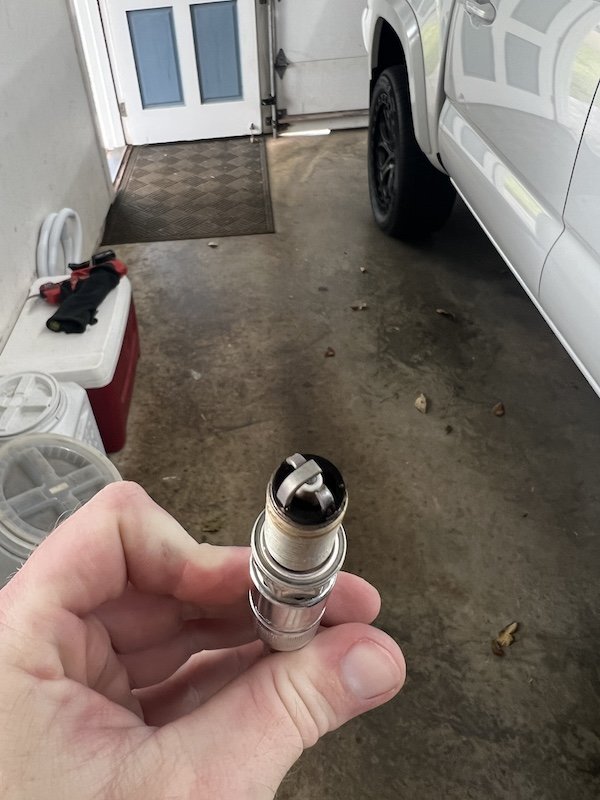

    I'm having a misfire issue going on with my truck. Went out Wednesday and on my way home going up a hill in 4th gear 70ish mph check engine light came on flashing had to pull over engine was shaking. Restarted and was able to continue on my way home. Scanned and got p0300 for random misfire, p0300278 (emissions) signal rate of change above threshold, p030085 (over temperature) signal above allowable range. With a scan tool hooked up and viewing the live data I'm seeing misfires happen with all cylinders randomly when driving. Within 1/2 miles from my house it will show. I can even just be revving it parked and it will also do it. Truck never showed any signs the last 6 months, and for whatever reason it was bad enough to get the light to flash and come on the other day.
    I've had the s/c installed since oct 29th of last year. Truck only has 1900 miles s/c has been on for 1300 of those miles. Is is possible that the tune from Magnuson has an issue?? I'm planning to call them Monday and see if they have an ideas. I've also been wanting to get the OTT done but have just been putting it off.
    I have pulled plugs and swapped some around no difference. Here's what one of them looks like. IMG_0956.jpg

    I test engines (not Toyota) and almost always the cause of misfires is related to fueling or air, especially if the tune has worked in the past. There's a chance it could be a leak too. No harm in calling Magnuson but I would also check for leaks or any issues with the fueling system.

    I figured out it was the Magnuson tune. In the tune it had the wrong tire size and rear gear ratio for me (previous owner I guess?). I asked Magnuson for an updated tune and it has been fine ever since. Still going to get OTT though!
