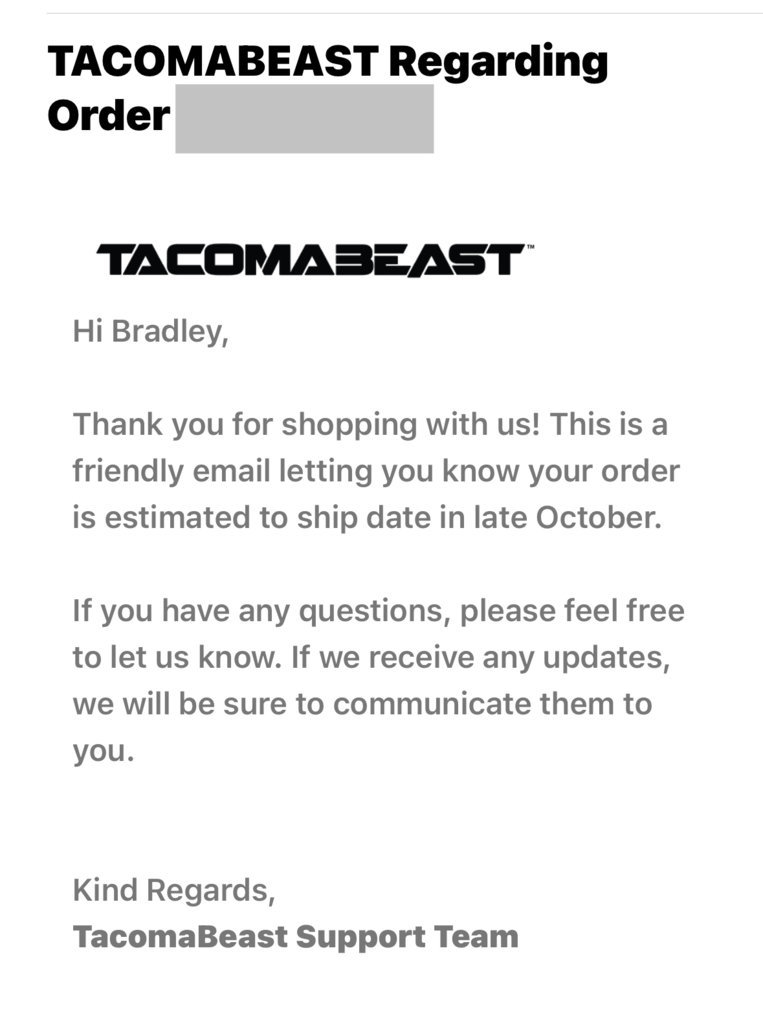

    This was a few days after my order so I’ll just have to be patient.

    Lesson learn. Never buy from Tacomabeast. All the homies say so.

    I just can’t believe they don’t stock the kit. A lot of their competitors do and they offer free shipping.

    my kit came from Ventura Ca so direct from magnuson. Im guessing yours will also.

    Yeah I’m pretty sure that’s the case. To be fair to Tacoma Beast they made me acknowledge the wait time, which I did. I had just hoped where I tried cancel my order so quickly they would let me. It sounds like it’s a Magnuson policy not theirs.

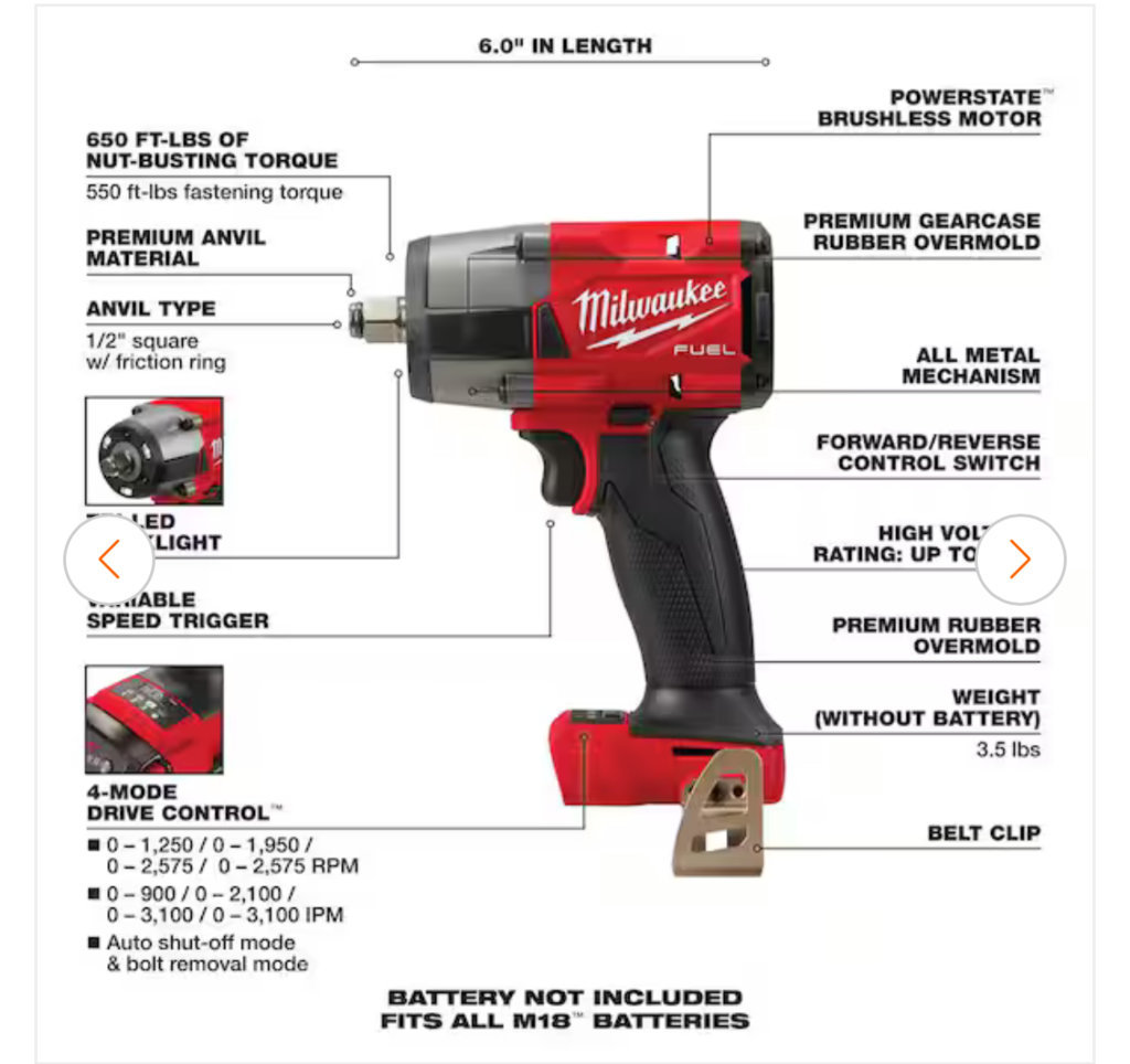

    I am ordering a new impact in preparation for the crank bolt. I’m looking at the 1/2 mid torque Milwaukee. Do you think that will be enough? It’s fairly compact and has 650 ft-lbs of torque.

    I recall the crank bolt being the only thing that really got me hung up. I think I eventually used my pneumatic gun to get it off because my Milwaukee wouldn't fit. But this one looks more compact. Worst case you go big ass cheater bar.

    I’m a dewalt garage, but I used a DCF900B for mine, worked fine.
    small tip, you will already have the bottom radiator hose off by the time you get to the crank bolt. If I were to do it again, I’d pull the radiator from the get go and make life on myself easier. In the end I upgraded the rad anyways, but even if keeping it I’d pull it for the install.

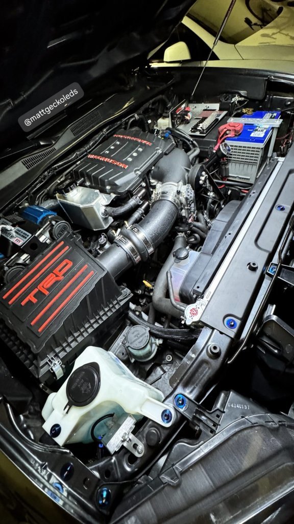

    Late post, but it’s been installed since May. Went to OTT and loving it! Debating on smaller pulley

    This will do it no problem.

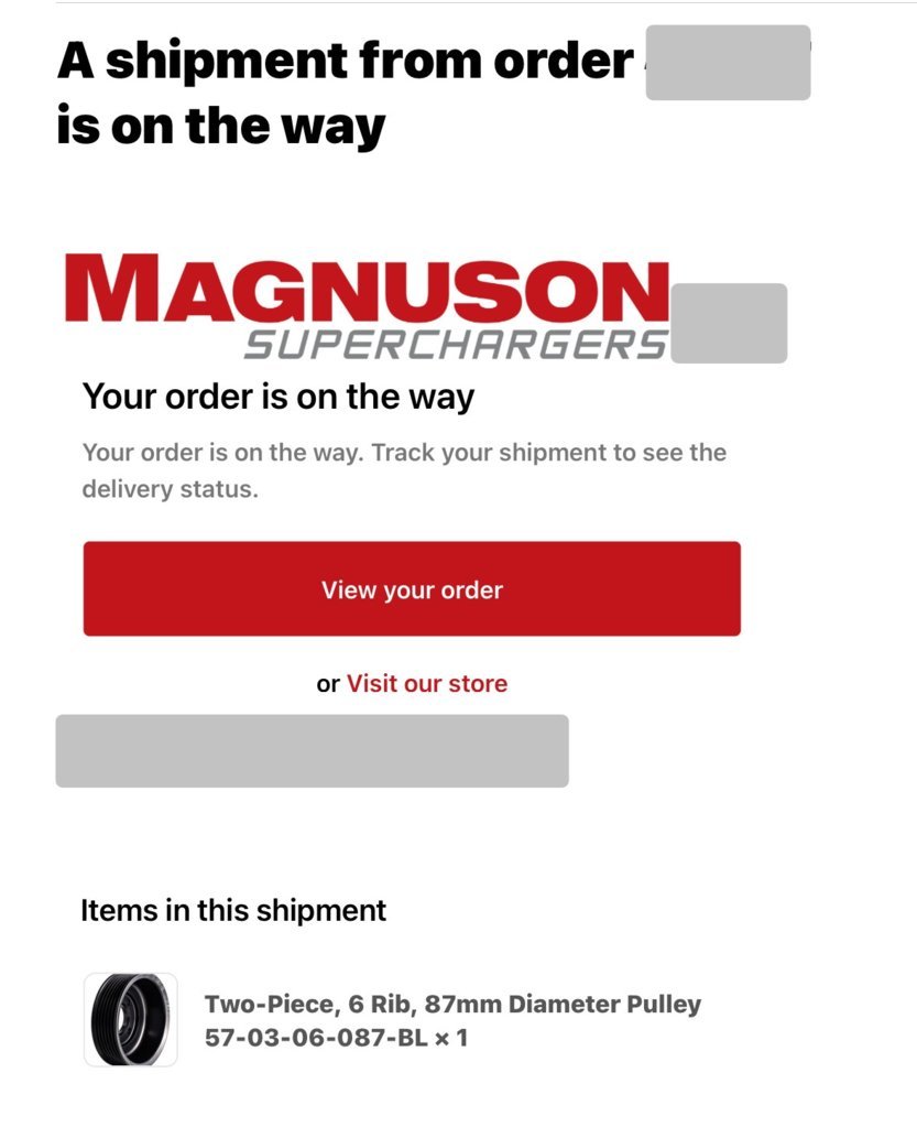

    I was so excited when I got this email notification and then I realized it was just the pulley and not my supercharger haha.
