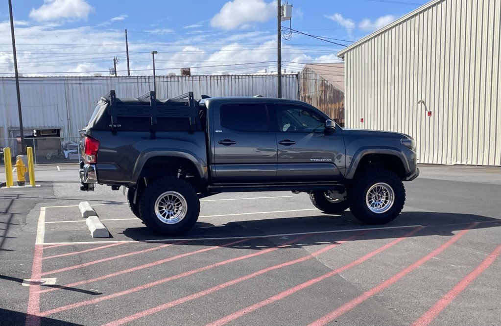

    It’s great, had a custom tune initially since I bought my kit used. Did a few runs in the dyno, but was not happy with it. OTT is great with my setup. Great dyno and immediately felt the noticeable difference compared to my first tune. Power curve is very linear and aggressive. I also removed the restrictor valve.
    - 4.88 Yukons
    - 33’s
    - loaded with a bit of weight
    OTT you can’t go wrong. plus, they are working on carb legal for their tune soon.

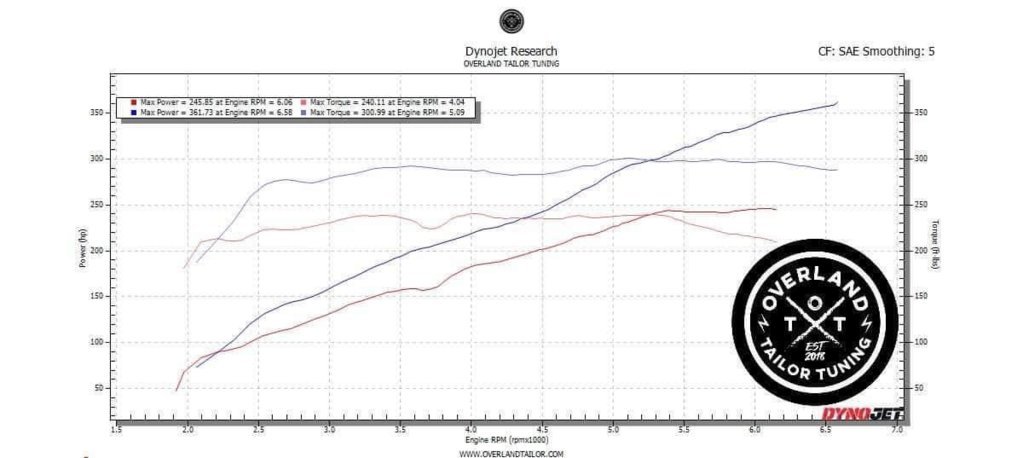

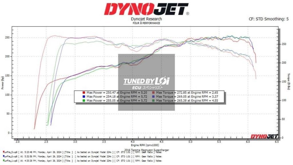

    Dyno only on my first tune. But as you can see from the first chart, it was a bit bouncy.
    Changed to 1 step colder ngk and retuned to OTT 90mm pulley tune. Not my dyno, but this was off a stock Tacoma with the maggy.

    yeah something’s definitely up with that first tune.
    I'm not doubting OTT’s tune, but damn that’s an absurd amount of power difference!
    Do you feel like you’ve gained that much more?

    Hard to say without a dyno. But definitely was a huge improvement. First tuned, I wasn’t impressed at all. Very underwhelmed with the maggy. New tune, totally different truck. Fell in love with it.

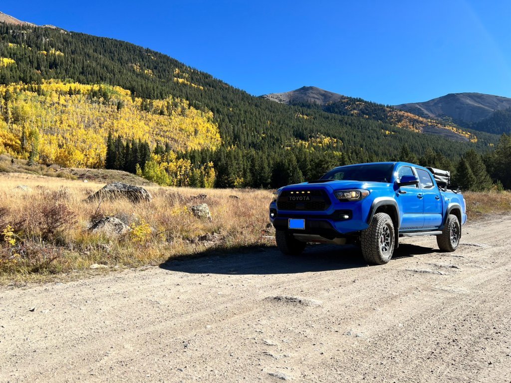

    I think on Monday I’m going to finally pull the trigger on this kit. Will likely order from R4T and have them do the install, if anyone has any experience with them I’d love to hear about it!
    I’ve been on the fence about getting a supercharger for a while. I’ve got a 2019 TRD Pro AT running 5.29s, 265/74/16s, and the NA OTT.
    5.29s alone were so underwhelming to me. I actually kind of regretted doing it until getting the OTT tune. Before OTT, I could feel some added lower end torque, but shifting was still wild and inefficient. OTT made me love driving the truck again (except for mountain passes). The other Colorado and mountain region Magnuson users in this thread have helped me see the light lol! I’m hoping the that the SC+5.29s+OTT will be just as impressive as when I did the NA OTT with 5.29s.
    @JustDSM is there typically any discount for NA OTT users who switch over to the SC tune? Likely varies by your installer, but haven’t heard from my guy over the last week.
    Pic for fun
