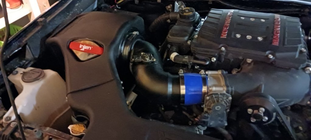

    Does anyone have that Injen intake elbow that guy was making?
    Speedbird and tcaustin like this.
