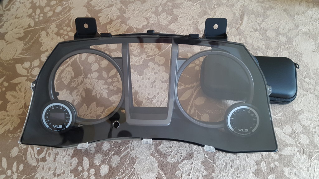

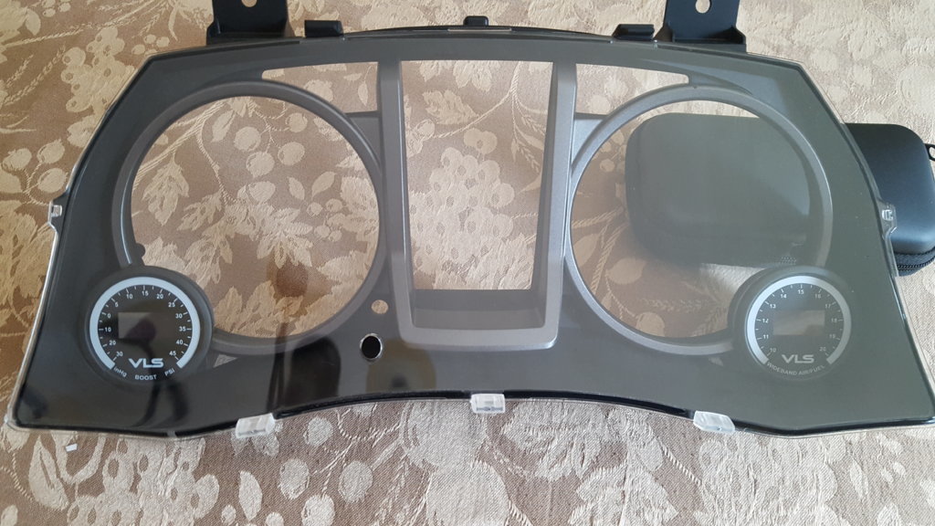

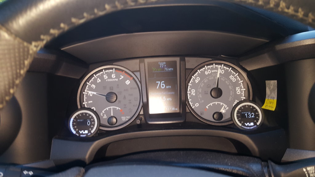

    boost, AFR, Trans Temp; if you like analyzing the info presented, it can indicate trouble that you might otherwise have difficulty noticing, but honestly I have boost and AFR, and am regularly curious, and look at them but believe with a well developed tune and running proper octane, you probably do not need the gauges. Heck, most AFR gauges are only monitoring the right bank too, so only half the story. The right bank is preferred on these, because it runs a bit lean; the injector at the end of the fuel rail piping sees less fuel pressure.
    Adding a boost gauge, is painful, the threaded plug is on the back of the SC, tight against a thick wire bundle, real challenge I believe I used a 90deg elbow fitting, 1/8 pipe by 1/8 barb, straight would never have worked, and i doubt it can be added with the SC bolted in.
    The AFR needs a bung welded into the exhaust, before the cat.
    Then, as you see there is the wiring and mounting the gauges. I voided the warranty on my gauges, and with a dremmel and some hours a the bench, mounted my gauges like this, the gauge's are only about 1/2" thick, if you cut it out of the provided housing.
