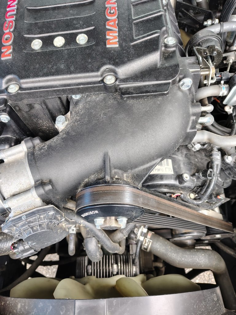

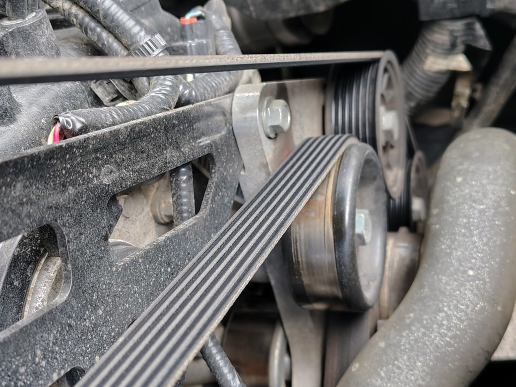

    Has anyone had belt alignment issues post supercharger install? I noticed some discoloration on the belt and scoring on one of the pulleys over the weekend. I plan on taking a more detailed look this weekend and it would be helpful to have an idea on what to look for.

    I've had my maggie on for 35k miles now and my belt looks normal without any fray or coloring. I don't know if your discoloring is good or bad, but at least check for cracks and fray. I recently ordered a new belt and upgraded coupler just because of the miles. Actually, the coupler I ordered because I started hearing a little pinging and it came from the SC and would go away when I hit the skinny pedal. I took a short video and sent it to them (superchargers online) as they were referred by magnuson for parts. They confirmed it was the coupler and asked for the mileage to document how long the original coupler lasted. I haven't changed it yet, but no rush.

    I haven't heard of other people having the same issue to be honest, so it could just be me. I was going to go smaller pulley too, but just decided not to mess with anything right now....but just in case anyone is interested to go 87mm pulley using the stock belt works fine (or if you need a replacement belt).
    57-03-06-087-BL is the pulley
    79-06-08-091 is the stock belt
