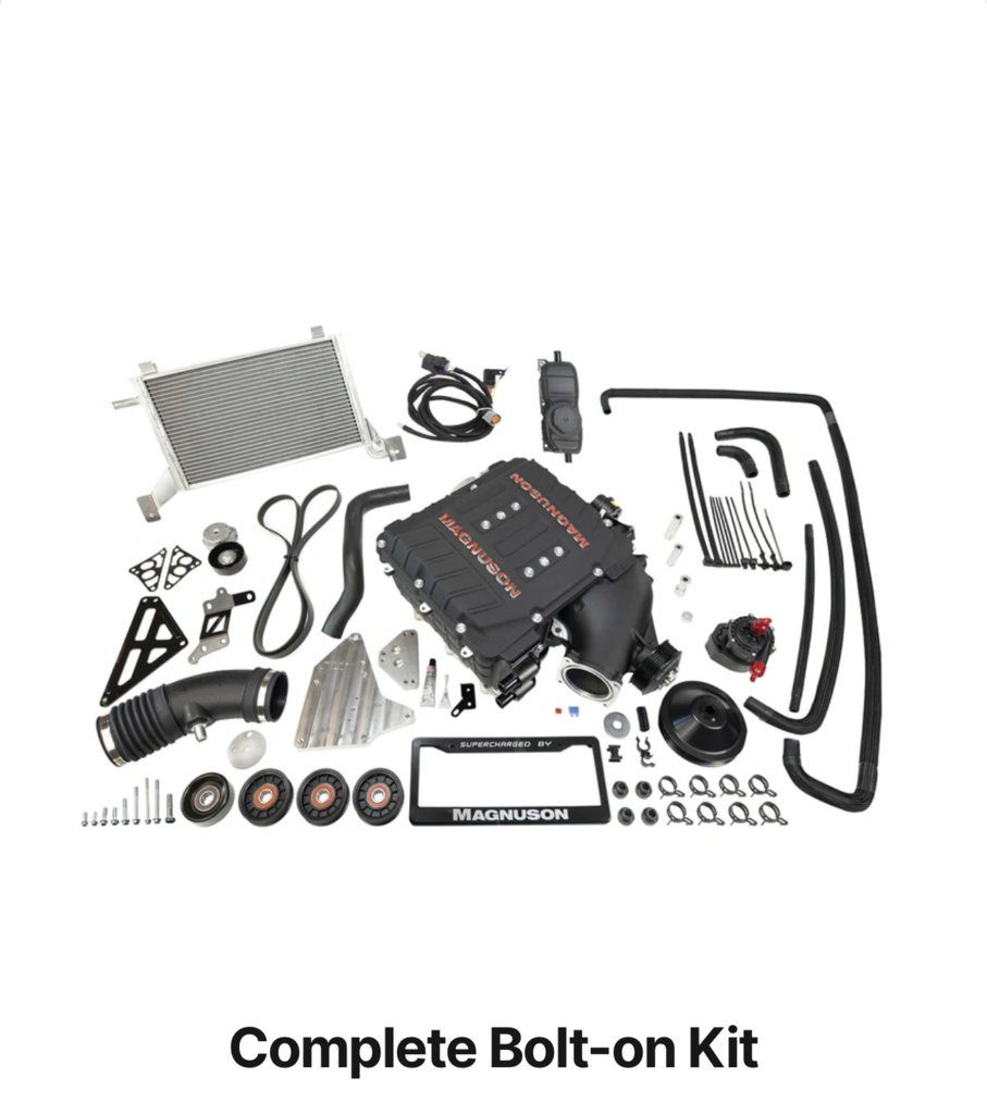

    I thought the Magnusun kit comes with all of this stuff, spark plugs, fittings etc? That was my impression, but I could be wrong.

    From the Mag. Site.

    It comes with all of it, but not plugs. You're supposed to use your old ones if they're still good to go. Most of us just replace them while we're in there.
    Someone mentioned replacing the belt, but it comes with a belt due to the change in length, so no need for buying an OEM belt.
