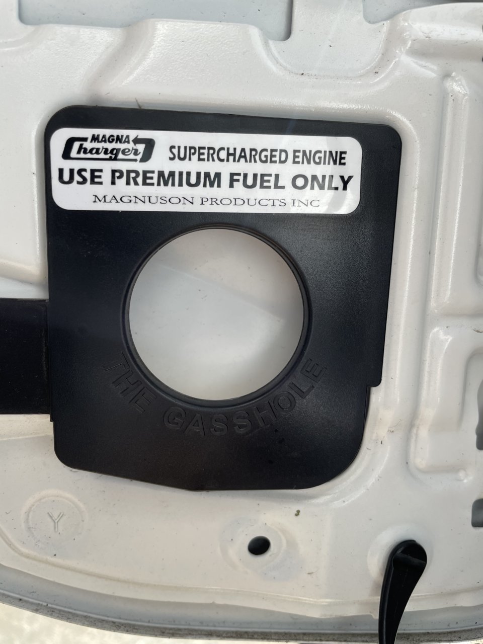

    Does the supercharged taco then require premium fuel? Or can it run well on regular

    I don't have my blower yet but I would assume that 91 is required.

    Better blower response based on pedal input. The truck will become more sensitive to activating boost with less pedal effort required to do so.
    With the jet installed boost gradually kicks and the truck will want to stay in vacuum more.
    91 or better octane is MANDATORY.

    Got it, that's gonna me a no from me then. 91 requirement on a truck is a bit much.

    It's only like $3-4 more per tank. Is giving up the price of a coffee at Starbucks a week really going to make you stray away from getting a blower?

    Willing to pay 7k for a supercharger, can’t pay for premium fuel lol

    You even get a sticker!
