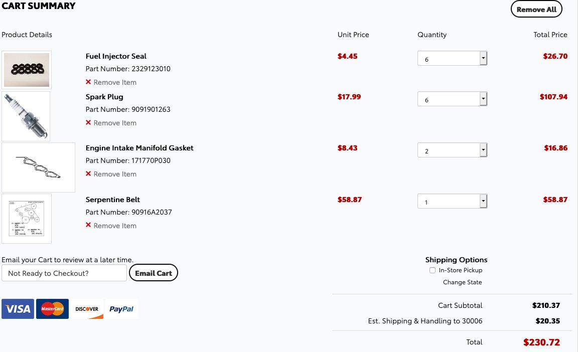

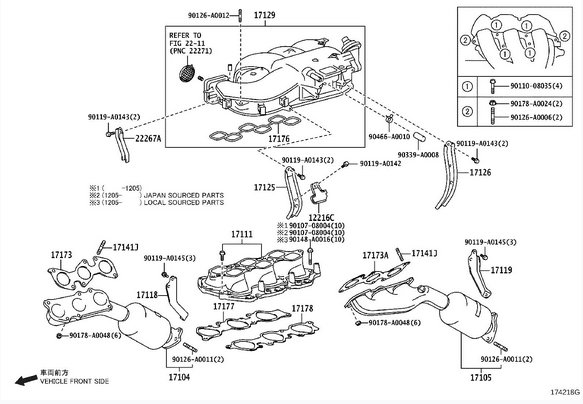

    So I am putting together my order and I already have fluids, and tools but I want confirm a few things:
    On our manifold we re-use gaskets labeled "17177 & 17178"? but 17176 isn't reused?
    this is what my cart looks like so far:

    You shouldn't need a belt, the charger comes with a new one according to the install manual and packing list. I can't say 100% certainty since I haven't received mine yet.

    down load the installation instructions from the Magnuson site for the Gen3 SC - it has the part numbers for the gaskets and seals. You do not use the gasket on the bottom side of the upper manifold (it stays on the manifold when removed and is not reused) -you need two of the lower manifold gaskets - they are the 17177 and 17178 numbers (same gasket but one is flipped over and opposite direction for install). Plug number is correct. NO you do not receive the oem serpentine belt the one you receive is for the SC. So yes the number you have on the list is correct for replacement of the OEM belt. Again - download the install instructions from the Magnuson page for the Gen3 SC - it will give you a head start on parts you have listed and an idea on sequence. There are few errors on the install instructions and an easier way for the lower manifold/fuel rail removal/install. I made a post about the errors and sequence changes earlier - Look on this thread post #412. And FWIW - you can get these items from you local Toyota Dealer's on-line parts department for a lot less than the site you have identified on your post - my plugs were like $12 each and the belt was less than $40.00.
