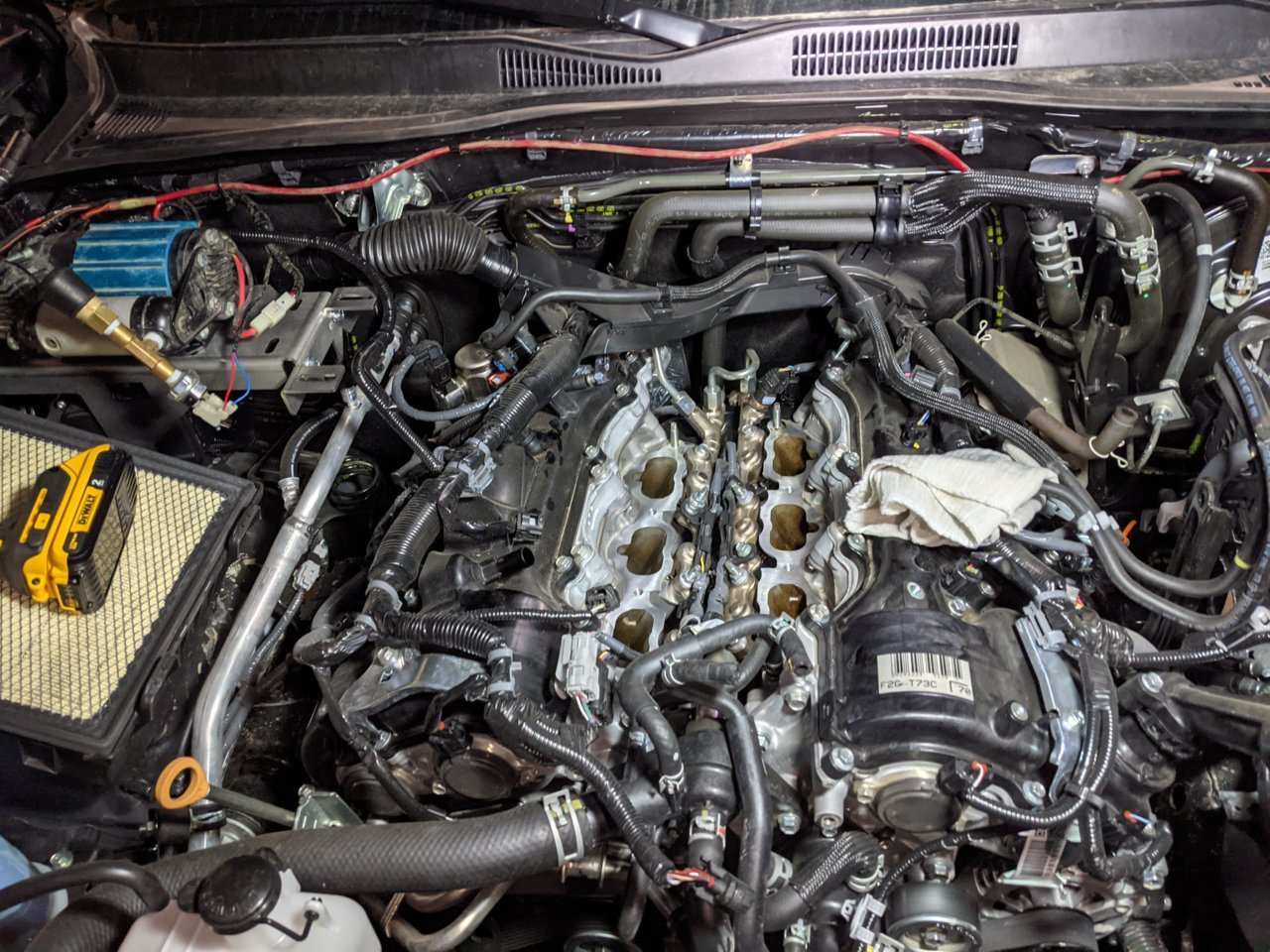

    Started working after getting home from work around 630pm and stopped about 9pm. Yes, I taped over the ports after the picture. So far the instructions are pretty clear and obvious.

    It's amazing how complex an ICE is today vs. 1970.
    skyking3 likes this.

    #512
    crazysccrmd
    crazysccrmd Well-Known Member
    Mar 17, 2016
    #181592
    9,239
    Alaska
    Aprilia Tuareg 660
    Very. The last engine I tore down this far was a 1990 Range Rover 3.9l which is basically a '70s Buick v8. Pulling the heads off that was less complicated than just removing the grill of the Tacoma.

    9,239
    Alaska
    Aprilia Tuareg 660
    This crankshaft bolt can go fuck itself. Everything was going smoothly until this step and the fucker won't break free even with an impact.

  16. May 1, 2021 at 12:07 PM
    #516
    Skydvrr
    Skydvrr IG: @kalopsianick
    Sep 13, 2017
    #229889
    12,653
    Nick
    YMH
    Black '17 OR
    See if anyone auto store local to you has an impact socket? Something with more mass / strength to transfer the torque of the gun to the socket more better.

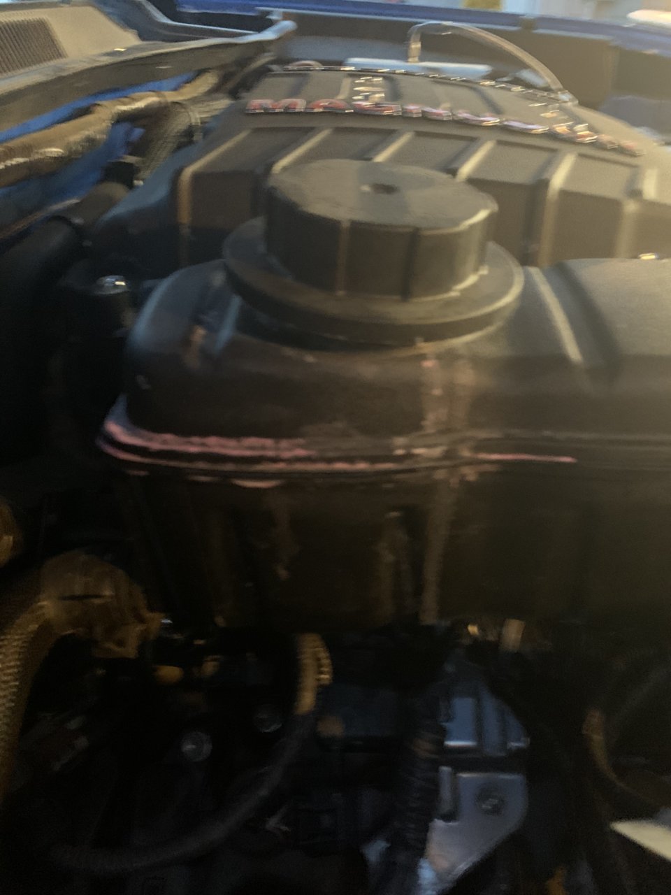

  17. May 1, 2021 at 12:26 PM
    #517
    Sleipnir
    Sleipnir Still havent found that stupid snipe
    Apr 28, 2016
    #185554
    10,495
    I'm a horse
    Asgard
    Furd Rangero Ecoboost
    This is pretty sweet. Does Magnuson or any aftermarket make a different cover for it? I'd love to see two separate covers for the cac and the blower. Unless the cac needs to be setup that way for the blower
  18. May 1, 2021 at 2:40 PM
    #518
    GoldenBrew
    GoldenBrew Insufficient Privilege
    Dec 18, 2016
    #205159
    2,758
    Golden, Colorado
    Gen3 4X4 TRD OR AT - SOLD not Forgotten
    Mine would not come out with the air impact - took about 5 seconds with a 18V M18 Milwaukee electric. Air ain't worth shit. electric made a believer out of me.
    sorevilo and Shellshock like this.
  19. May 1, 2021 at 2:42 PM
    #519
    GoldenBrew
    Dec 18, 2016
    #205159
    2,758
    Golden, Colorado
    made that way to make cac work with blower.
    Sleipnir[QUOTED] likes this.
